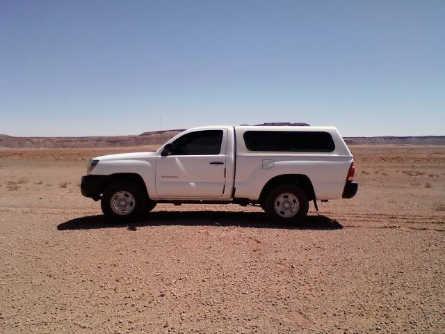

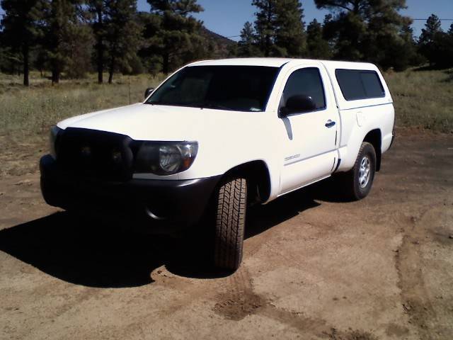

    Readylift installed w/ 30x9.5 Yokohomas on stock wheels. Will be getting different wheels in a few weeks.
