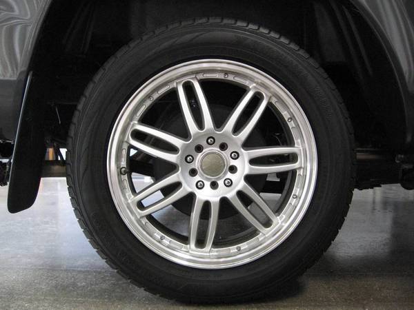

    Looking to put larger tires on a 2009 Regular Cab 5-Lug w/ the stock 215/70/15 tires.
    As far as sizes go, trying to decide between 30x9.5 or 235/75/15 to go on the stock wheels.
    Would the 30x9.5 fit without rubbing? For that matter, would they look ridiculous on a non-lifted 5-lug? Would it make more sense to go with the 235/75/15s for cost ($10 less a tire)? Anyone have pictures of similar setups? All recommendations are welcome.

    I've got 30x9.5's. They rubbed until I removed the small black boxes that are mounted on the rear of the front wheel wells. Here's a pic from my gallery.

    Go with bigger rims too..... I have 18 inch rims with 235/55/R18 Tires, NO rubbing what so ever and the speedometer is correct.

    x2! A good size tire to do. From my research, this is biggest tire you can do with no rubbing, without a lift. You need to do a little trimming to expose the black box. They are held in place by 3 bolts. An easy way to make room for tire size you want 30x9.5R15.

    I'm also running 235/55/18, haven't notice much difference in mpg, but unlike him my speedometer is off by 4-5 miles. Last time I calculated mpg I got 16 mpg city driving only, lots of heavy traffic and the truck was under 1000 miles. These tires are only about 1.5 inch in diameter more than stock 215/70/15.
