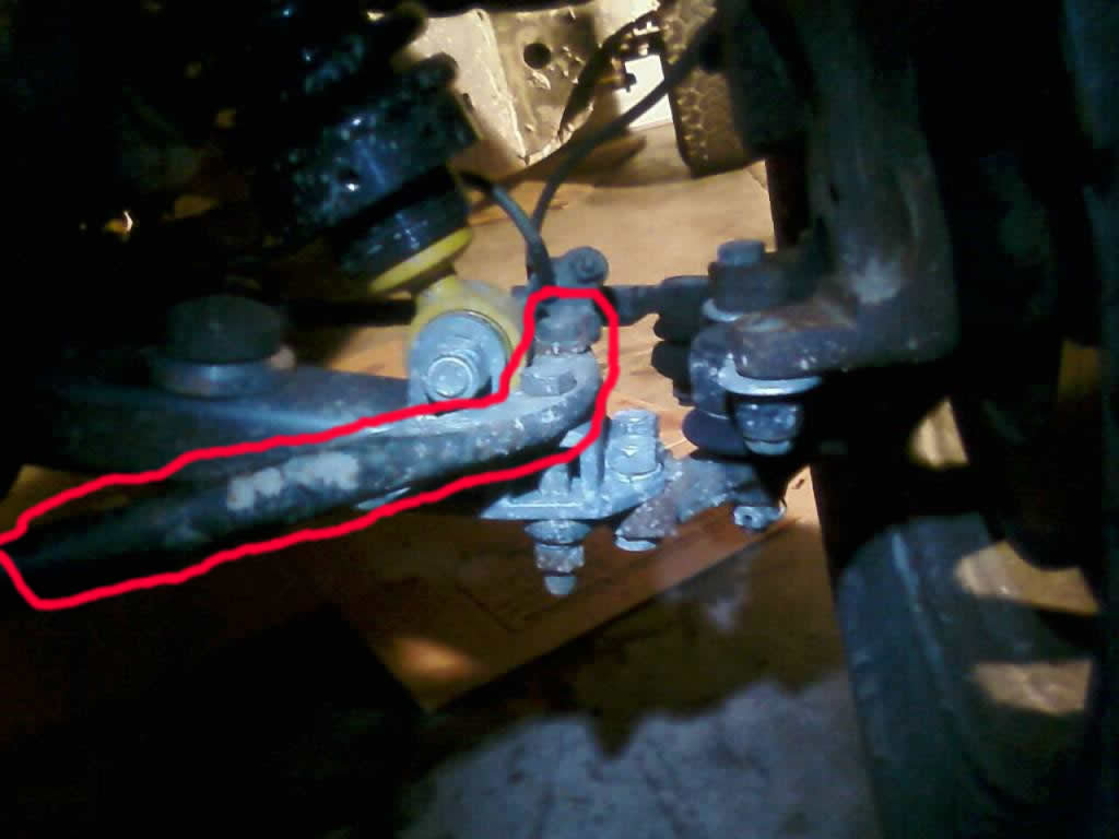

    yeah man your ball joint is mounted wrong ill upload a pic of mine in a bit

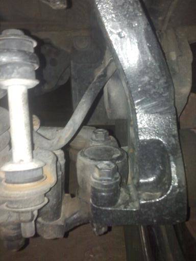

    see how mine is above the spindle? and yours is under

    My lord, i can't believe i've been wheeling (and wheeled it quite fucking hard) with my Bj's on bass-akwards. And it looks like my current angles put even more stress on the brackets than the stock set-up.
    I feel so embarased, although i got my truck with the suspension as is and this is my first yota SO...the learning begins.
    Changing it tonight, thanks for the heads up. Hopefully this will lift me up a little and i can bring my upper control arm back in towards the bucket. I thought the fact that i needed a 3/4" spacer back there was a little odd to get the camber right.

    good to know, how much does it lower it? I'd imagine an inch tops...
    So i was just reading up on ball joint flip and it seems my ball joint is on the factory side of the controll arm but the opposite side of the spindle. It also apreers that the thrust arm on my truck is bolted to the top of the controll arm whereas the factory places it below the controll arm. Shoul i move the thrust arms to below the controll arm after i place my ball joint above the spindle mounts?
    Heres a ball joint flip thread... Definately not whats going on with my truck. Fuck me my shits all backwards built.
    http://www.toyotaminis.com/forum/suspension-chassis-40/how-do-ball-joint-flip-sd-yota-5272/

    your strut rod is correct on top of the arm. that thread you posted was for a toyota pickup and they might do that since they lower it it changes the angle of the strut rod and maybe the bushing wears funky?

    heres mine. :D
