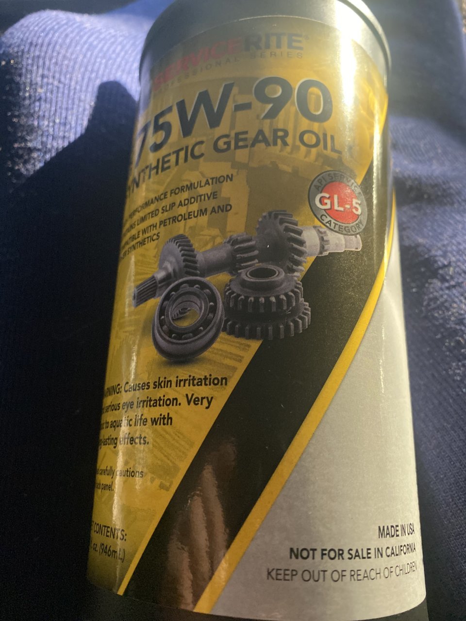

    Hey so I’ve read up on this but went to Toyota and all they sell is a service rite brand 75w-90 synthetic API gl-5 part # 000036-00003 anyone ever use this ? Parts department said this is all they use other than a 140w, so if they don’t sell a gl-4 is this a good quality /option ? Says it meets/exceeds gl4/gl5 performance

    I haven’t driven but about 200 miles and nothing has exploded ! I’m a little more conscious of the shifting now and I may not have remembered that when downshifting to first it was always a bit tight….. but other than that it’s fine. Now that I’m a bit more aware I’ll remember the difference in the next swap. In the meantime I ordered the redline T-90 from Amazon with plans to swap it soon, when I did the trans I also swapped the rear diff with Mobil 1 synthetic 75-90 it looked a bit dark to my surprise because I could see the bolt had been turned before. Truck has 163k in it I just picked it up back in September not my daily driver just my weekend truck for camping and biking and goofing off. I stumbled onto the service records from Toyota using the app and it had been serviced there from 07- 18 ? But didn’t remember seeing a drivetrain fluid service.
    Still need to do front diff and transfer the front diff 10mm was a doozy on my 97 the drain and refill hope this one goes better
