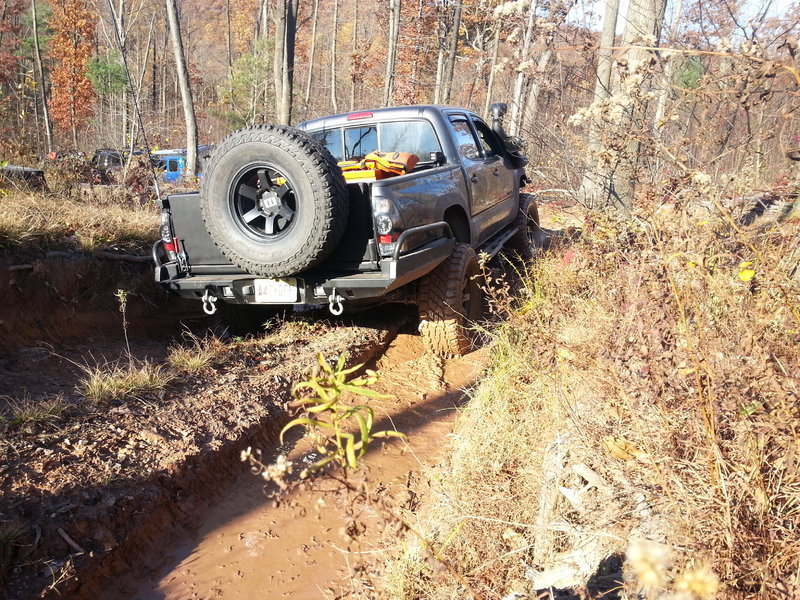

    I'm a big proponent Hanging it off the back and rotating it in. Never have a problem with the winch seizing up this way :D
