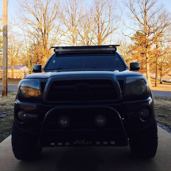

    will these work with the Yakima roof rack I already have installed I'm afraid I'll have to choose one over the other, in all the pics I've seen

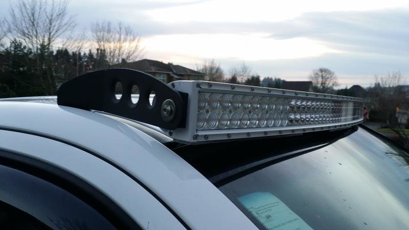

    since you have a double im sure it can be done. they fit about 8 inches in to the first hole of the window and 10 3/16" from the window on the back hole. this is taking reference from a access cab that needed to drill. Not sure on dc

    the relentless fabrication mounts worked perfectly. Think it turned out great, now just have to wait for dark :)

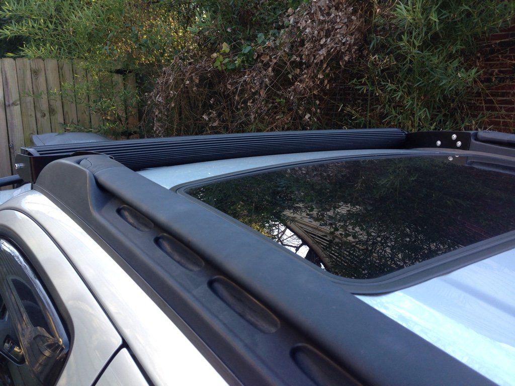

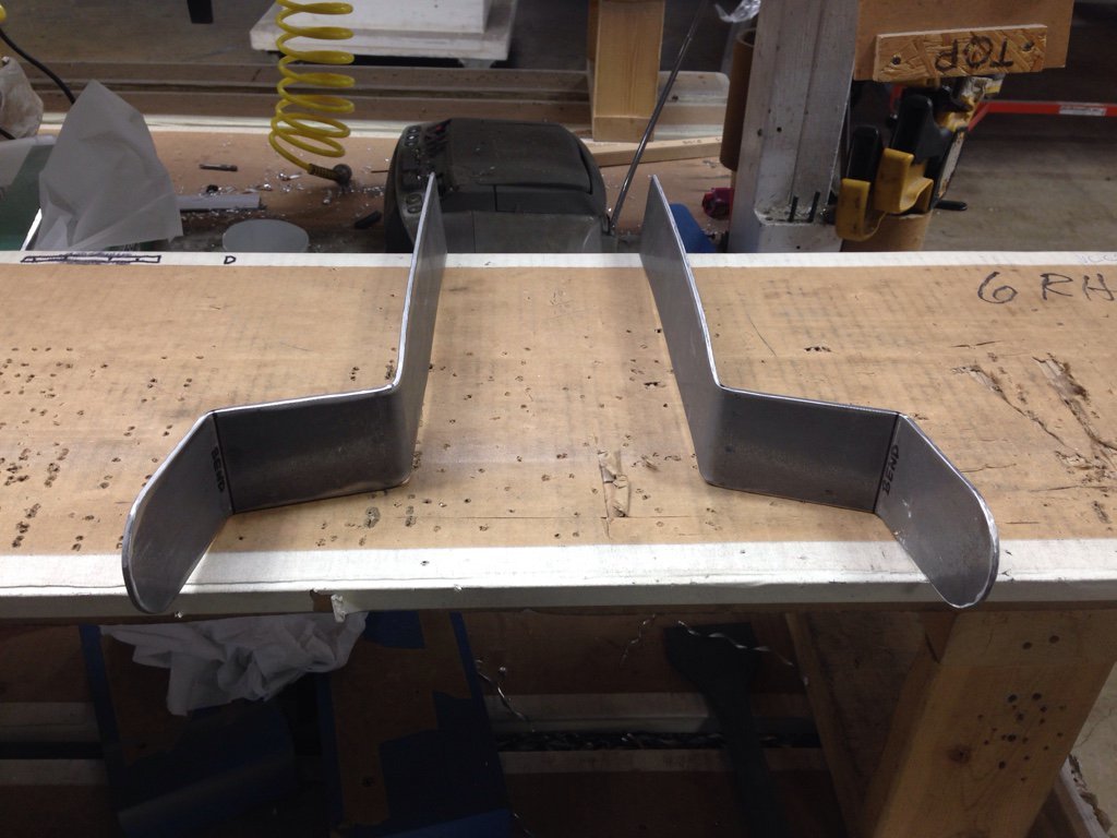

    You will have to notch the rack assemblies to fit over the mounts, or build your own mounts that attach to the racks like I did.

    To be honest if I had a OEM rack and wanted and LED bar I would go 40 inch. There was a guy in the BST section making 40 bar mounts the you mount to the insides of the roof rack.

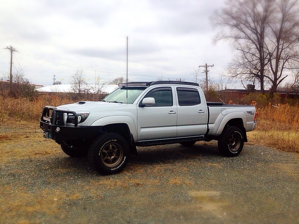

    I have a thule rack and trac performace mounts.
    looks good
    I was going to say you should pm andy :cool:

    Yea I thought about producing some sets, but I don't have the time or tools to do it efficiently. I cut those out with an angle grinder and bent them on a brake press at work.
