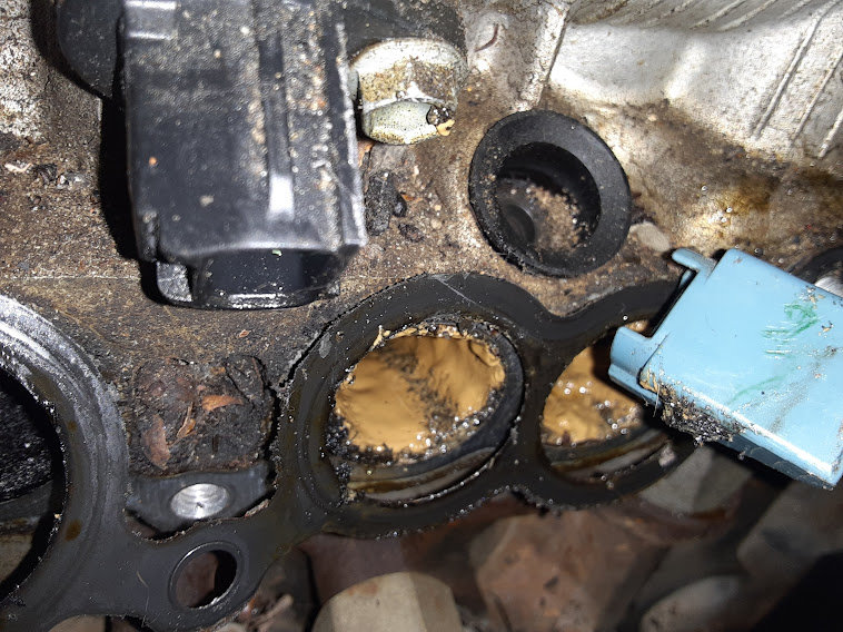

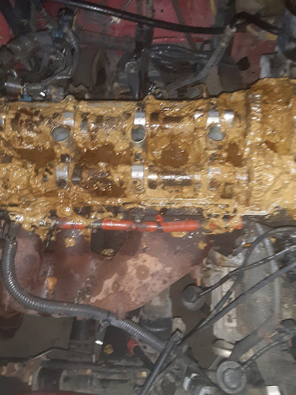

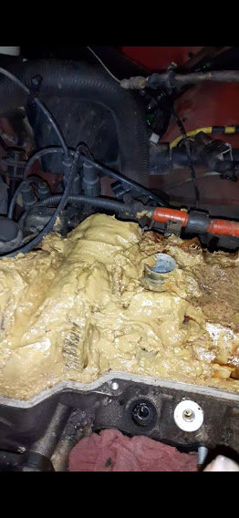

    After removing the valve cover and intake manifold, this is what me and my friends found...
    And this is after we sprayed all the parts cleaner we had onto it. Probably not a smart idea but we were trying to at least make it into a liquid and not let it sit as a jello-like substance.
    Now. With that said, I've talked to everyone and asked the big question, should I pull the block and get it tested? General consensus says - Ehhh... Up to you. So now I'm confused on what to do next.
    Side question. IF I pulled the block and it's bad, would I be able to stick a 3rz block and a 2rz head together? From what information I can gather they're the same motor but with small differences like the coil packs and displacement. Other than that? They're the same. Probably thinking several steps a head of where I'm at but I'd rather have a backup plan incase I need it.

    Wow. Probably pull the engine and transmission. Look for a junkyard pair for under $3k?

    Fresno County
    4 run, 2 don't
    Motors come up here locally for about $200-400 from parted vehicles
    Just find a used one locally and toss it in; I would not rebuild that turd

    Honestly i wouldn't waste anymore time on that motor. it basically got ran without oil..
