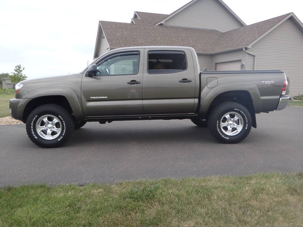

    In case anybody is looking to do this setup here are before and after pics
    It took me a while to decide and it can get expensive, but this is what I went with and I'm am very happy with the look and ride.
    Thanks for everybody's input on this board
    5100 @ 1.75 with 1.5 Wheelers progressive AAL - overload in
    BEFORE:
    AFTER:

    Looks Good :thumbsup:. How many leafs did your original pack contain, was it 3 or 4 leaf. I am assuming 3, if so you would have a total of 6 leaf now?

    I had the TSB done so it had 3 plus overload, now it has the 1.5 3 leaf progressive. So 7 including the overload

    The rims are 16x8 Ivan Stewart and the tires are BFG 265/75/16

    Ive been considering different options to raise my rear. I have the 4 leaf pack and most likely will go the same route. What rear shocks are you using?

    I have the 5100's in the back - just the normal ones not extended - Wheelers Offroad said they would be plenty long enough

    I have 5100's in the front and back I would put them in the back if you are going to have them in the front. It will be a nicer ride to have them on all 4 corners, but that is just what I think.
    I am no expert by any means and I asked a lot of questions before I lifted my truck. The 1.5 wheelers progressive aal rides real nice.
