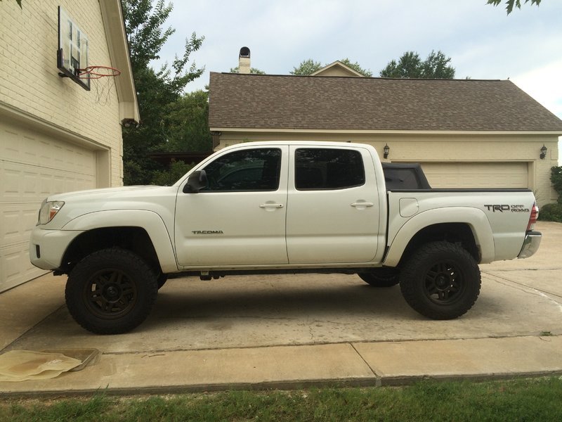

    So I got my 885 coils on the other day with 5100's along with Fox 2.0s and Ironman leaf springs in the rear. However, apparently I didn't specify that I wanted the coils set at the lowest possible setting on the Bilstein and they set it at the highest setting. Now my CVs are offed and my stock UCAs can't handle it. Also they won't fix it for free. Awesome! I have tons of bro lean and a 5 inch lift up front

    Holy crap! So you ordered the 5100's and the 885's and the shop that installed them put the 5100's on the highest setting? That's why it pays just to get the shocks and coils pre-assembled before shipping so that it makes it easy for just about anyone to bolt on. I don't know if you ordered from somewhere that offers assembly but that way you would know they were put together properly. This made it very easy to bolt on in my driveway after watching a few installation videos. It sucks that you can't always expect a professional with more experience than you to do something correctly, and thats bullshit that they won't fix it for free. Good luck, I hope you can get it fixed and enjoy the great ride that it offers!

    I just got a call and when they were "fixing it" they also just broke one of my front bilstein shocks and they want to know if Toytec will warranty it

    Here's a pic of the highest setting

    I read your other thread about the broke shock. Sorry you're having such bad luck! I recommend giving Marie a call at Headstrong OffRoad to get your replacement. Best prices and great customer service! Good luck bud!
