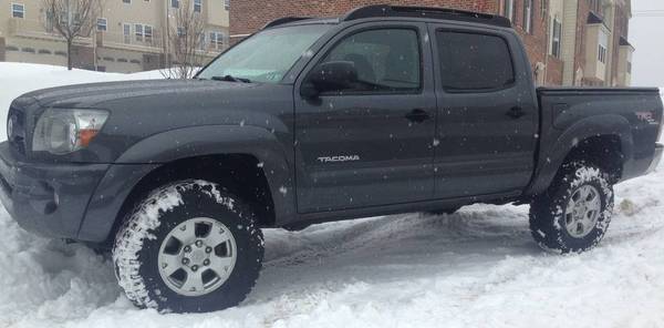

    fourpointTRD
    fourpointTRD Well-Known Member
    Mar 22, 2014
    #125886
    152
    Humboldt, CA
    14 DCSB TRD OR 4WD
    Bilstein 5100s x4, OME 883 with 1/4 inch spacer on driver's side, OME TP04 leaf spring trim packer, Wheeler's Superbumps rear, black FJ Trail team wheels, Gorilla Wheel Locks (73631T), Huskyliners xact contour, Rockymounts Clutch SD and Driveshaft, Toyota OEM Bedmat, Plasti-dipped badges and front emblem
    Was wondering the same thing.

    Beaureguardbull
    Beaureguardbull [OP] Well-Known Member
    Dec 13, 2012
    #93025
    351
    John
    SW Louisiana
    13 DCSB SR5
    Color Matched Grille, Tint, Clazzio Seat Covers, Husky Liners
    Any vibrations? Looks good! Also, how do the 884s and the 5100s ride? Close to stock?
