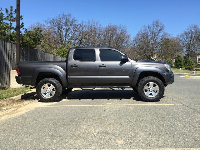

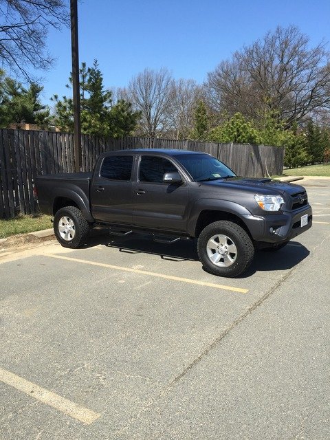

    And just because I like posting pictures of my truck, I have the exact same lift as Burghlar and gym_jamz and love it

    Looks good! Are those 265/70/17s on there?
  5. Apr 17, 2015 at 6:32 AM
    #25
    chas44
    chas44 Well-Known Member
    Aug 10, 2013
    #110192
    138
    Virginia
    2012 TRD Sport
    Indeed they are
