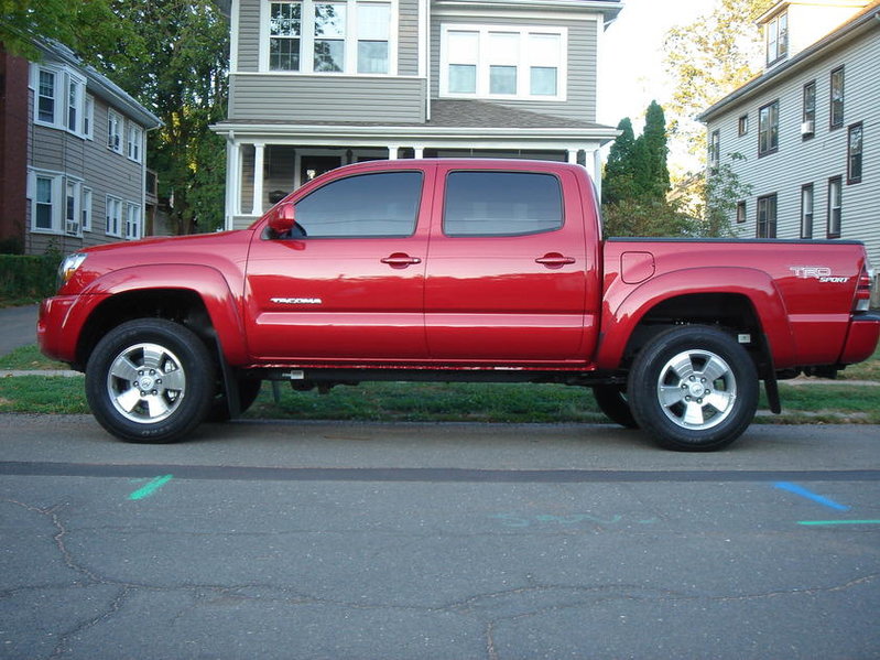

    I just did the exact same set up minus the spacers. To echo what's already been said, the Billie's set to 1.75" w/ the rear TSB gives you a level stance. I will add the rear Billie's when I upgrade my wheel package and set the fronts then to 2.5"...here is a pic, hope it helps.

    The rears aren't adjustable right? So if you get new ones in back and set the front to 2.5" it'll be nose high.

    Can you post a recent pic showing a side view of your truck, so that I can get a look. I want to get the 5100's and was hoping not to have to do anything else to the rear, aside from the TSB AAL that has already been done. Thanks!

    Yeah, I'll get that pic for you tomorrow...it's dark outside already..sorry.
