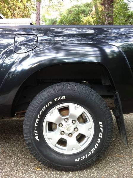

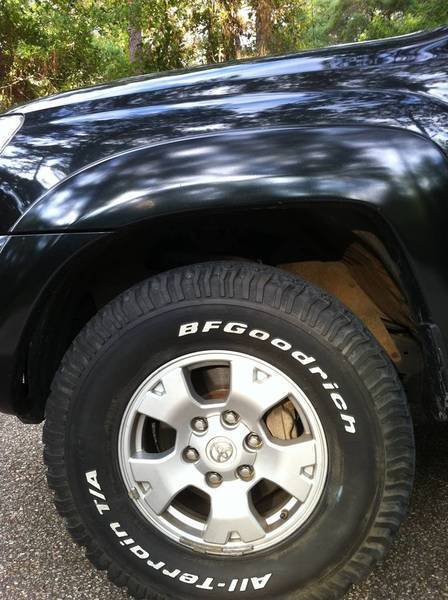

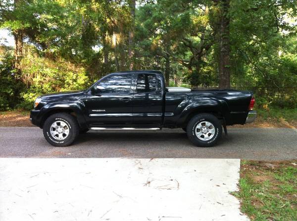

    This is how she sits today with about 135,000 miles. the back is about 2 inches higher than the front so.. Im thinking the 1.5 AAL will do fine. what do you think?
