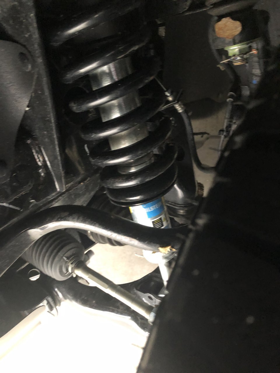

    I just did this same setup on my 2018 dclb on Wednesday and I am very happy with the ride. Still rides very nice. I found used OME 884 coils and then went with the 5100s set at 0. Ended up right about an inch to 1.25 inch lift. I also didn’t want to touch the rear end and didn’t. No issues with tss and took it off-road today and it rode as well as stock if not better.
    Does somewhat minimize brake dive.

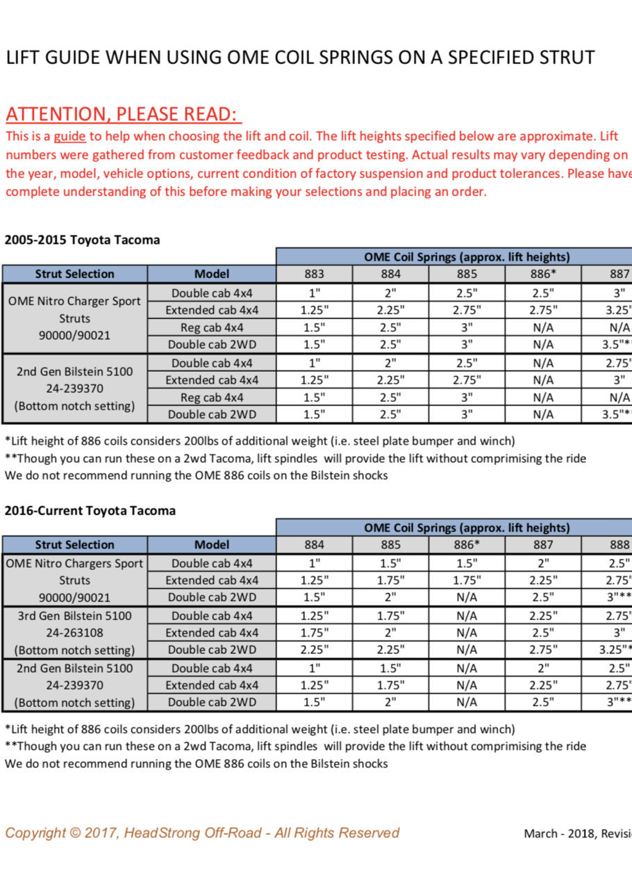

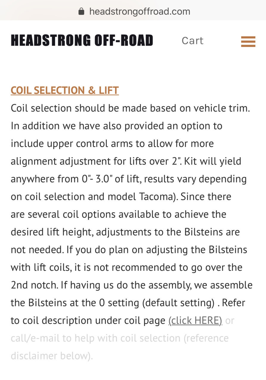

    If you want to be level you could put the 5100s on the second notch. Most will say not to preload ome coils but I will send a screen shot from headatrongs website that says not to go over second notch. If you want it dead level or close to, if you never tow, I’d say go on the second notch. That would give the inch plus the .65 inch from the second notch for a total of 1.65-1.9 or so. I’ll use this truck to tow my side by side occasionally so may leave it with the 5100s set at 0. I can take more pics if you need them.
    Install was pretty straightforward if you have a jack, wrenches and necessary sized ratchet sets. Up to 22mm on both. Only took about 2.5 hours by myself and this was my first attempt tackling any sort of suspension other than rear airbags.

    And to be honest, you could skip the 884s altogether and run the bilsteins on the stock coils on the second notch which would firm up the ride a bit. I found the used coils for $80 so figured why not. I am new to Tacoma’s but that’s what I found in my research.
    Also added the lift guide from headstrong which you’ve probably already seen, but in case you haven’t, here it is. I went with third gen bils and the 884s.

    Thanks for the feedback. The Headstrong guide is a great resource, and what I based a lot of this off of. Would you mind elaborating a bit on how you feel the ride quality changed, or didn't change on road?

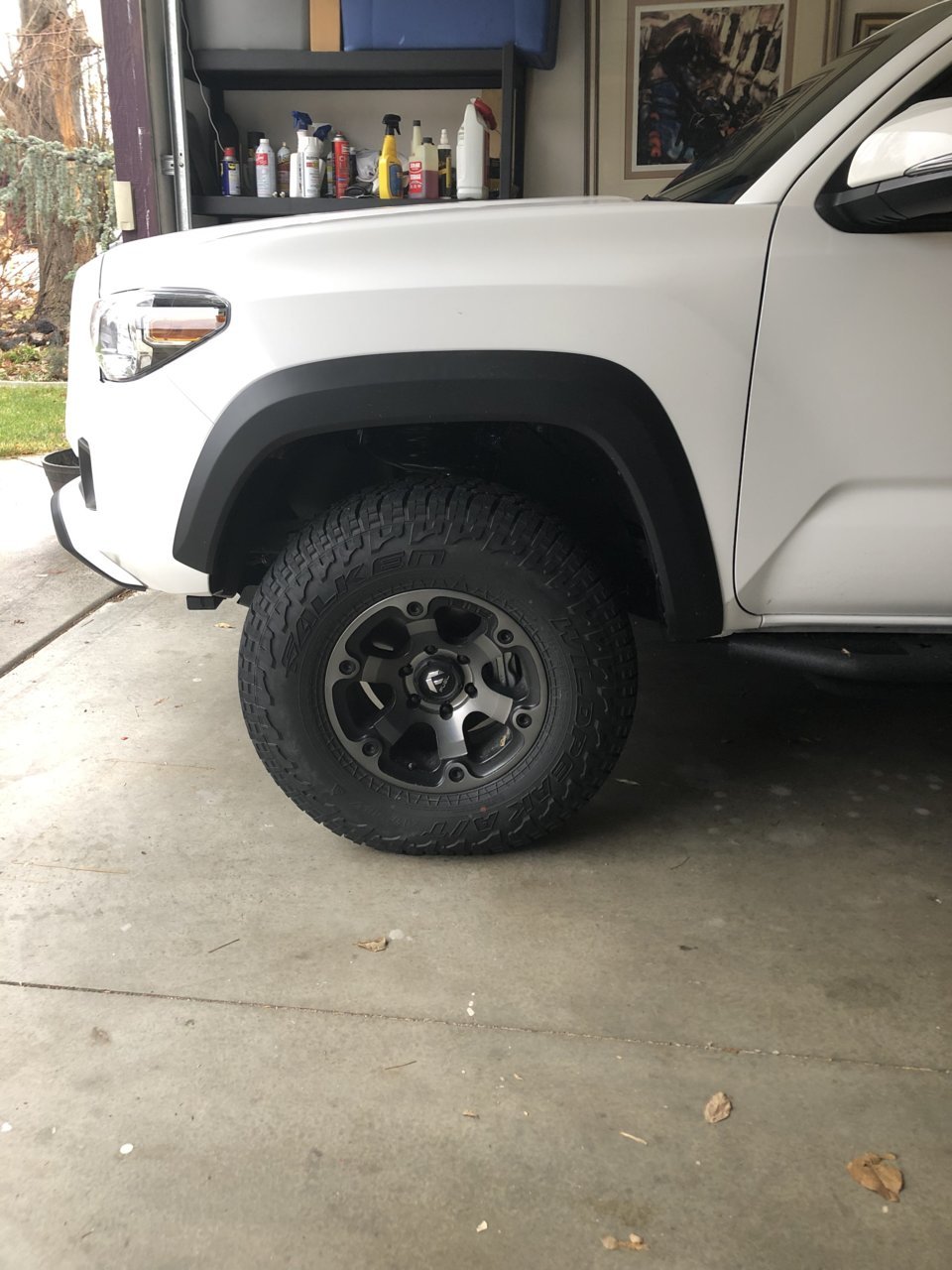

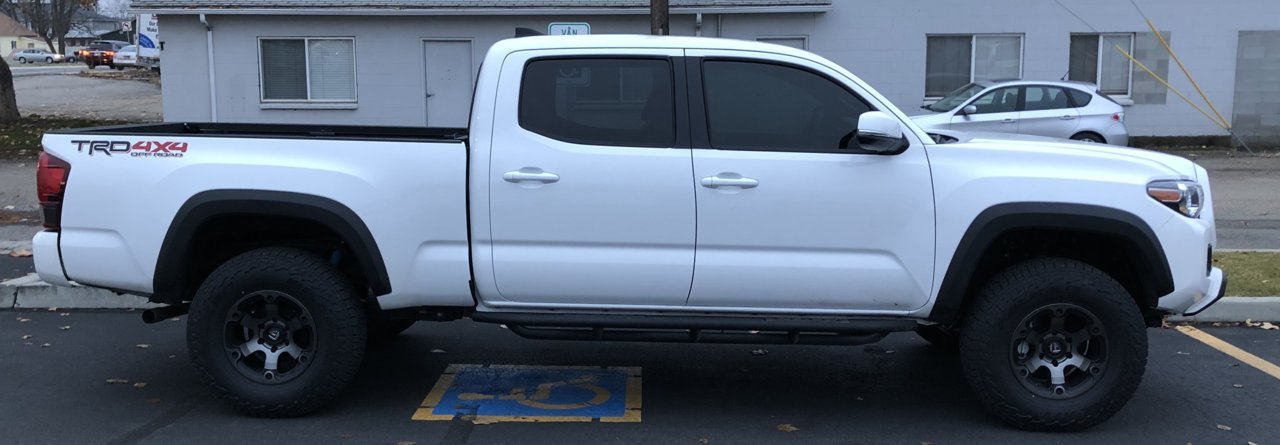

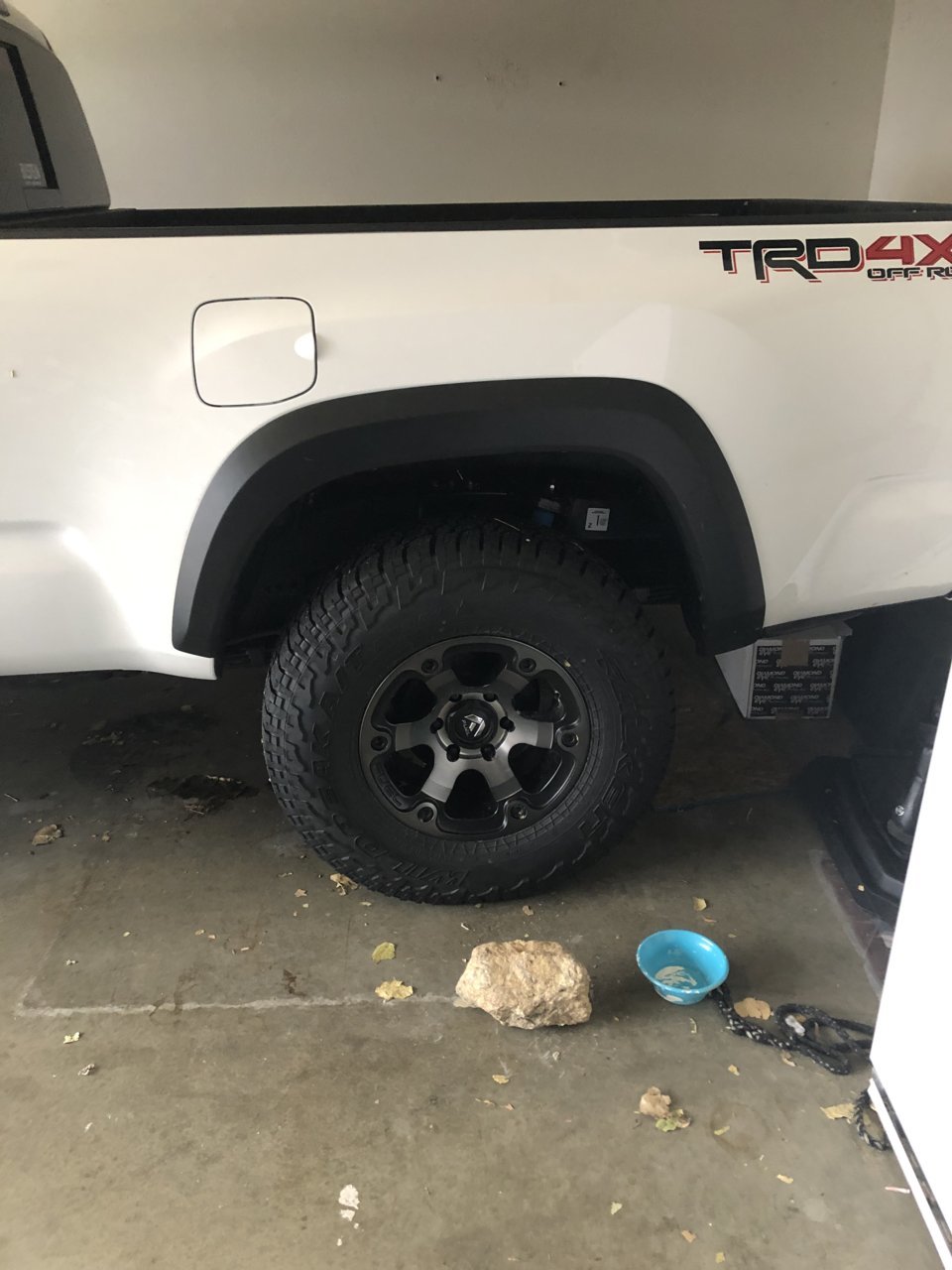

    Couple quick pics I snapped in the garage. Raining pretty decent here today.
    Trying to show wheel gap between front and back.

    /\ looks pretty perfect to me. I can't make it out from the pics, but are up you one tire size from stock?
  10. Dec 2, 2018 at 12:51 AM
    jerryb1984
    jerryb1984 Well-Known Member
    Oct 6, 2018
    #268494
    459
    Jerry
    2018 DCLB TRD OFF ROAD
    16x8 FUEL BEAST 265 75 16 FALKEN WILDPEAK AT3 Tyger step sides 20% tint front to match factory tint bilstein 5100s on third notch PRO grill
    Yes. 265/75/16
