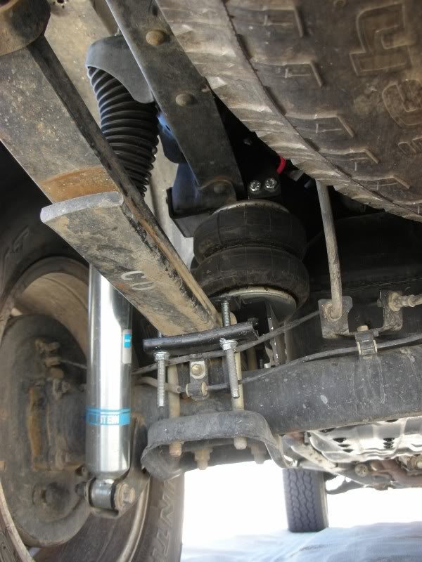

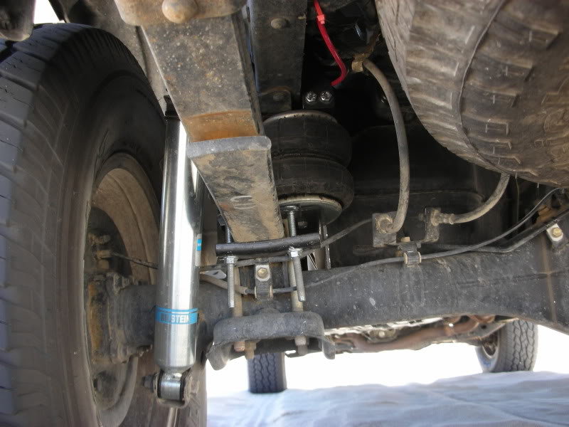

    Differential Breather Mod Light Bar: 4 Cree LED lamps Bilstein 5100s Ride Rite Air Bags
    The rear 5100's are great... better than the original yellows... and inexpensive!
    Here is a photo of my previous Tacoma ('05) after I installed Ride Rite air bags because of the soft rear suspension (didn't know about the TSB) and 5100s...
