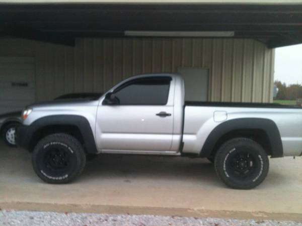

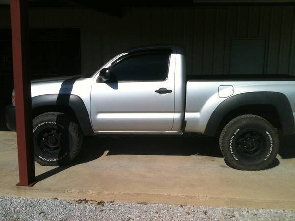

    I fitted the front 5100's on last night at 1.75" and got right at 2" of lift in the front. I am sitting 1/2" high in the front. I am putting the 1.5" AAL on tomorrow night so I should have about the factory rake.
    Before
    After
    I will post pics when the AAL is in. Let me know what you think

    Wow that is insanely level lol. Should look good with the AAL. What size are your tires?
