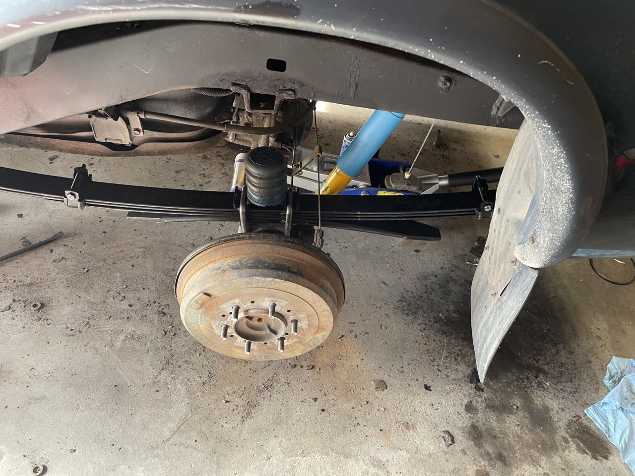

    Ended up putting air bags on to test it out, definitely rides rough when I touch both tires into a dip in the road but great when it's uneven (12psi). About 300lbs in the back with the camping setup. The cradle preloaded it so I may remove for better travel on the shocks and see if it rides a little softer over the dips. My lower back is feeling it. Not sure if new leaf springs will help at this point, as the air bags will always keep the frame and axle connected, but curious on others thoughts. Trying to soften the ride ultimately
