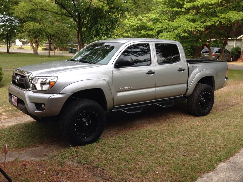

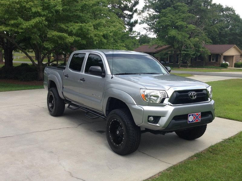

    5100s at 0. OME 885, 1/4 lean spacer on drivers. Wheelers 3 leaf AAL. Icon 2.0 rear shocks. TC uca. Rear is about 1/4 higher than front.

    Thanks... No top plate spacers, just 5100s and 885 springs at 0, but I did use the 1/4 spacer on the drivers side for the lean...

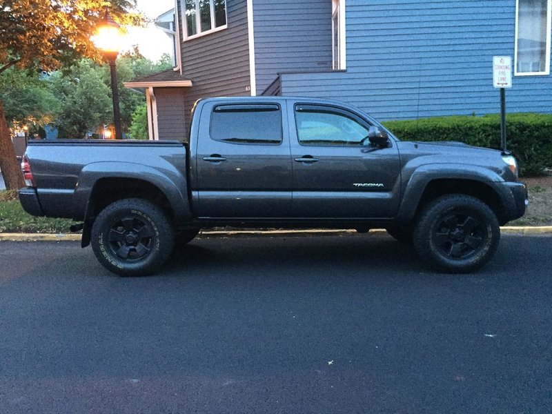

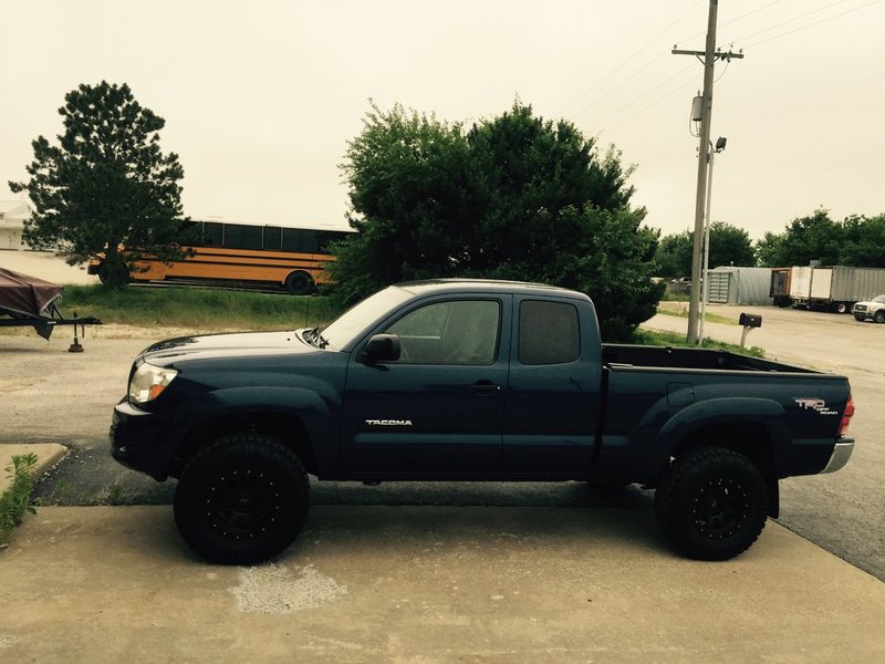

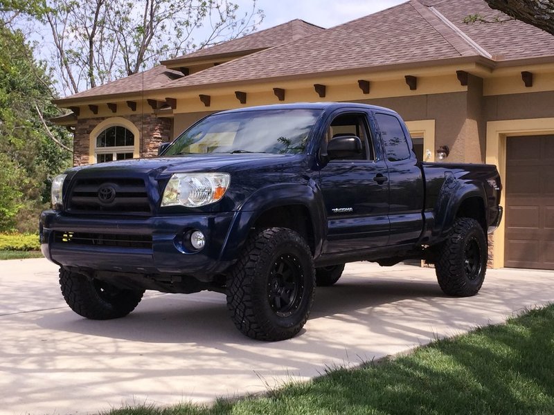

    bought my lift from ToyTec. 112-620 Eibach coils, Bilsteins @ .85, Light Racing UCA's and 2" AAL's in the rear. ended up with just under 3" of lift. no top plate spacers. wish I had!! I like a bit of rake especially if you often carry stuff in the back. the ride is excellent and with the LR UCA's my alignment is perfect. IMG_0447.jpg FullSizeRender1.jpg
