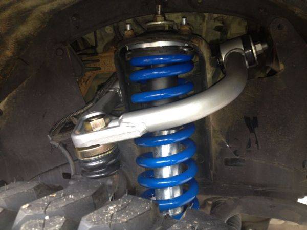

    I have the 5100's set at 0 and the 885's. Smooth ride and gives a 3" lift. 2"AAL in the rear leveled it perfect. I wheel my truck pretty hard and it for sure makes for a great ride with this set up.

    looks good, what UCA are you using?
