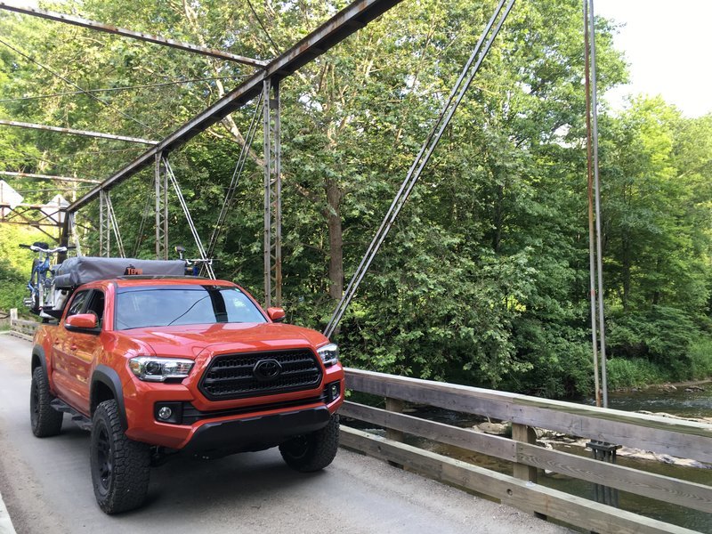

    For anyone curious about running 285s (33s) with the Billies at 1.75" it works well. For reference I have a 1" block in the rear and SumoSprings.
    Fully loaded for camping with the new 285/70r17 KO2s.

    That looks fantastic. Pretty much the combo I want. Anything else done to it, likt a CBC or control arms? Spacers?
  14. Jul 6, 2016 at 7:15 PM
    #274
    Inferno_Taco
    Inferno_Taco Well-Known Member
    Mar 3, 2016
    #180077
    144
    2015 TRD Pro
    Thanks! Proper alignment done after 5100s were bumped up to 1.75" otherwise nothing else. My cam bolts are maxed out to bring the camber back into spec. I couldn't go any heigher without aftermarket UCAs.
    No wheel spacers needed with the TRD wheels as they sit out a bit further than the stock wheels. Plenty of clearance between the Upper Ball Joint and the sidewall.
    We ran a decently tough trail this past weekend with no sway bar up front and I'm only getting a slight rub at full lock in reverse or when the suspension is articulated. No rubbing on the street.

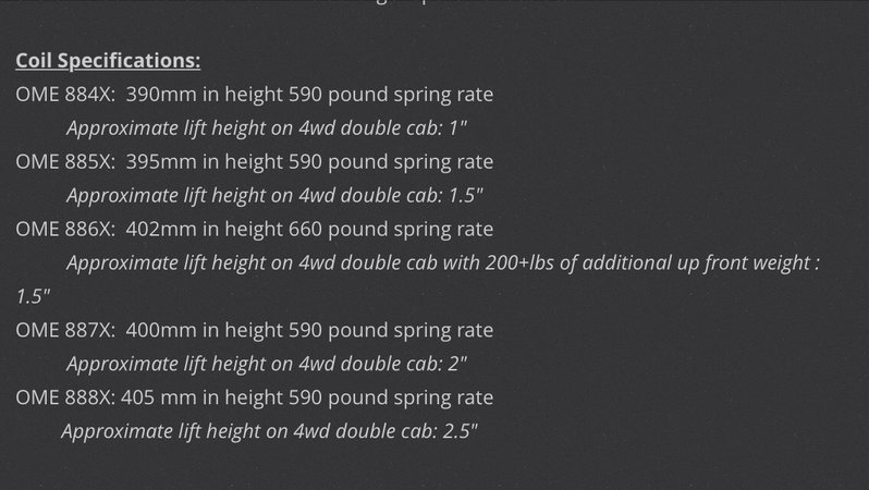

    I'm also trying to figure out how much more I'll need for extra weight. I've got a shell, and am planning on bumpers/winch/etc.
    If I go this route, maybe OME 887 or 888, and a decent AAL? Hoping to get it all done at once later this year.

    This may help you decide which coil to get for your setup. It's from Headstrong's website when you click on the OME coils.image.jpg

    Try the wheelers 5 pack. I had it on my second generation and liked it. Should be 1.5 inch lift or so.
    smitty99[QUOTED] likes this.
  18. Jul 6, 2016 at 9:16 PM
    #278
    nevadabugle
    nevadabugle Desert Rat
    Jul 25, 2014
    #134701
    3,990
    Elko, NV
    2016 DCSB TRDOR manual in quicksand
    Is this their estimated lift for a 2nd or 3rd gen?
