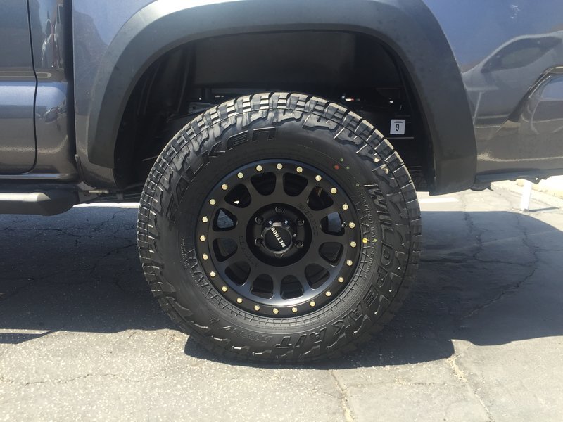

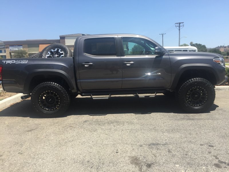

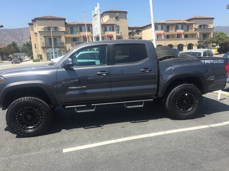

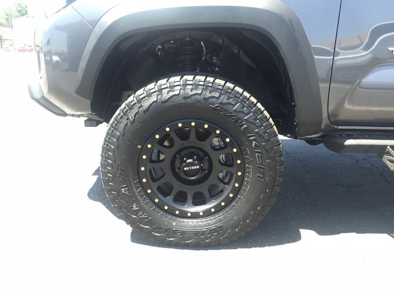

    just got my wheel and tires installed today!
    285/70/17's Wildpeaks on 17' NV's.
    rides nice without any rubbing so far.
    So far this how my ride looks with the 5100s up front at the highest notch, and a 1in block in the rear. its pretty level, if the old wheel and tires weren't in the bed.

    Looks good! How does the 2.5 setting feel? I have mine on the 1.75 and thought about going up. Any vibrations or bad alignment issues?

    im loving it so far, i feel like the ride hasnt worsened, maybe gotten better. But no vibrations, and i just got it aligned today. ill post up if anything changes after some time driving, but I am getting a little rub with the 33's when turning. So i will look to fix that.

    Awesome, Bro! Glad to hear this. Let me know how the alignment goes and if anything changes. Is the 2.5 setting actually 2.5 inches?

    Im not sure exactly how much, ill have to see.
    So i got my truck aligned, and am noticing much more rubbing when turning, i cant tell if it was like that as well before the alignment, but now i definitely got to do some trimming. hmmm

    Hmm, that sucks! If the trimming doesn't fix the rubbing you may have to get spacers. Was the alignment close to specs?

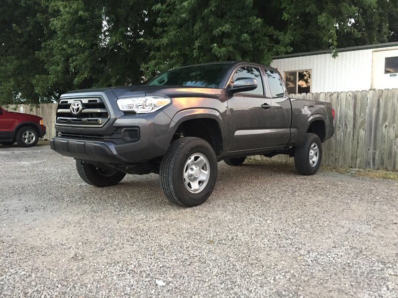

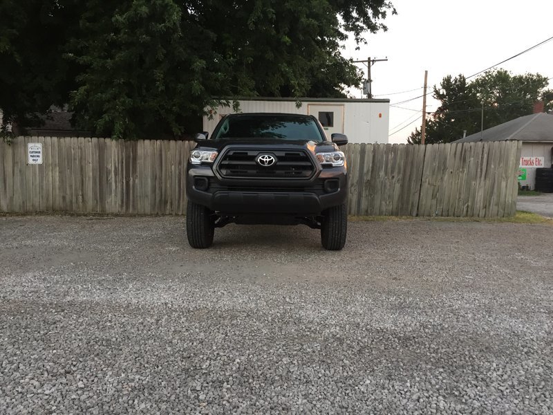

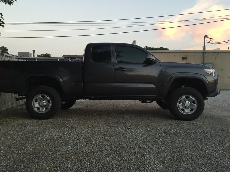

    Finally have some pics: 5100s all 4 corners, OME 887 coils- set at 0, Deaver 1.5 add a leaf in the rear.
    SPC LR UCA
    Truck skips on leg day!!!! 255/85r16 will be mounted on methods as soon as I save up for 4.88 re-gear!

    Looks good. Did you leave your overload on? And hows the ride?

    Yeah the overload is left on. Has slight rake but doesn't look bad. Rides wayyyyy better than stock. No more bounce or wabble. Stiffer handling.
