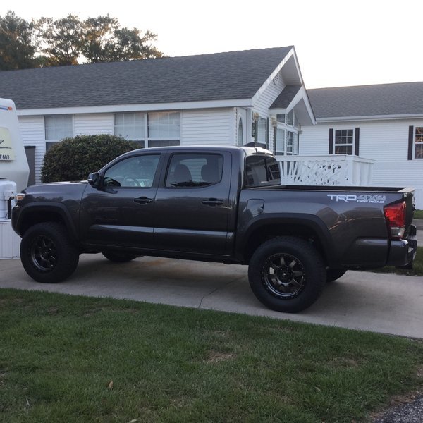

    I'll post better pics later.

    Nice truck there buddy.. that's the same exact setup I have (2016 for me) same wheels color lift everything... I have a M/T and totally LOVE it and I love your rig too... man that looks good. :thumbsup:

    I have the same truck as yours only 2016, did you use the stock (oem) coils up front w/5100's and you are level? The reason I am asking is I purchased OME 885 coils as not to pre-load the shocks but have not installed them yet, I also have 1" block for rear. Looking at your picture you look level, how much left did u get at 1.75 setting? I will be staying with oem wheels with either 265 or 285/75/16.

    My coils are stock. My truck is level with about 1.5 inch lift. I don't know how the OME coils will ride. Mine rides great.

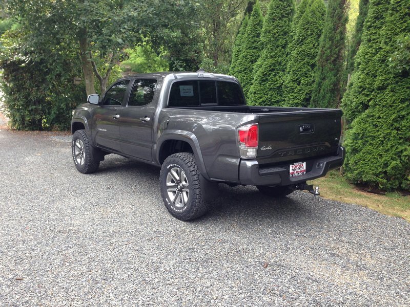

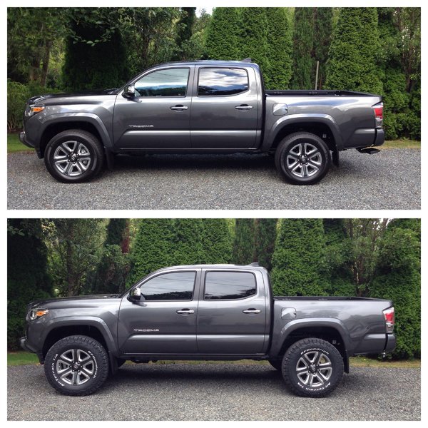

    Front Suspension: OME 888 front coils (~2 inch) Second gen Bilstein 5100’s set on second notch (~.85 inch) SPC Light Racing UCA’s camber set all the way forward Rear suspension: Wheelers 3 leaf progressive AAL (~1.5 inch) Toytech 1.5” blocks Bilstein 5125’s Wheels/tires: Stock limited 18x7.5’s ET+6mm 1.25” spacers BFG KO2’s 35x12.50r18 Cab mount/ fending liner trimming: Couple hours with the angle grinder and some rattle can to seal it up No Rubbing with the front air damn and mud flaps removed.
    5100's all around. 1.75 front/1.5 block rear, 275/70R18, 1.25" wheel spacers no air dam or mud flaps = no rubbing
    Before/After

    Are you leveled out with the 1.25in rear block?

    The term "level" seems to be quite subjective around here, so I'll let you be the judge by the pics I posted.
    In my opinion its pretty much dead nuts level. And to be clear, the rear block is 1.5" :)
