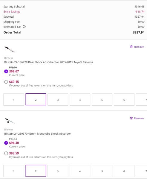

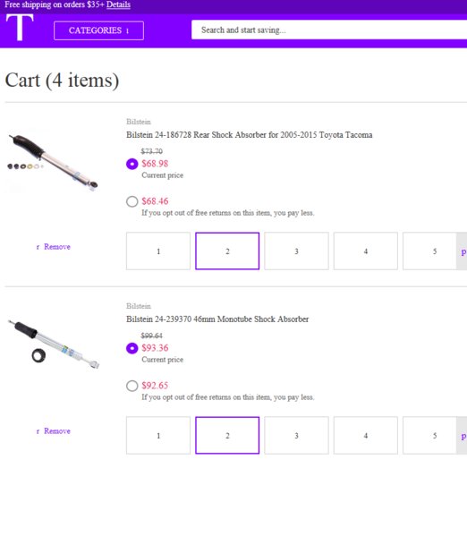

    Just looked them up on Jet and it's around 327, do I have the right parts and amounts in my cart?

    Looks right

    @foxhound_69 Did you have to sign up for Jet to be able to edit the quantity of the rear shocks? I tried it w/o signing up and it would only let me order one of the rear shocks but able to get two of the front...

    Have you tried recently? When I initially added them to the cart about 2 weeks ago, it would only let me add one, even after logging in.

    @foxhound_69 Yea that's about the time that I tried to order them. I will try it again and see if it lets me

    Yeah should work this time, report back and let us know!

    I got it to work!

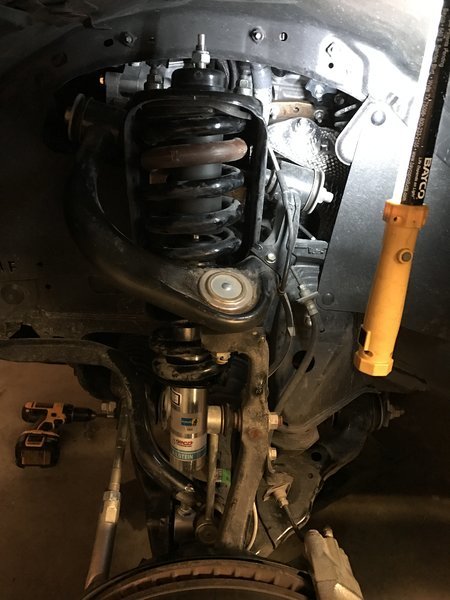

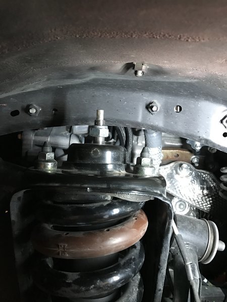

    Can anyone find me a picture of a '16 DCSB with stock coils and 5100s up front? I specifically need to see the top bolt of the shock. After install I let off the jack and let the assembly lower into place and with that bolt all the way tight there is still a gap. I set it at 1.75" and will post a picture in a second.
    Pictures.

    Ill get you a pic. Did you use an allen wrench in the top of the stud?

    Here you go

    And it looks like your missing some washers.
