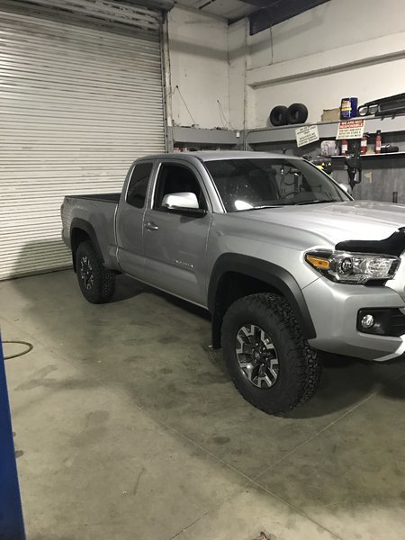

    Going with 5100’s on all 4. Looking for opinion/advice on .85 or 1.75 setting. Photo is stock height with 265/75/r16 on 2017 TRD OR. Looking for a just a little more height to better match the larger tires plus better handling. To be honest, this is mostly for just better appearance. Would like to hear general opinions based on the current look and spec on the truck. Thanks 91CAE001-093D-4E31-957A-F4F1347C9B88.jpg

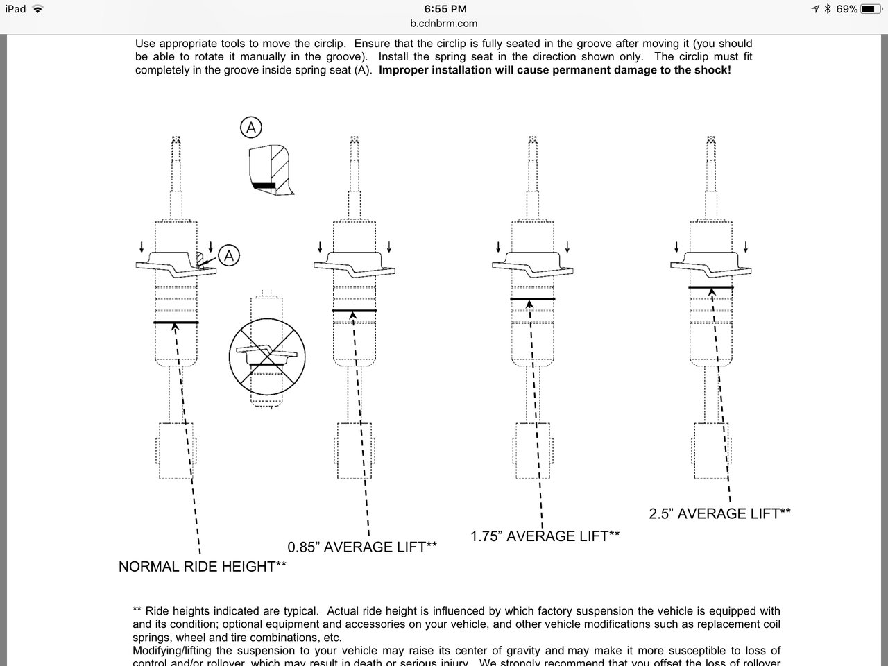

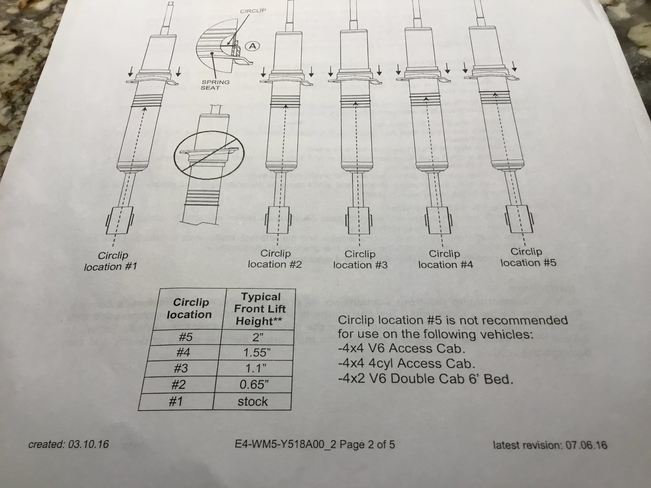

    Can someone please tell me why everyone is stating they set there 5100s at 1.75 when there is no option for that setting? Only 1.1 or 1.5?
  14. Jan 2, 2018 at 7:06 PM
    #434
    OregontoBajaCA
    OregontoBajaCA 2025 DC OR High Bread
    Dec 6, 2017
    #237812
    852
    2025 OR DC iF Max
    3rd gen 5100s do 1.55 inchD1B9AE93-94E9-4919-A2B4-60DB5580A7B5.jpg 2nd gen 5100s do 1.75 inch. You can order either. I believe from what others are saying, they both fit either 2nd and 3rd gen Tacomas

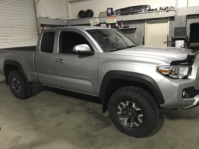

    I know this post is old but what size tires are pictured here!? Looks great! Is that with the lift at .85 (second gen bilsteins)?
