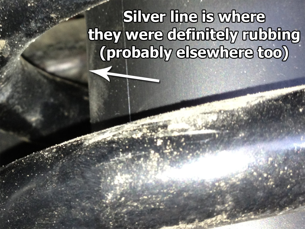

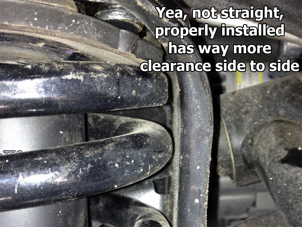

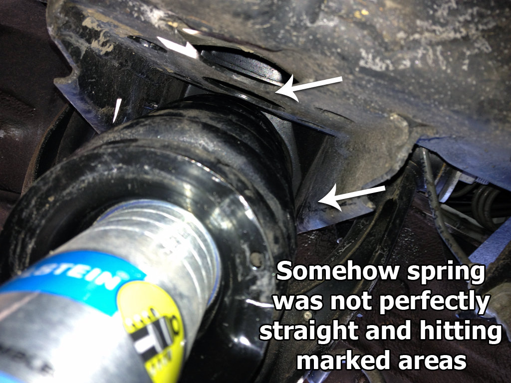

    I went out to fix my driver side top rubber piece screwup this morning. Since guy I did em with last night was tied up I went out and got a beastly 3 ton jack with 20" height max. Also got a ratcheting 19mm wrench for that freakin' top nut to make it easier.
    Jacked up truck, removed tire, put jack under frame. Did the quick spring compress method again and just twisted the spring around and put it back in more carefully. I lined up the hole with the strut shaft and then very slowly jacked it, making sure things looked good the whole time. Side was complete in about 30 minutes, amazing I was able to get properly torqued bolts (used air gun last night) by hand. Yea, my hands hurt.
    After I did this side, I noticed that the 'good' side (looked okay last night!) was no good either - this is where my clunking was coming from!
    1. The top rubber hat thing that had been perfect looking last night, and the only reason I realized something was wrong with the other side, was now weird looking. Wuddafux?
    2. Noticed spring didn't have much clearance behind it, nor side to side. It really looked like the spring didn't line up straight?
    3. Got underneath the truck on drivers side and looked directly up, could see spring was like buckling almost, definitely not compressed perfectly straight up.
    Did same steps on this side basically just rotating spring and SLOWLY jacking up the LCA with the top shaft lined up, making sure nothing stupid happened the entire time. This side took like 20 minutes. Both top rubber hat things look perfect now, I have much more clearance for the spring on the noisier passenger side, the place it was rubbing (pictured) is all good. Glad I only put like 4 miles on the truck until redoing it. Also glad it was a nice day out and that the bolts cooperated!
    TRUCK RIDES PERFECT NOW. ABSOLUTELY ZERO NOISE OVER BUMPS/DIPS/ANYTHING. Hell, it even feels better than stock yet the coils are factory and I'm set to 2.5"- no lie!
    Lay under your truck, under each side, and look up at the spring with a flash light. Does it have clearance on all sides?

    I don't think the rubber on top was even an issue with noise. I may have not even needed to twist the springs - just installing more carefully and controlled to make sure the rubber looked okay before I committed to putting top nut on and tightening everything else (again using the spring compressor-less method). Also before I put on the top nut I made sure the spring had clearance on all sides.
    I honestly cannot see anything else that would clank or clunk on this setup other than the spring hitting its surroundings - I do not see any moving part or arm that would cause clunks and clanks. Really easy to see if others are having my same problem - use a flash light and see how close the spring is to the black metal that kinda boxes it in on the sides and behind it. Don't even have to take the tire off. You can also look from underneath.
    All my stuff was tightened adequately, so shit, I guess if anyone wants to really eliminate two possibilities at once, go under with a 19mm wrench and a) look at the spring's clearance, and b) hit your bolts with the wrench and see if they accept any snugging up. :eek:
