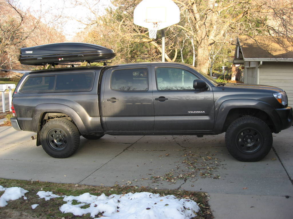

    I just got mine 5100's at 1.75" up front and TSB in the rear. In this pic I have the old tires and wheels in the bed, so it looks lower in the back then it really is...it sits pretty even...front may be about 1/4" higher than the rear.

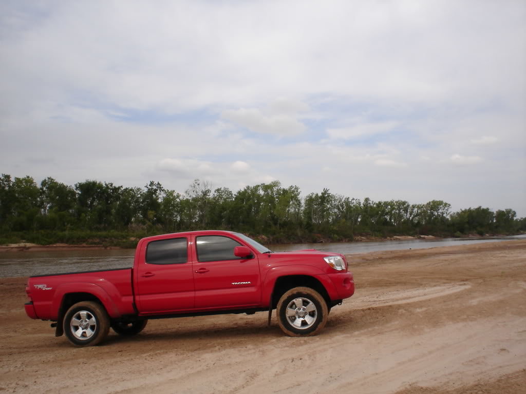

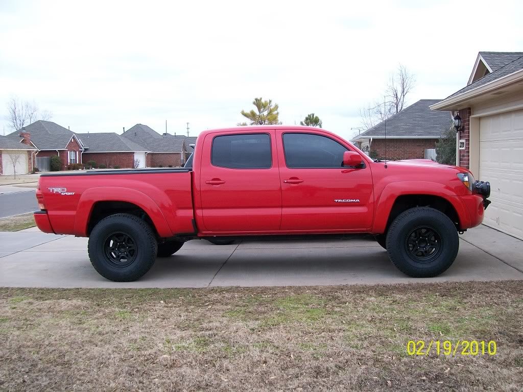

    I ran stock rear end and 5100 fronts at 2.5" for awhile, and it sat BARELY higher in the front, and drove and handled great. Then I got the TSB leaves in the rear and it sits perfectly level now. Here's a pic of it on stock rear and 5100s at 2.5" in front:
    Now with TSB rears and 33" tires:
    Most people want the rear to sit a little higher than the front, and I see no functional purpose for putting a block in the rear. If you want more lift in the rear for some reason, I would recommend saving for a whole new leaf pack. I don't want my center of gravity that high though, I drive lots of highway and higher-speed dirt roads.

    weird, yours looks perfectly level- (and awesome btw) I have had the TSB done, and the 5100's are set at 1.75", when there is no weight in the rear, the front measures about 1/4" higher than the rear. If i set them at 2.5" I think it would look really jacked. I wonder if that shell is causing it to "droop" I hope when I am towing my trailer it doesn't look like a tail dragger!

    Yeah that shell and carrier on it will def lower the rear at least an inch.
