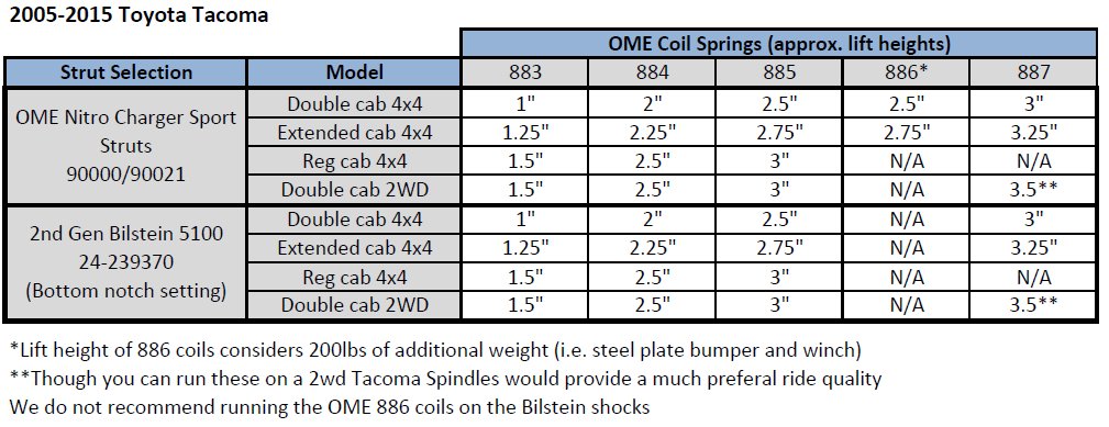

    The sites I did see to buy them came back saying they wouldn’t fit my 2015 OR. I tried base, pre runner and pro to no avail. I plan on getting the KO2s in a few months and just wanted to level out the truck at the same time. Yes it’s a mall crawler and some regular pickup truck work for my side job.
    Any help would be greatly appreciated, and thank you in advance.

    How many doors and how long is the bed? 4X4?

    Sorry boss, 4 door short bed, Thank you

    This should help

    Ok ordered the 5100's they arrive the 4th or 5th, and have a shop to install them. Going with the 1.75 adjustment to level the truck. THANKYOU all for your time and help
