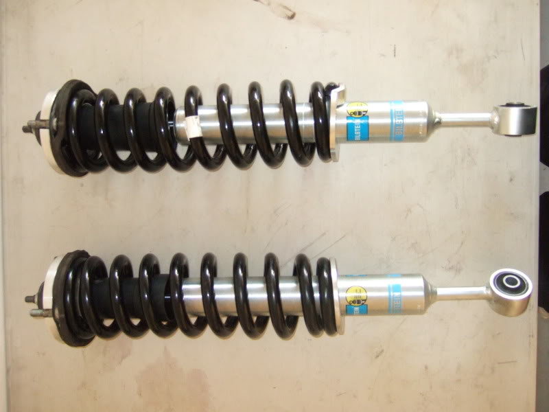

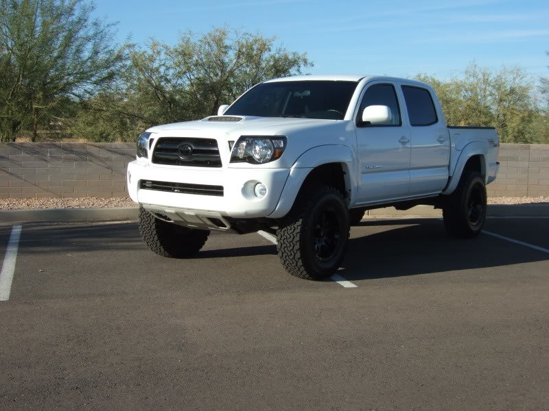

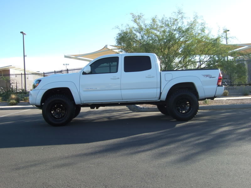

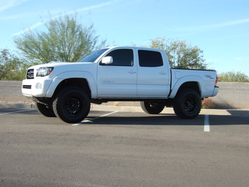

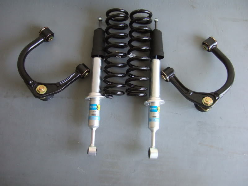

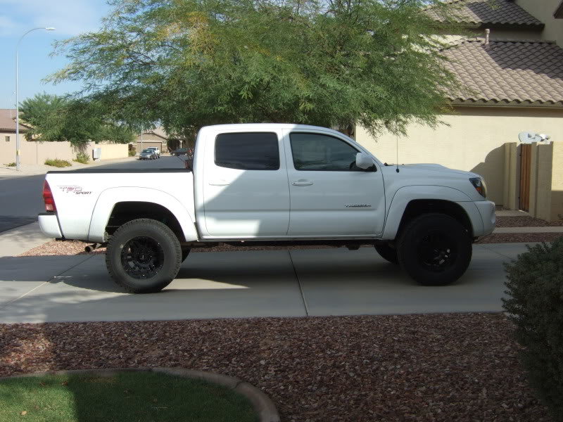

    After having the OME884s with the Toytech top plate spacer on my stock TRD Bilsteins for the past three years, I wanted to get my front end up a little higher. I just changed the front lift components. Kept the rear the same (stock TRD Bilsteins, stock non-TSB leaf pack, and Alcan Add-A-Leaf). I set the Bilstein 5100s at 0, used OME 885 coil springs and kept the Toytech spacer on top. I also added the Light Racing UCAs. I used to rub at full lock or often times in reverse, now the rub is gone. I really can't feel much of a difference between the TRD Bilstein/884 and these. No vibrations or anything. I'll be going in for an alignment tomorrow hopefully. On to the pictures...
    Bilstein 5100s, OME 885 springs, LR UCA
    Bilstein 5100s (set at 0), OME 885 springs, Toytec Spacer all assembled
    Before (Stock TRD Bilsteins, OME 884 springs, Toytec Top Plate Spacer, Alcan Add-A-Leaf)
    After

    I didn't rub on the UCAs with the 17x9s and 285/70/17. The 884s and top plate spacer probably gave me about a 2.25" lift after they settled. I did rub the fender liners slightly before, but now with the 5100s, 885s and LR UCA, I have ZERO rubbing. It's so nice turning into parking spaces without hearing that rub anymore.

    I don't think its that much lift, I'll have to check the measurements I took of the before and after. Steering wheel sits perfectly straight and doesn't shimmy at all.
    The ride is great. I really don't see much difference from what I had on there before, maybe slightly firmer, but it is still a comfortable ride.
