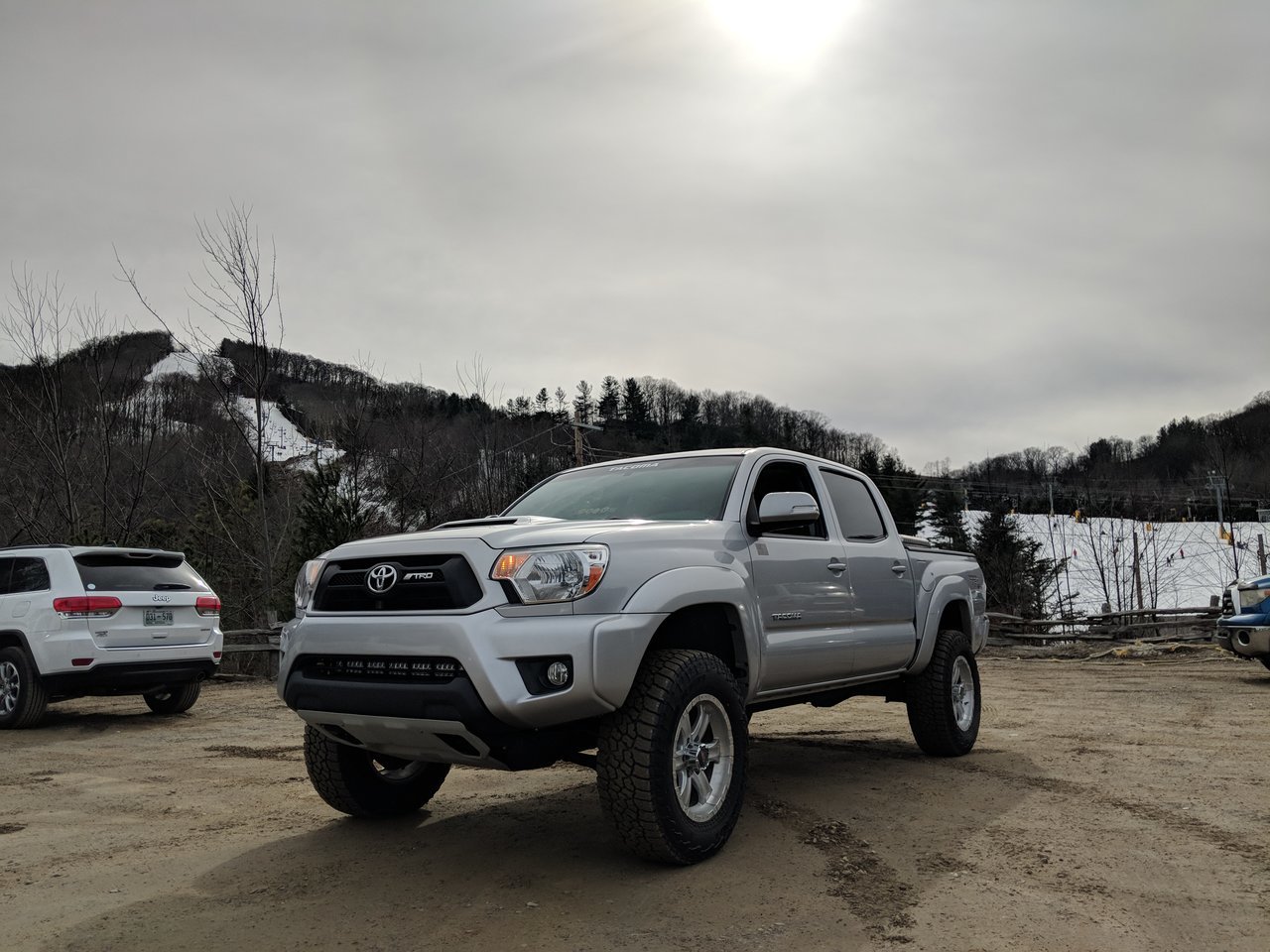

    Here's my truck now with the 3 inch spacer lift with 265 70 17s. I will go bigger in thet later. Just needed tires quickly for a good price which I love them Falkens.

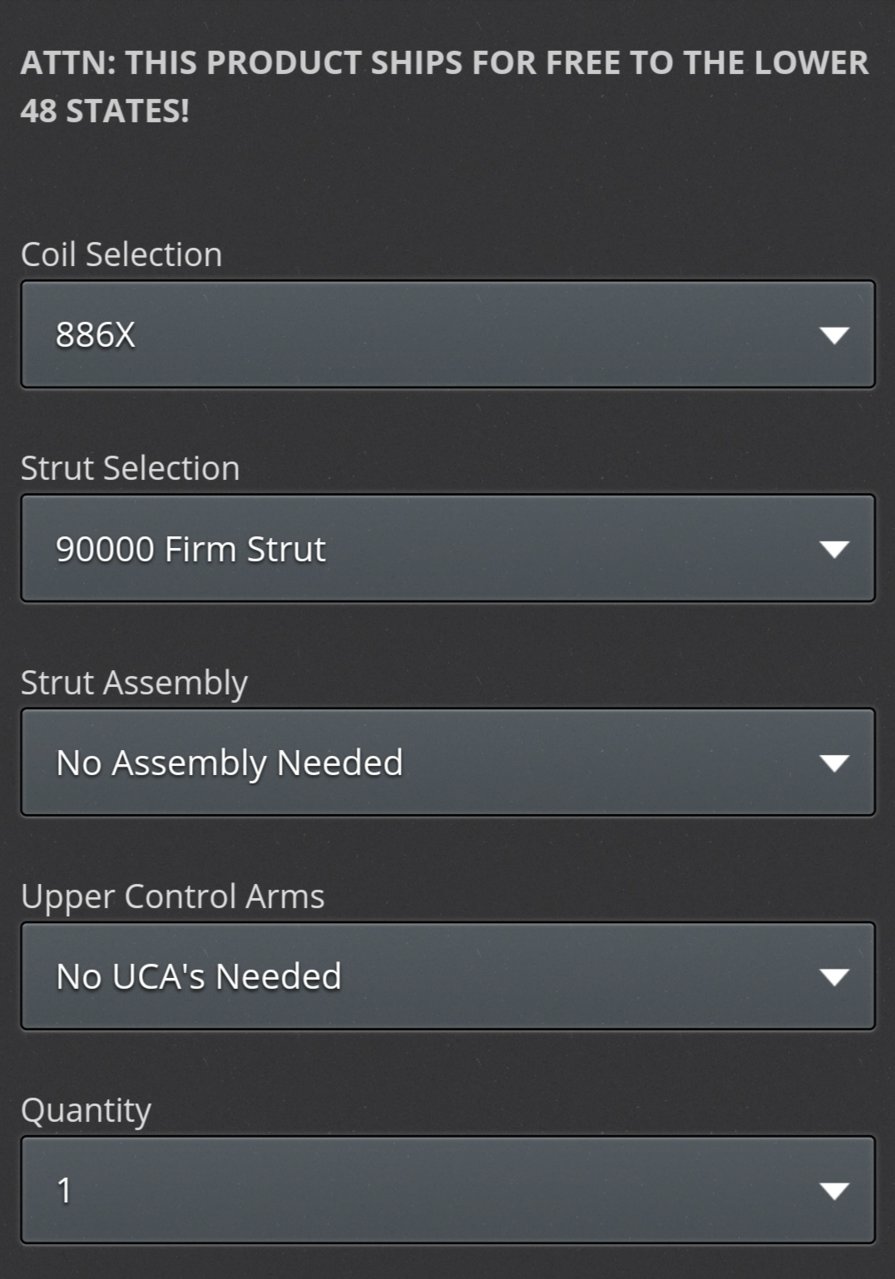

    I think I'm going with this

    Maybe I can do the headstrong kit and pay extra for the 886xs

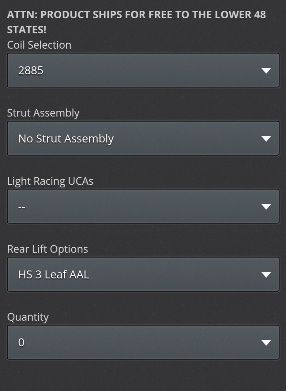

    This is what I just set up, thinking about pulling the trigger. But just wondering about what @Sub_Par said. Sub_par you around? Not trying to get an argument I just want a 3 inch lift like I have now with an actual kit instead of the spacers. If I was not going off road more I'd stay where I'm at.
