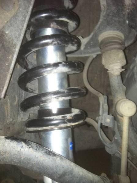

    oh an i just went take a picture of my perch but dont know how to post it...but just for shits an giggles i wanted you to look to make sure i did them right

    Brush Gaurd 265 Destinations 5100's @ 1.75 LED Lighting Center console Home made Saatchi DDM 5K HID
  17. Dec 12, 2011 at 9:53 PM
    #17
    Cajun1
    Cajun1 [OP] Well-Known Member
    Jun 6, 2011
    #57852
    99
    Brooks
    Abbeville, LA
    are they correct?

    are the perch the right way?
