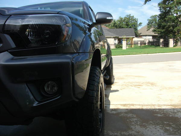

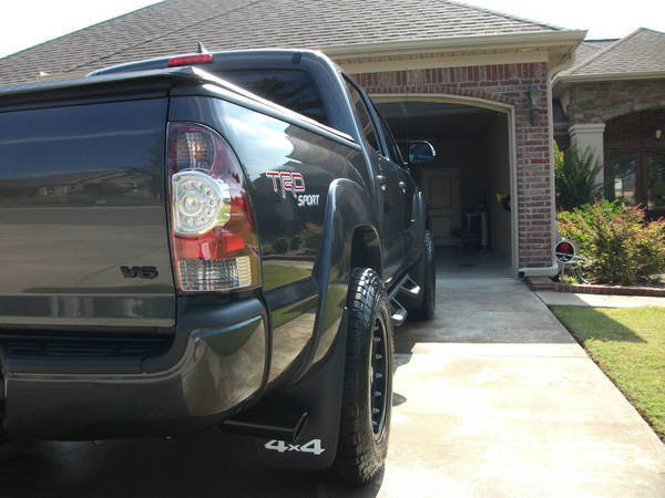

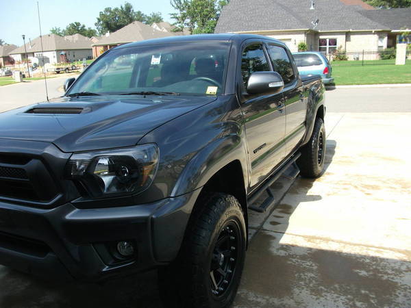

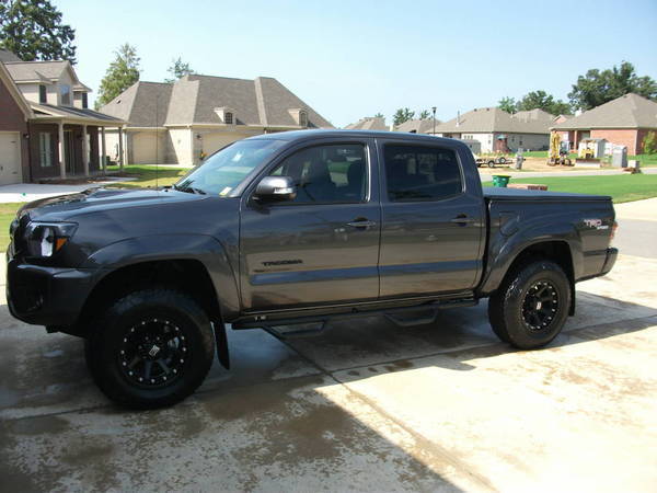

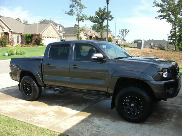

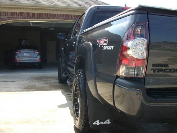

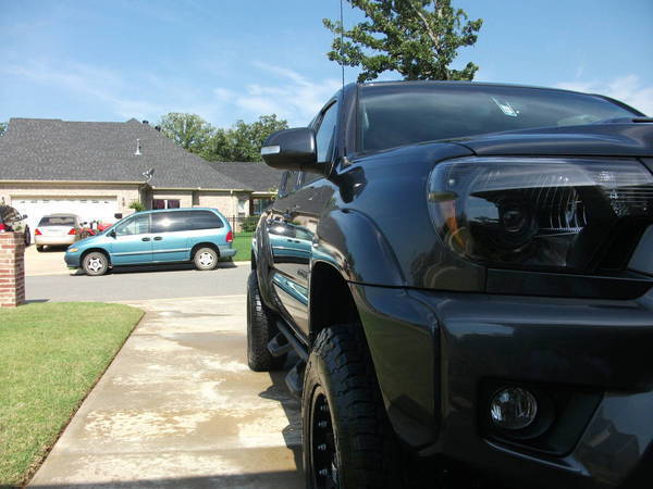

    Sorry it's taken so long, but I finally had a chance to clean the truck and snap a few pics. This is with 5100's on all 4 corners, fronts set at zero. OME 884x springs, and toytec 1/4" spacer on drivers front. Wheels are XD addicts 17x9 and tires are Nitto Terra Grapplers 265/70/17. Had to remove the front flap thingy inside the fender well and used a heat gun to reshape the inside portion of the mudflaps.

    What are all of the different measurements of the 5100's. Just curious

    You have 4 settings. 0" 0.85" 1.75" & 2.50"

    Have you ever measured your fronts? The Tacomas have what is commonly referred to as a "taco lean" where the driver's side sits a litte lower than the passenger side because there's more weight on that side. The reason for the spacer on the driver's side is to counteract this.
    885s are the springs recommended for double cabs and should get you about 2.5" of lift, may settle down a little, but you definitely get more than the 2" that OME says you will get.
    For the rear, you'll want to add about 1.5" of lift at least I would think but if you like the way it is now then I guess not. If you're at 1.75 on your 5100s I would think your front is sitting higher than the rear. If you like how it looks then just 5100s and you're good.

    As bjboucher stated, the 1/4" spacer is to correct for the taco lean. Not really needed unless you change the front springs as the stock springs do a slight correction from what I read.
    I went with 884's because based on my measurements, I only needed 2" to level the truck. Mine has the 4 leaf rear, so if yours only has 3 you may need to add a leaf to the rear to get it level if you go with new front springs. On mine, I just did a direct swap of the rear shocks.
