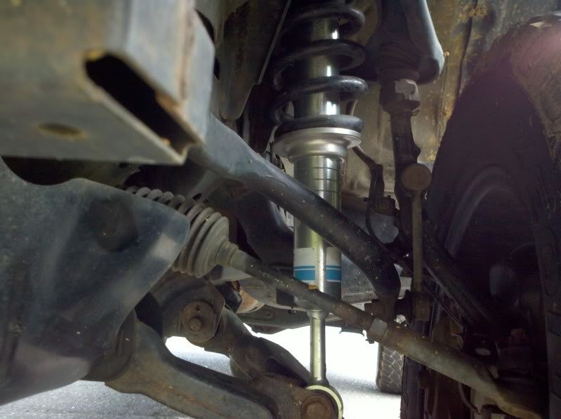

    You are very wrong for 2nd Gens...For 2nd Gens, the 0 setting will get you 1.6" of lift on a double cab (a little more for 2wd and also for smaller cabs),at .85 they'll get you around 2.5" of lift.

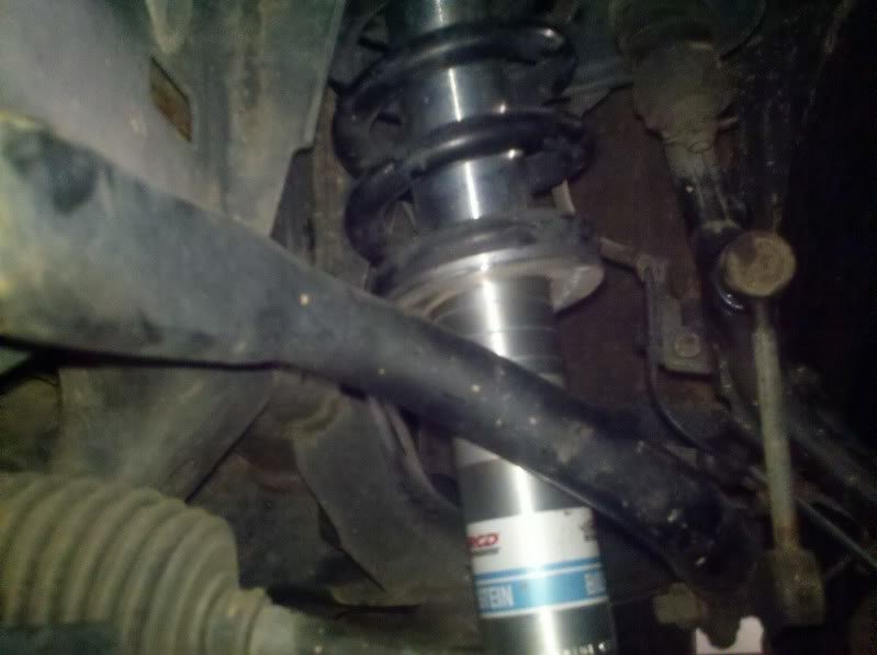

    OP, check to make sure the spring perch is installed correctly (not upside down).

    some of the eibach coils are only rated to give ~1.75". that's why folks were doing .85" on the shocks to get the 2.5".
    some settling should be needed. other thing would be to look at the lower spring perch and make sure it is installed correctly.

    OP, if your coil seat looks like this, you have problems!
    If they look like this, I'm not sure why you got so much lift unless you accidently set them at 1.75:

    You more than likely IMO have upside down coil spring perches. You should not have that much lift even before the springs settle.
