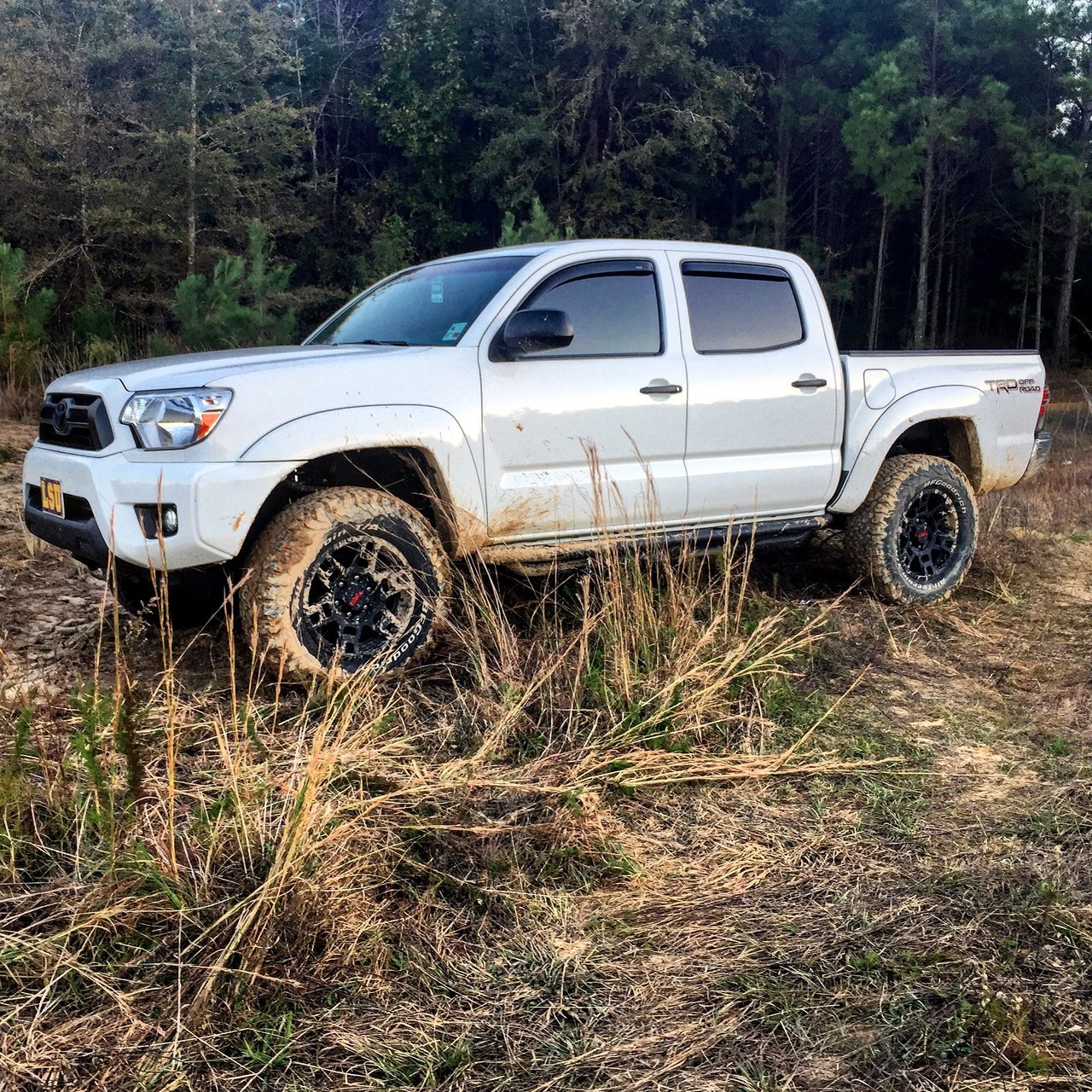

    CoastieRon, Andrew H and Rivermaniac like this.
  19. Mar 28, 2018 at 9:22 PM
    #19
    Rivermaniac
    Rivermaniac Well-Known Member
    May 24, 2017
    #219805
    53
    You running 5100 with 884 coils ??2wd or 4x ? And what did you do to the rear ? Looks really good .
    CoastieRon likes this.
  20. Mar 28, 2018 at 9:37 PM
    #20
    s_bautista
    s_bautista Member
    Oct 30, 2017
    #234618
    24
    San Diego, CA
    Thanks. Theyre 885 coils. 2wd got a 2.5in lift. Rear is a Deaver AAL.
