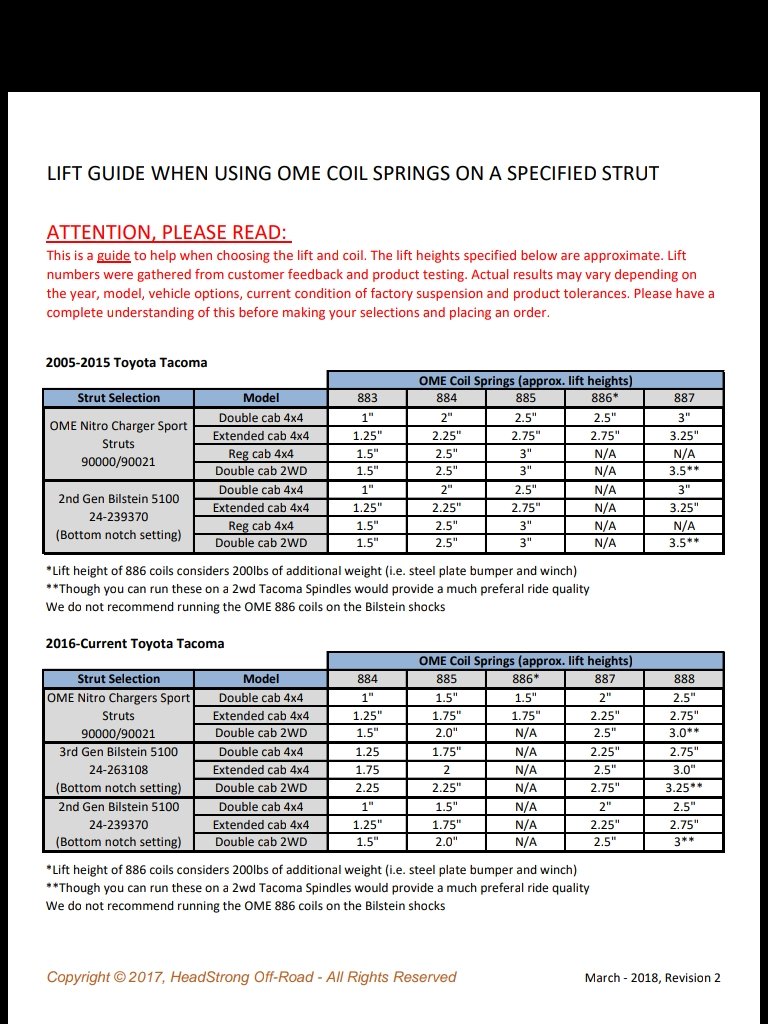

    Youll get about the same lift with 884s in the front.. 2.25-2.5ish.
    Heres the lift guide from headstrongoffroad..

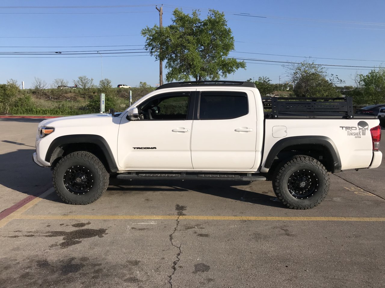

    Heres a before/after. I got bout 2.5in lift in the front with 885s. Some say for doublecabs 885s are better for the extra weight. The ride is a little bit stiffer but it doesnt bother me. I have a AAL in the rear and have about a 1/2in higher rake.

    So the chart says 2.25" for 2x4 DC on the 885s. You got more? Interesting. Did you put the 1/4" spacer on the driver's side as well?

    I did put a spacer. Im assuming cause i just installed it (3wks ago), it hasnt fully settled yet maybe..and i havent remeasured it since..

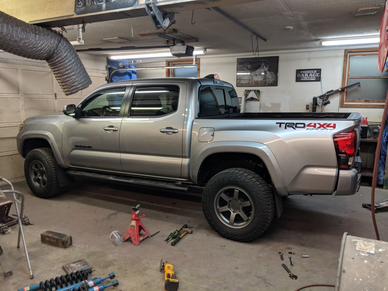

    Done , 2nd gen 5100 , 884 ome coils
    DRMetz, s_bautista and 09 Redneck like this.

    Hey that looks really good! Do you have pre and post lift measurements? Also, are you on setting 1? Also, did you put in an AAL?

    Fronts are on stock setting , lifted 1.5 inch used 1/4 hs spacer for lean , stock rear
