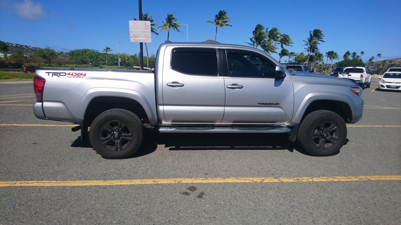

    I just installed a bilstein 5100/OME 884 suspension overhaul with 1/4" headstrong spacer on the driver side front of my 2016 TRD Sport 4x4 along with Deaver AAL+5100 rear. Alignment got everything plummed and feels great. No body roll in turns and no rebound after bumps feels much more secure than the jostling of the 5 year old stock suspension.
    Tires are stock size 265/65R17. I have no plans to change size or tire since they are 1 year old.

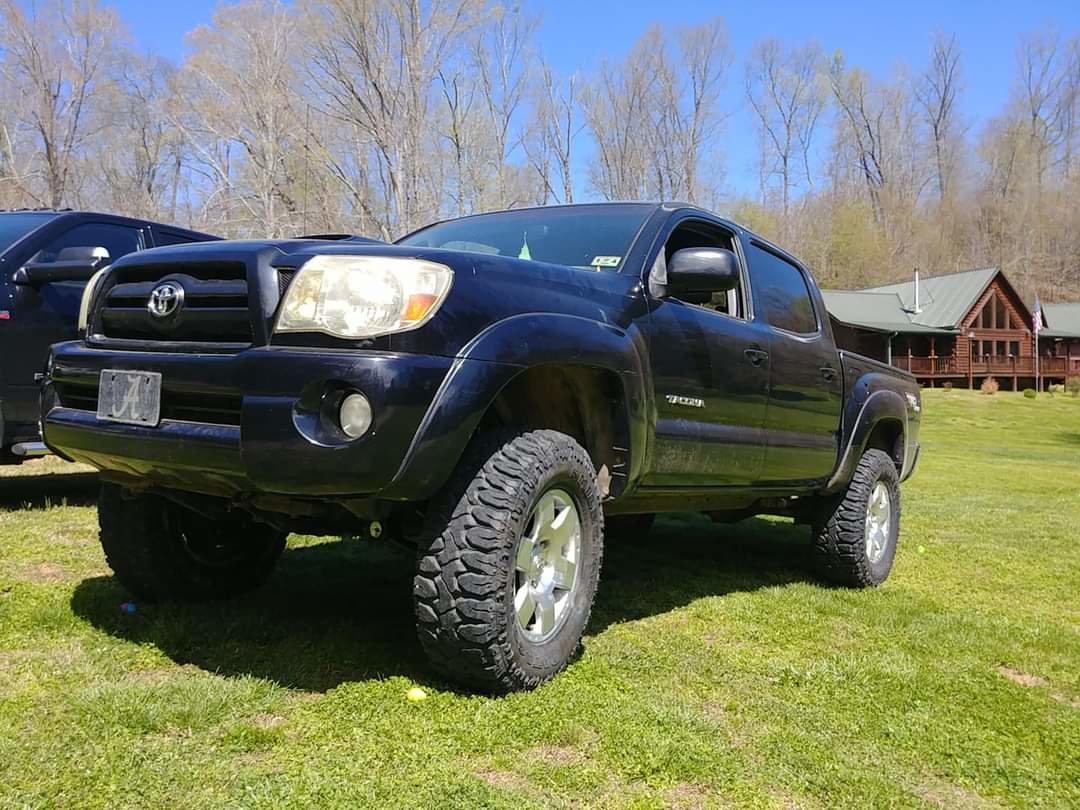

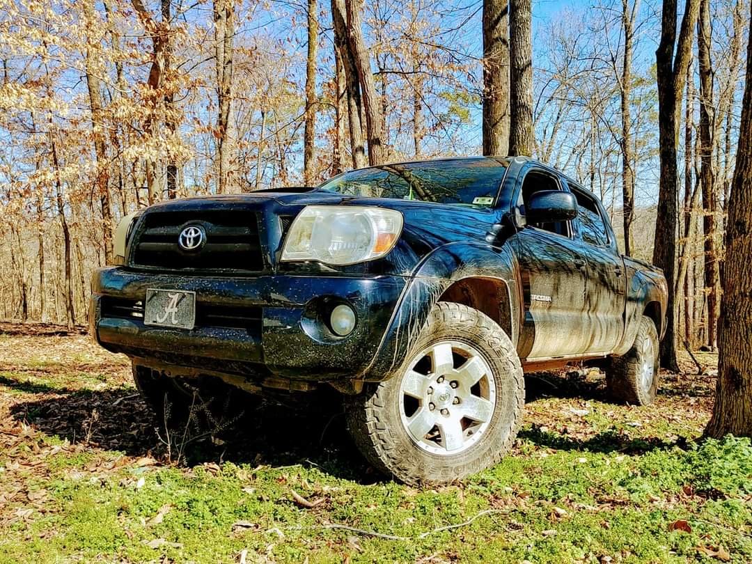

    Been awhile since I had the installed. I will have to get aftermarket bumper so smooth out the ride. It is stiff AF. Ended up replacing uppers, lowers, dropping diff and replacing/ extending the FB_IMG_1644118952529.jpg FB_IMG_1644118957250.jpg sway linkage. Here is the before and after.

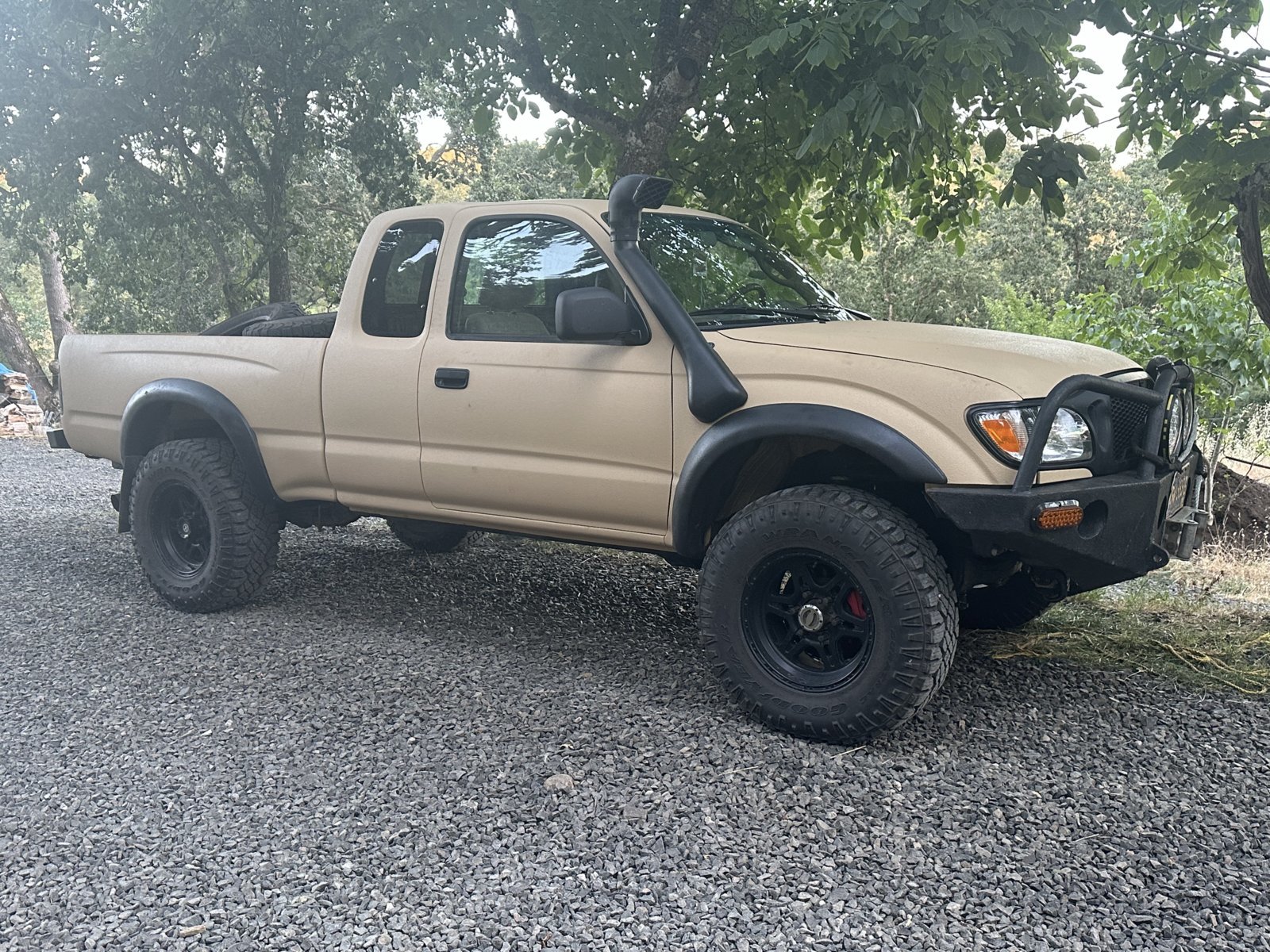

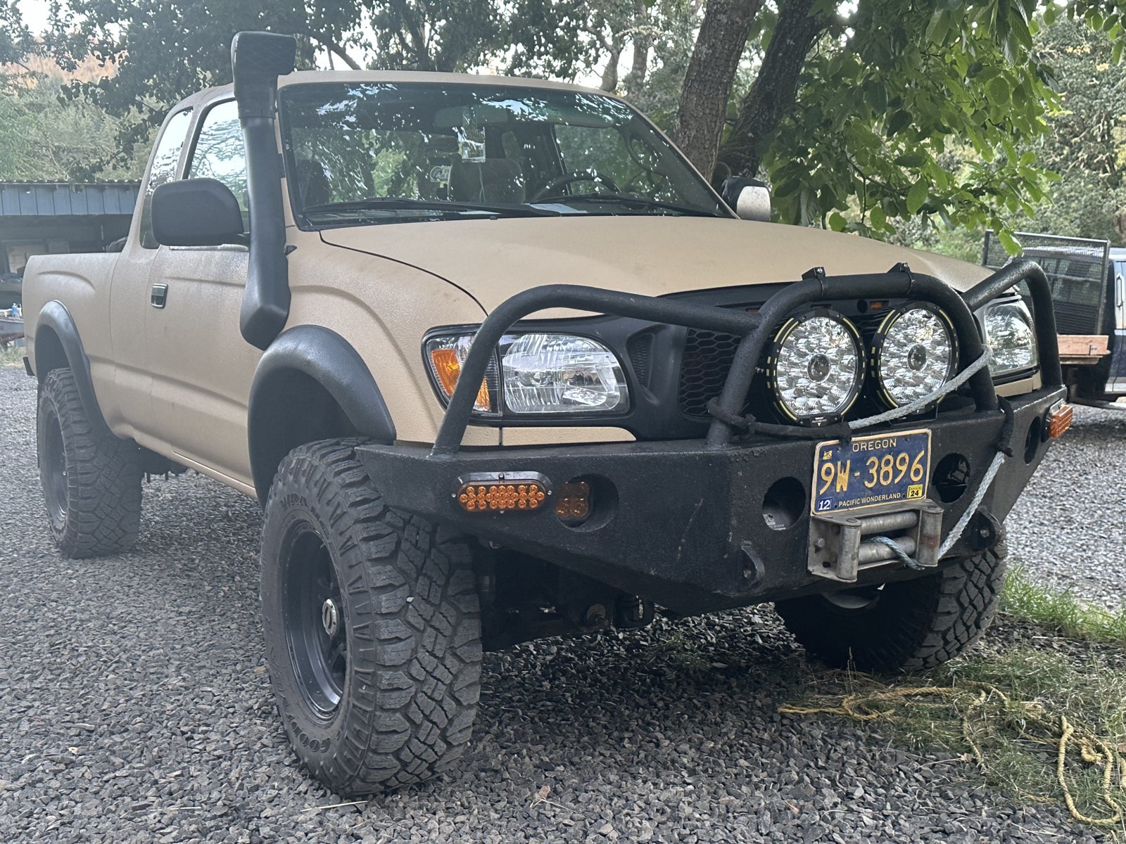

    Hey guys. Hijacking an old thread. 03 1st Gen extended cab with winch bumper / 10k winch.
    5100s with 884 OME springs @ “0” circle setting & .25” spacer on drivers side.
    Wheelers off road 2” rear springs. Donor TRD E-locker rear & Truetrac front.
    Considering swapping the front 5100s with 6112s.
