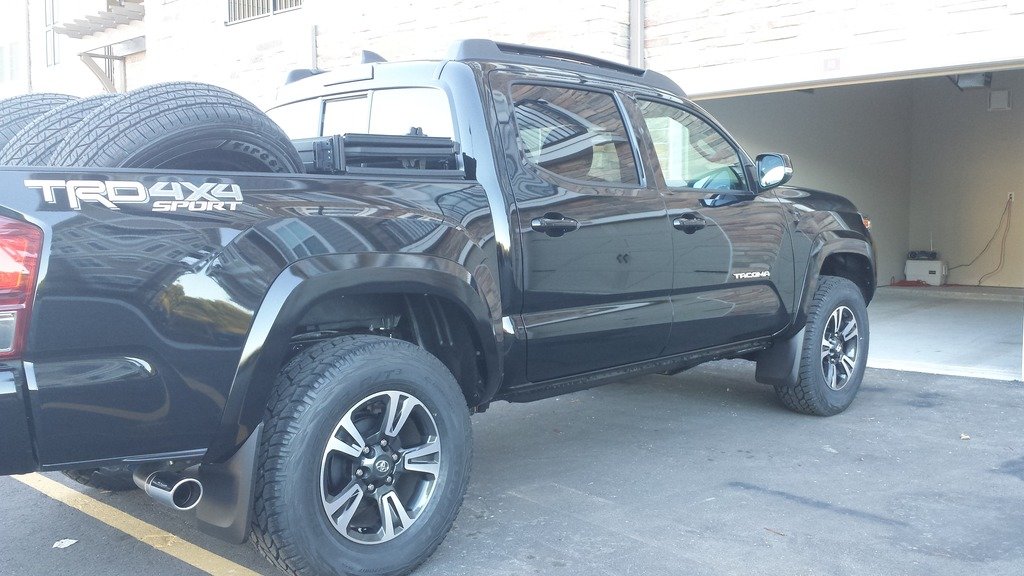

    Alright, So here's my summary install of four Bilstein 5100's Set at 0 with OME 885's and Rear Toytec AAL 1.5- 2inch on my Third Gen MACO.
    Difference ?
    FRONT STOCK HEIGHT (Hub to Fender) : 21inches
    REAR STOCK HEIGHT (Hub to Fender) : 22inches
    After Lift (No settling period)
    FRONT: 23.25inches
    REAR: 24inches
    Added a Driver side 1/4inch spacer consideration for TACO LEAN
    Total cost?
    $245 - Bilstein 5100's front+rear
    $141.84 - Old Man Emu 2885 Coil Spring
    $27.99 - Driver side aluminum 1/4 spacer
    $84.99 - Rear ToyTec add a leaf 1 1/2 to 2" lift
    $0 - Install - do it yourself people. find someone to help if you don't have tools. Buy them a beer! Find youtubes installs, find sticky installs here to help!
    Total $500 rounding up.
    Piece of mind by not doing spacer lifts and doing lifts the right way? = Priceless.

    BEFORE:
    AFTER:
    Please note I have a Rwd Tacoma,

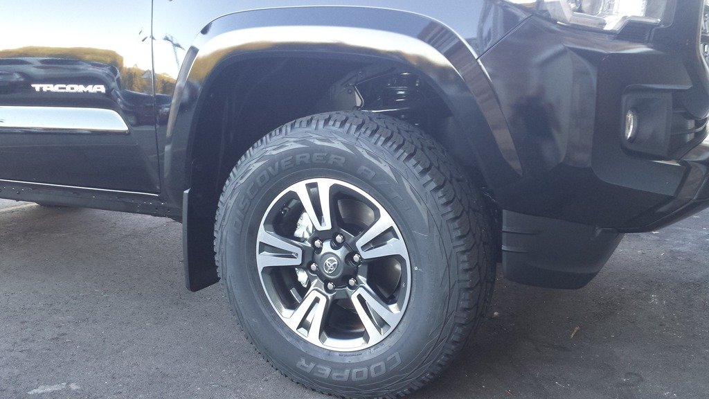

    By the way for tire suggestions I am really liking the Cooper AT3's I had installed.

    Here are a couple of pics of the AT3's. These are P265/70/r17 and are about one inch taller than stock. They are very quiet and handle better than the stock firestones in my opinion. If I lifted my Tacoma by 2" like yours, I would seriously consider P285's. I have no rubbing at all with the 265's stock.

    Very nice look to them, what do they run? $
