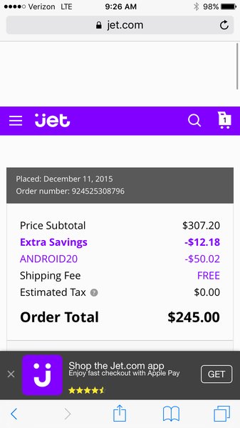

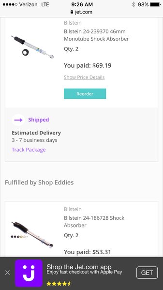

    where did you find the 5100's front and back for $245?? i can't seem to find front and back for less than $340

    Jet.com use first time purchase coupon code for discount

    Try Jet.com they often have a coupon code for 15%-20% your first purchase you'll need to know the specific model code for the front And back Bilstiens .
    See attached pics
