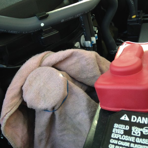

    To help in draining, I first remove the oil cap and place a shop rag with a rubber band to keep it in place and keep out foreign matter. Be careful! It comes out like a dam, have a big pan in place is highly recommended.

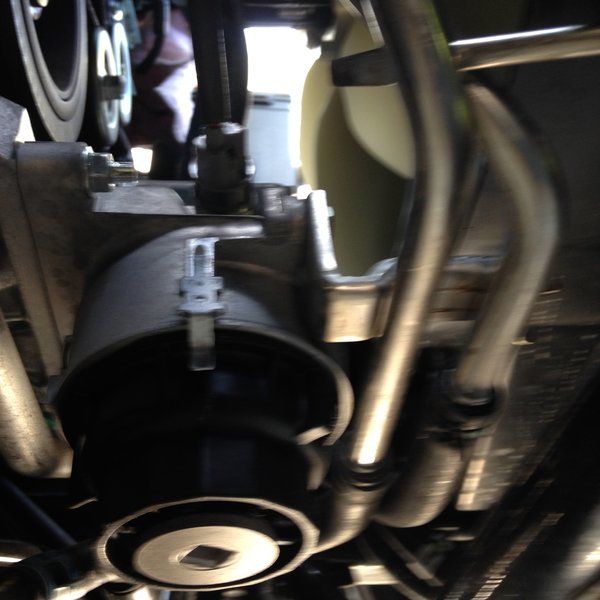

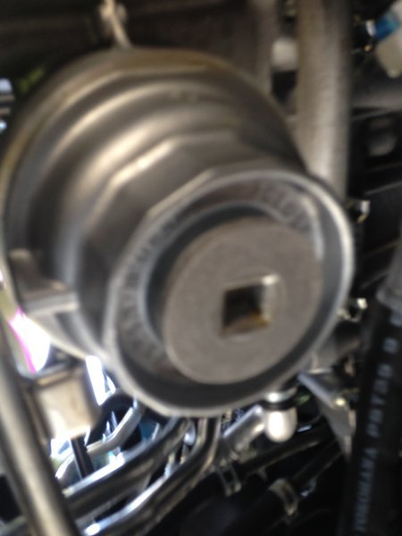

    Next I replaced the filter. The cap at the bottom comes off easy if you place a 3/8” ratchet and strike it counter clock wise with your palm. Next, you push the plastic drain tool provided with the oem filter. I bough a tool for this at Amzon, but you can just go to the hardware with the tool and have them fit you a 5/8” X 3’ nylon tube & cut to reach you pan while oil is draining.

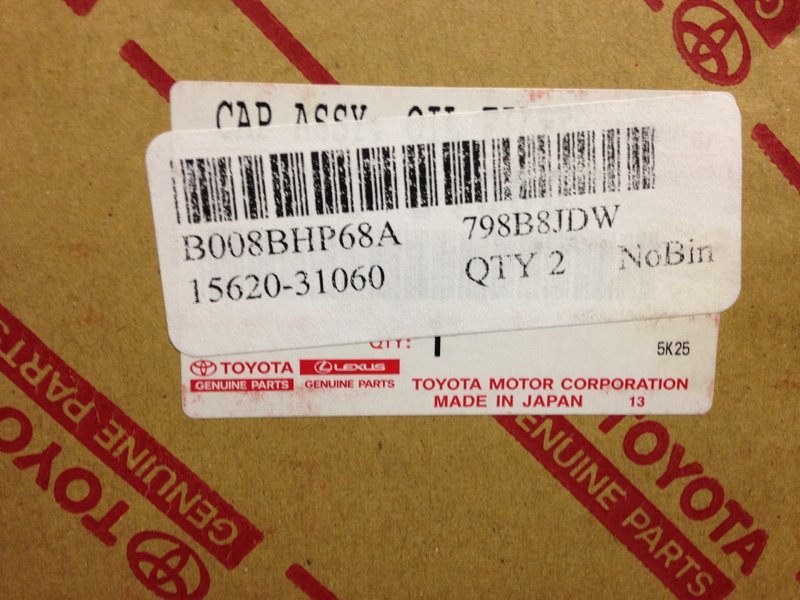

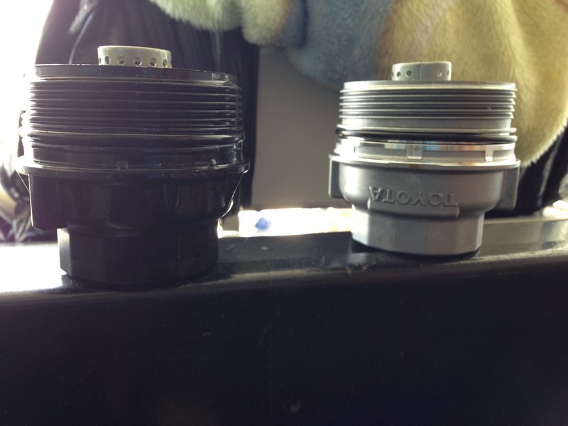

    I replaced plastic filter cap with an aluminum oem cap.
    Nothing wrong with the original plastic cap. Just my preference, and to maybe add more cooling to the oil in the filer cap by virtue of better heat transfer from metal vs plastic cap.

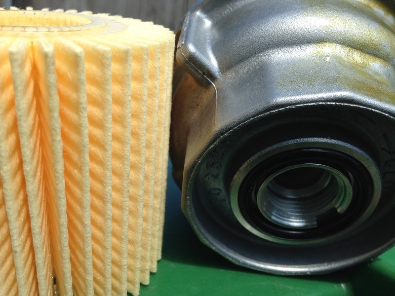

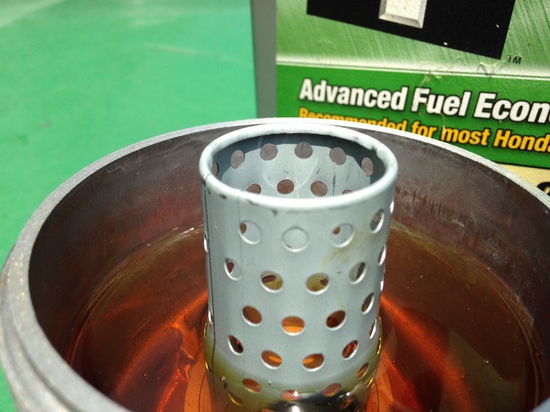

    I prime my oil filter to avoid a dry engine start:
    I installed the new o’ rings and drain cap to the filter cap and fill it up 3/4 of the way with fresh clean oil.
    I installed the new cartridge and continue adding oil to the top careful not to over-spill while installing it back on the engine.

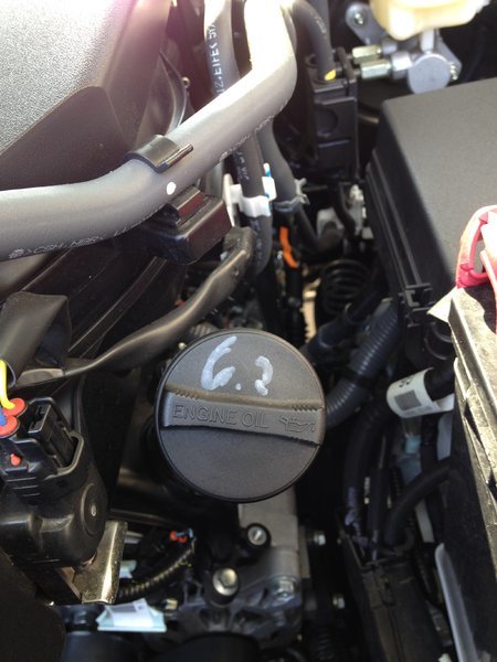

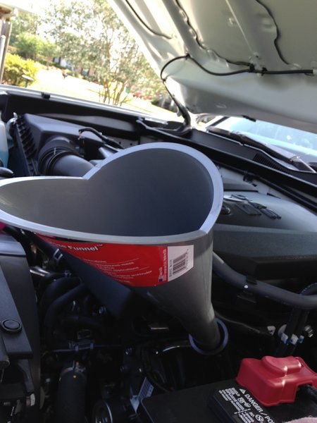

    I bought a cheap $3 long neck filler at Walmart and cut the neck to my preference. Added the remainder of synthetic 0-20W oil to a total 6.2 qts

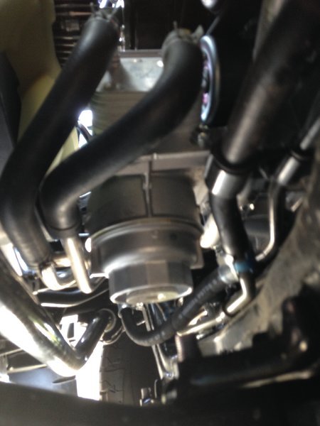

    Potential Issue nipped in the butt:
    First thing I observed on first oil change is how close the oil cooler lines were on mine to rub against each other and cause a leak at some future time, in a dark desolate place. There’s no sleeve there either to prevent this, very untypical for Toyota.
    So I took my pry bar and easy & gently I pried them apart (1/8-1/4”) or until I could pass a medium size screw driver blade in between, problem solved.

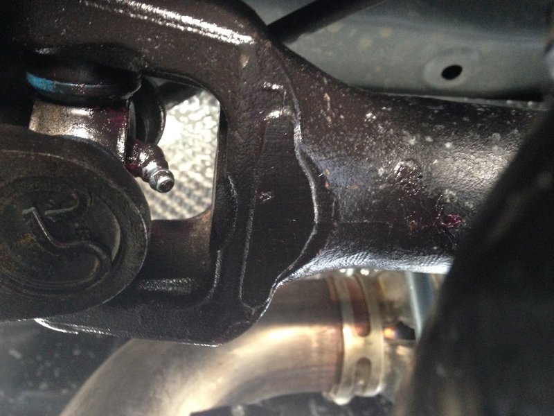

    I greased and purged my U-joints with a $6.99 Harbor Freight 14 Oz Sta-Lube® Sta-Plex® Extreme Pressure Premium Red Grease, since I will be driving 16 hrs straight the first day, before overnight stop in summer heat on my way to Vegas.

    Where did you get the aluminum oil cap? I see conflicting opinions on the part number and seeing you are using one I'd like to know where you bought it. A link would be even better :)
