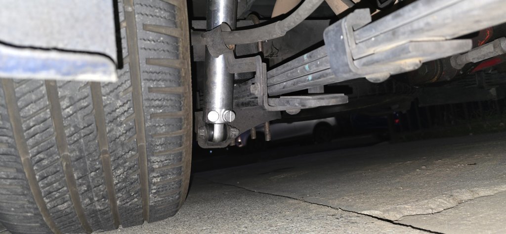

    So you guys are saying the 4x4 leafs are softer than then original 2 pack leaf springs found on the x runner?
    I also put the rear to 0C 2R and started noticing more bounce/stiffness from the rear. It could be that the front springs are too stiff and that translates to the rear?? I do have the 450 lb springs coming in this week so i can test if the front springs are too stiff or the rear 4x4 leafs that i installed into the x runner.
    Dont like the fact that once I take a hard turn or round about, the truck starts to bounce. Mainly from the rear i believe.

    Yeah, I sort of figured they were softer than the redesigned ones. They work great for me as I don't need as much stiffness in the rear now that I'm running a rear sway bar. GIVes me the right combination of softness and handling.
    I don't know how the spring rate of the current 4x4 leaf springs compare to the stock X-runner ones. I do know that my pre-TSB 4x4 leaf springs are softer than my stock base model leaf springs. Since you have an additional chassis brace in the rear of your truck and stiffer springs my settings may be too stiff of a ride for your truck. Also I'm coming from a slammed Scion xB that had every imaginable chassis/suspension brace and poly bushings on all of it with a 225/30R20 wheel/tire combo, so I'm used to a very stiff ride. The only saving grace was that I was on air so the lower I got the softer the spring rate got.

    I just installed my Viking shocks, front and rear. Running 650 springs in front and have 4x4 leafs in the rear. Ride is really good for a Handling setting, per Viking's document on it.
    I suggest changing your C/R settings at each end. Your front settings look ok, I have mine at 8C and 12R. Drop your C by 2 and the R by 1.
    Your rear setting are out of whack tho. Per Viking, the rebound setting, R, should be roughly 2 to 6 clocks higher than compression, C. You have 7C and 4R, so you went too low on the rebound. I'm running 6C and 8R currently.

    Shouldn't be. Your only lowered from the Viking shocks? That's what I'm at and only dropped an inch in the front. Rear is still basically stock height. I can't tell if you have blocks in the rear or not but if you do, that could also contribute to the harsher ride from what others have posted.
    I have CalTrac bars to install still as well. What do you have for traction bars?

    My suspension setup is:
    Viking coilovers in front
    Viking shocks in the rear with a 2inch drop block.
    3rd gen 4x4 rear leaf springs
    12 performance front and rear sways
    Urd traction bar
    The drop in front were only an inch and rear of course were 2 inches due to blocks
