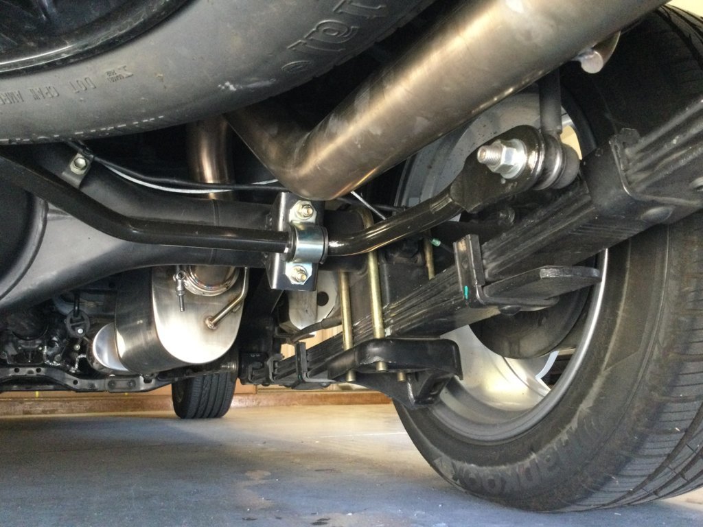

    Oh, the photo below is my Regular Cab with a X rear sway mounted in poly bushings & TrueTrec. It still understeers with the stock front springs and 4x4 leafs.
    You need to research under & over steer and what causes it! After you explain what causes each here we can discuss spring rates.

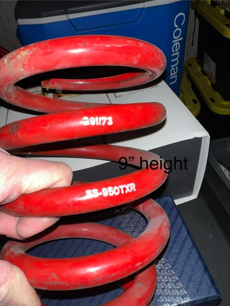

    Yeah the 10" springs seems too short and I feel like I get some amount of play. Hopefully the 12" springs that I got from hayrider help out.

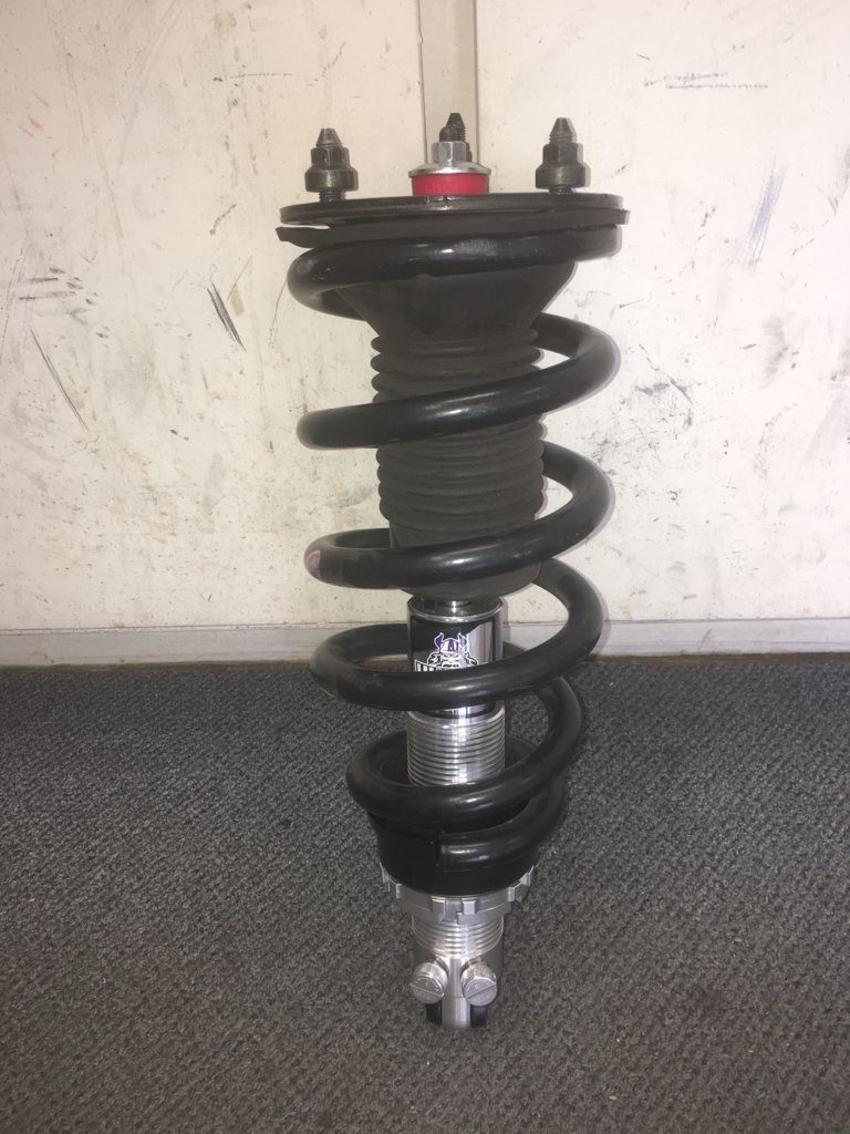

    Yes 2.5” springs are a standard size coil over spring. I run a front shock that calls for either a 10” or 12” spring so I thought I would try a 10” 525# https://www.hypercoils.com as rumor has it that Hyperco & Swift springs are the best quality springs.
    But as far as I’m concerned is I love using the stock springs with the mount / spring perch from SOS / Tundra Racing. (See photo) The mount coil binds about 1/2 of a coil therefore increases the OE spring rate just a bit. A shorter spring is a stiffer spring. The percentage? I do not know but my butt Dyno likes and I wish I could test the rate increase. I’m sure there’s an engineer here somewhere who could figure it out. Know there’s a difference between the regular cab, access cab and X springs. You can see the difference and definitely feel the difference.
    As for spring rates there’s a few ways to find out. Get a corner weight of the truck and someone who knows suspension geometry to figure it out. It’s all about where the pivot points are and how & where the spring is located on the LCA or is it a Fox Body Mustang where the struts are attached to the hub. The Fox Body uses a lot lighter springs because where the lower shock / strut is located. Just think of a teeter totter, if you move off center then the weight changes. Yes that’s a crude analogy but it’s the only way I can think to explain.
    Or another way is if you have a spring that’s blank inches long unloaded a coil spring should compress 25 to 30% of it’s uncompressed length.
    Don’t feel bad almost everyone who wants better handling thinks a little stiffer is better so a lot must be better yet! You want the body to not flop around but it’s a street vehicle and let’s face it road surfaces are not smooth like a race track.
    When I first purchased my first Miata I jumped in with both feet! Driving into work on a Monday after spending a weekend installing “racing suspension” there was a section of unbridged road about 300 yards across that was nothing but pot hole filled road. I think the hole road was nothing but filled potholes! It was a beautiful cool morning with the top down and not a care, I hit the pothole section doing about 50 mph and the next thing I know it’s all I can do to keep the car pointing straight. Took another way home and removed the massive sway-bars that night. I had the suspension so stiff that I actually hated the car.
    Edit, I forgot the photo of the OE coil-over.
