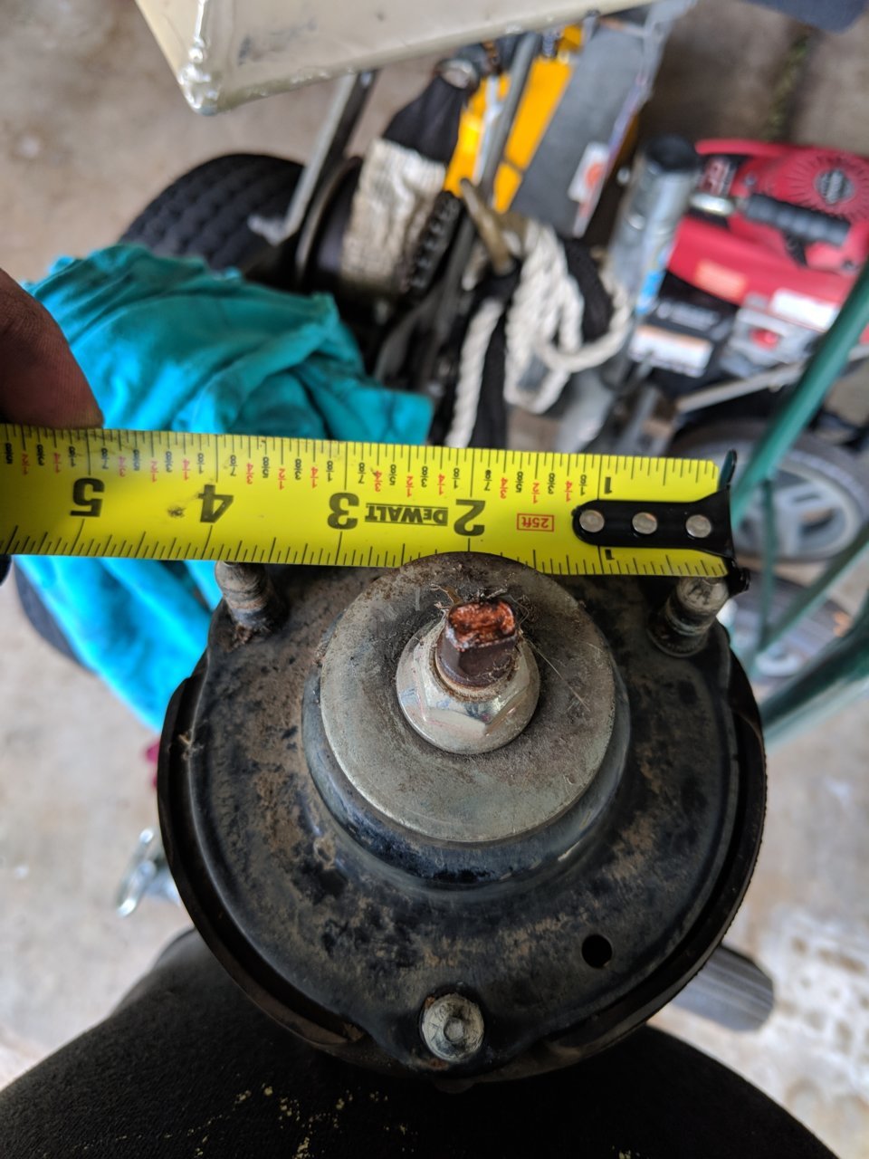

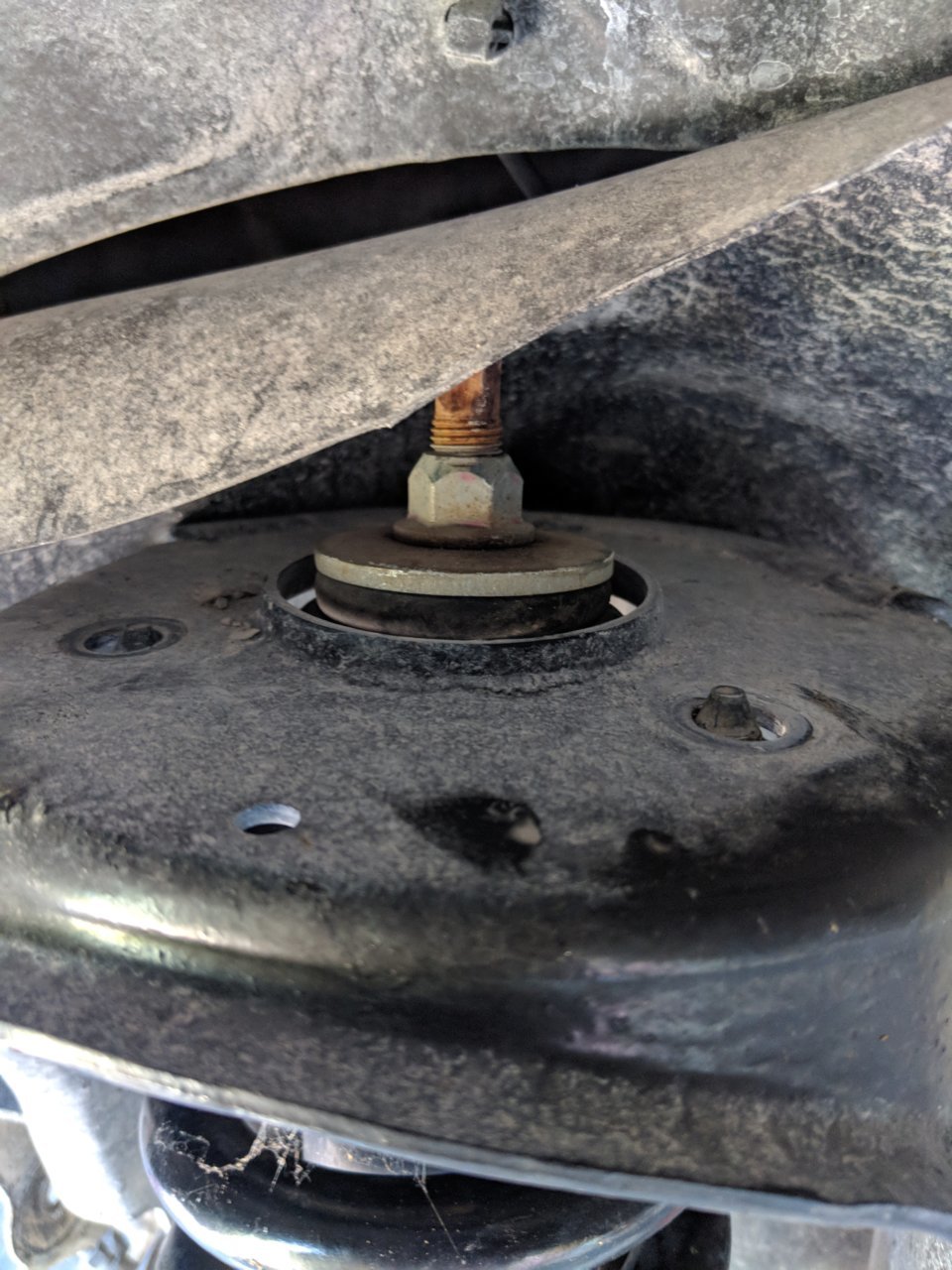

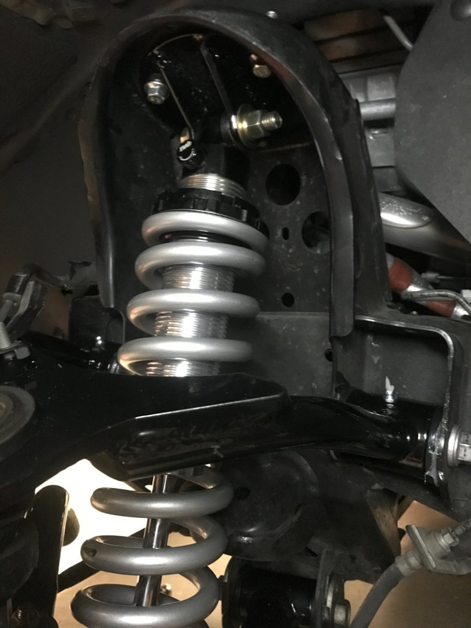

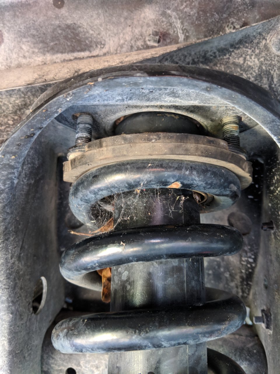

    This is really cool. When it comes to lifting there is usually a limit with the upper control arm hitting the coil. I'm curious if the coil is small enough to clear but i ended up with a total chaos upper control arms so I'm going mid travel with a set of Kings lol.
    I should also note I do believe our top hat lug pattern is the same as the 6 lugs. I got close to seeing but the shock was way to long.
    6 lug top
    5 lug top

    The six lug pattern is different

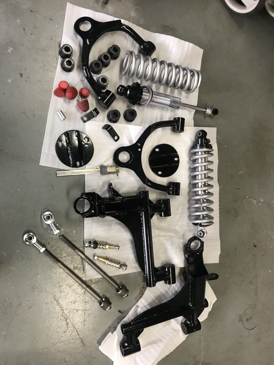

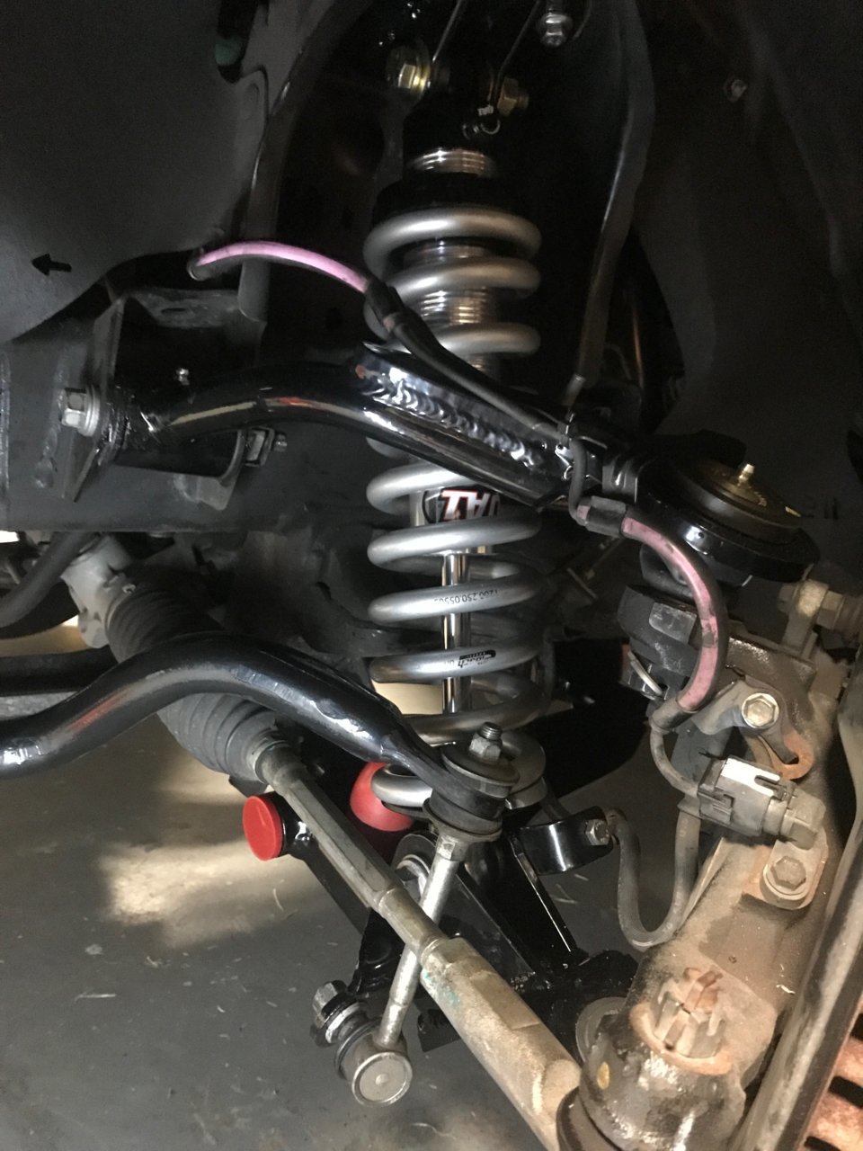

    Where did you get those tie rods from? I have to get longer ones (o make em) due to my front drop (toe is at its closest to best as possible right now).
    Are those pieces by the tie rods the new ball joints? As of now I am using OEM ones, but would like to get ird of the whole greasing and all and just get uniball joints.

    That is a bump steer kit I put together. I have not tested everything yet but the inner tie rods will need to be cut down as they are too long as they sit. They fit the new heim joints also shown with a 3” Adjustable GM Tie-Rod Adapter Stud to Heim kit.

    Let me no how that bumps steer kit works. I would like it for mine.

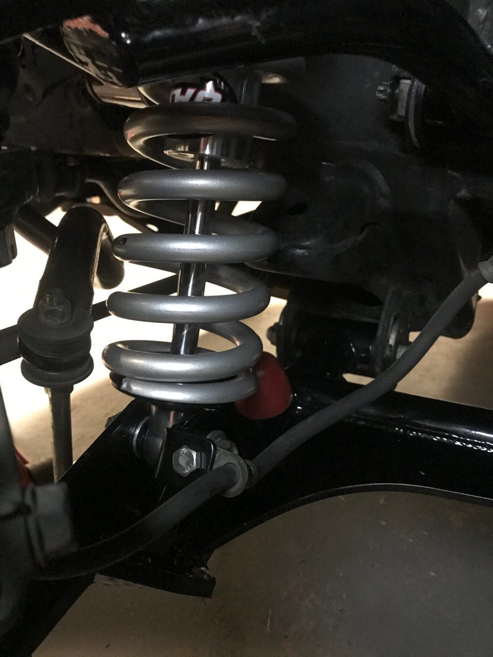

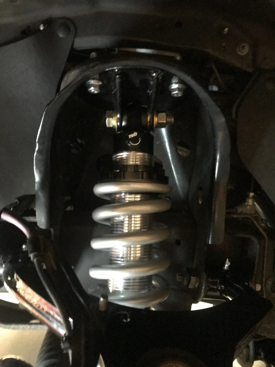

    Got everything installed and took it for a short test drive. I still need to work on the alignment, I will be doing that today.

    How much drop coil cranked all way down?
  11. Aug 5, 2018 at 7:30 PM
    #31
    arcenik
    arcenik [OP] TRD
    Aug 12, 2017
    #226644
    853
    Jon
    2015 X-Runner
    I did not test it but I would say 4 3/4" DJM + Coilovers. With them cranked all the way up it is sitting at 27 5/8" all the way down it would be 25 3/4" that is to the edge of the fender flare.

    Probably a final update unless someone has questions.
    I preloaded the springs about a 1/2" to get to the height I wanted and set the coil overs to 10 on the dial. They ride great, this is a very big improvement over the drop springs. I am really surprised how great it rides and couldn't be happier with the results.
