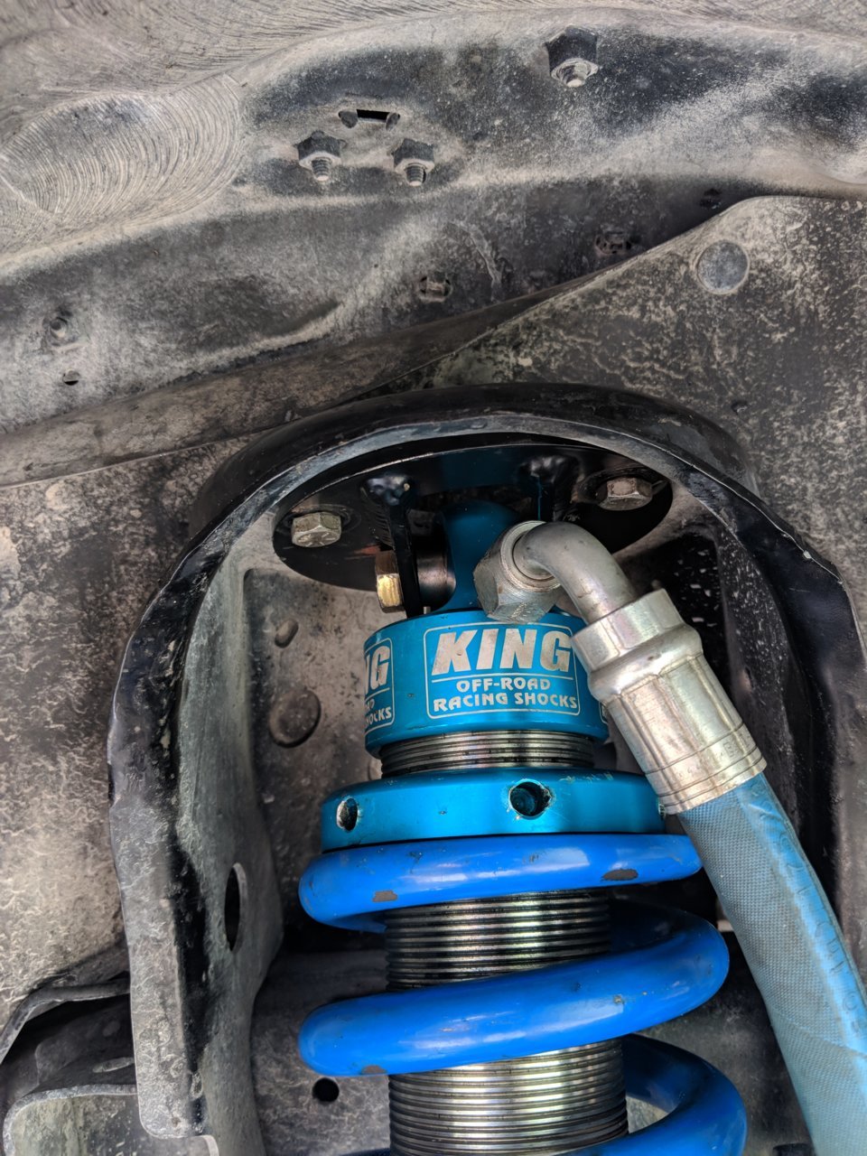

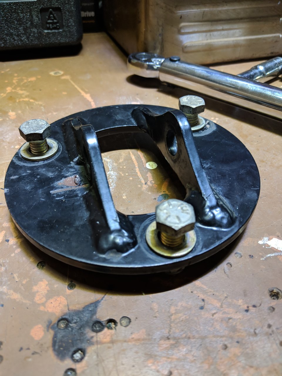

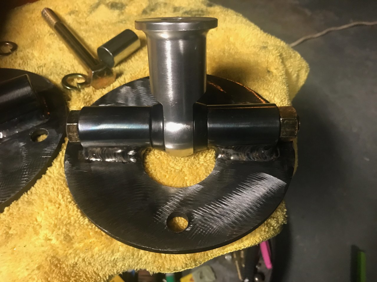

    So the mounts between 5 and 6 lug seem to be the same. Here is a mount used from a 6 lug on mine.
    #50

    The 5 lug and 6 lug 2gen are different the bolt pattern is not the same.

    I have tried, the bolt pattern on a 6 lug is 3 1/2" the 5 lug is 3 3/4" I would of used the 6 lug mount if it worked.
    The holes on that braked looked like they are drilled oversized, which would work.

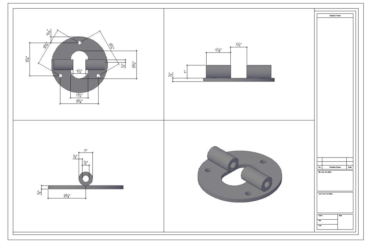

    are you ok with me showing my fabricator your drawing?

    Yeah go ahead, thats what I posted it for. let us know how much it costs if you get some made.

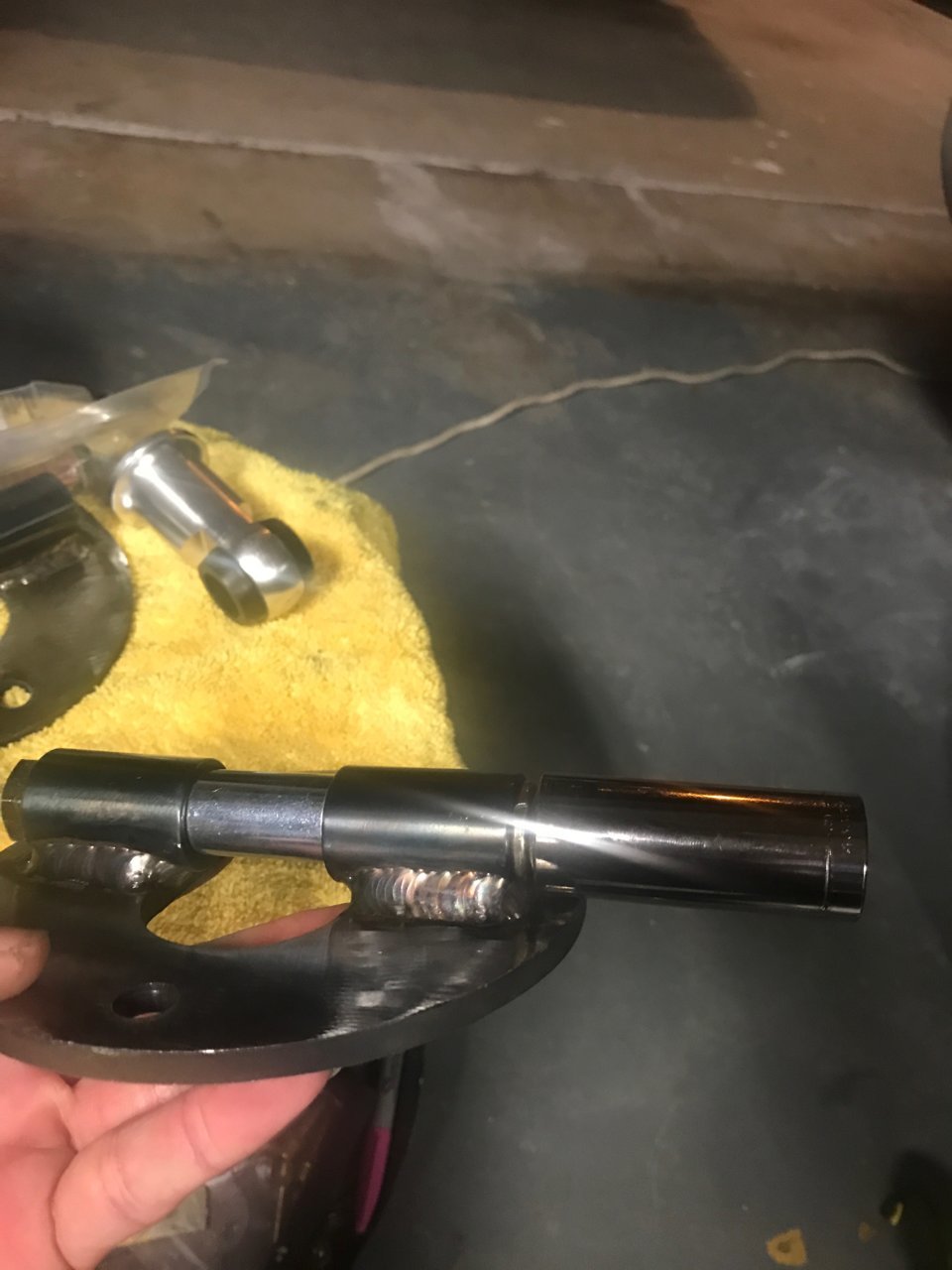

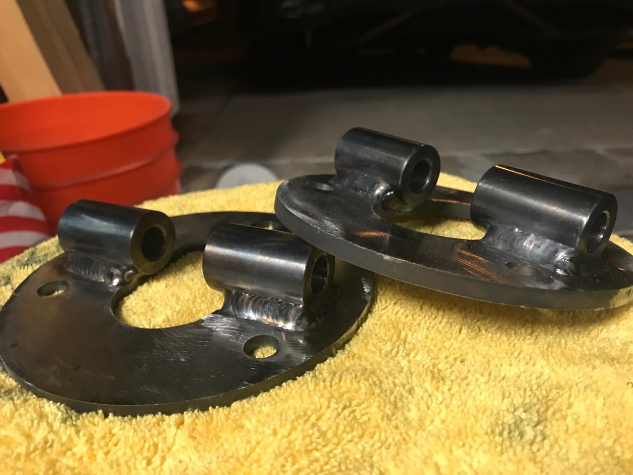

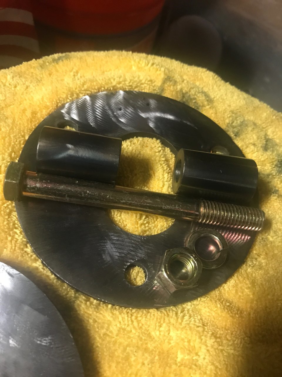

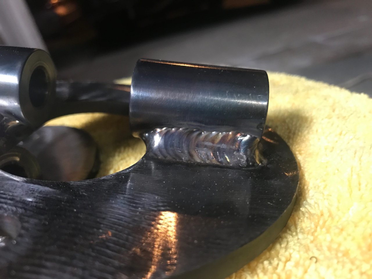

    I made a drawing for a new mount if anyone is interested in having one made. It will work better if you plan on only using the coilovers.
    I did make one modification on the drawing when fabricating
    The tube length needed to be 1 5/8" instead of 1 7/8" this would leave more space for the bolt head and nut.
