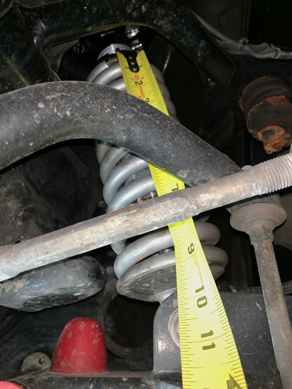

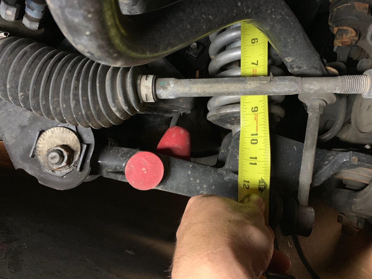

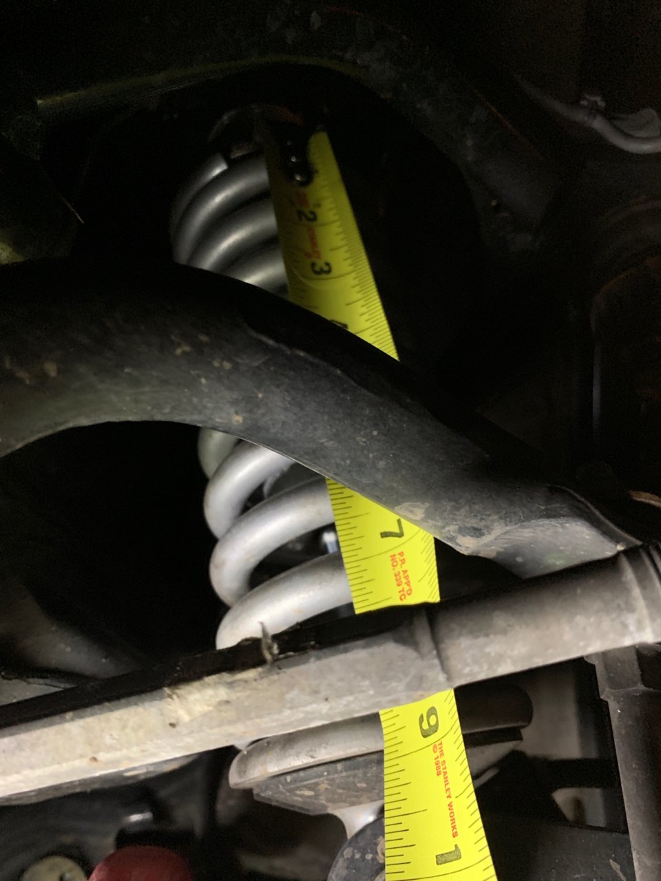

    Arcenik,
    Now that you have had the front springs installed and put some miles on the truck could you please give me a front spring measurement compressed? I'm sure it will be a pain in the ass but I need it to find the proper front spring rate. I have been researching spring rates and making calls. You should get 25 to 30% sag in a coilover spring. If you can give me your best possible measurement I would be very grateful!

  16. Oct 17, 2018 at 11:47 PM
    #76
    arcenik
    arcenik [OP] TRD
    Aug 12, 2017
    #226644
    853
    Jon
    2015 X-Runner

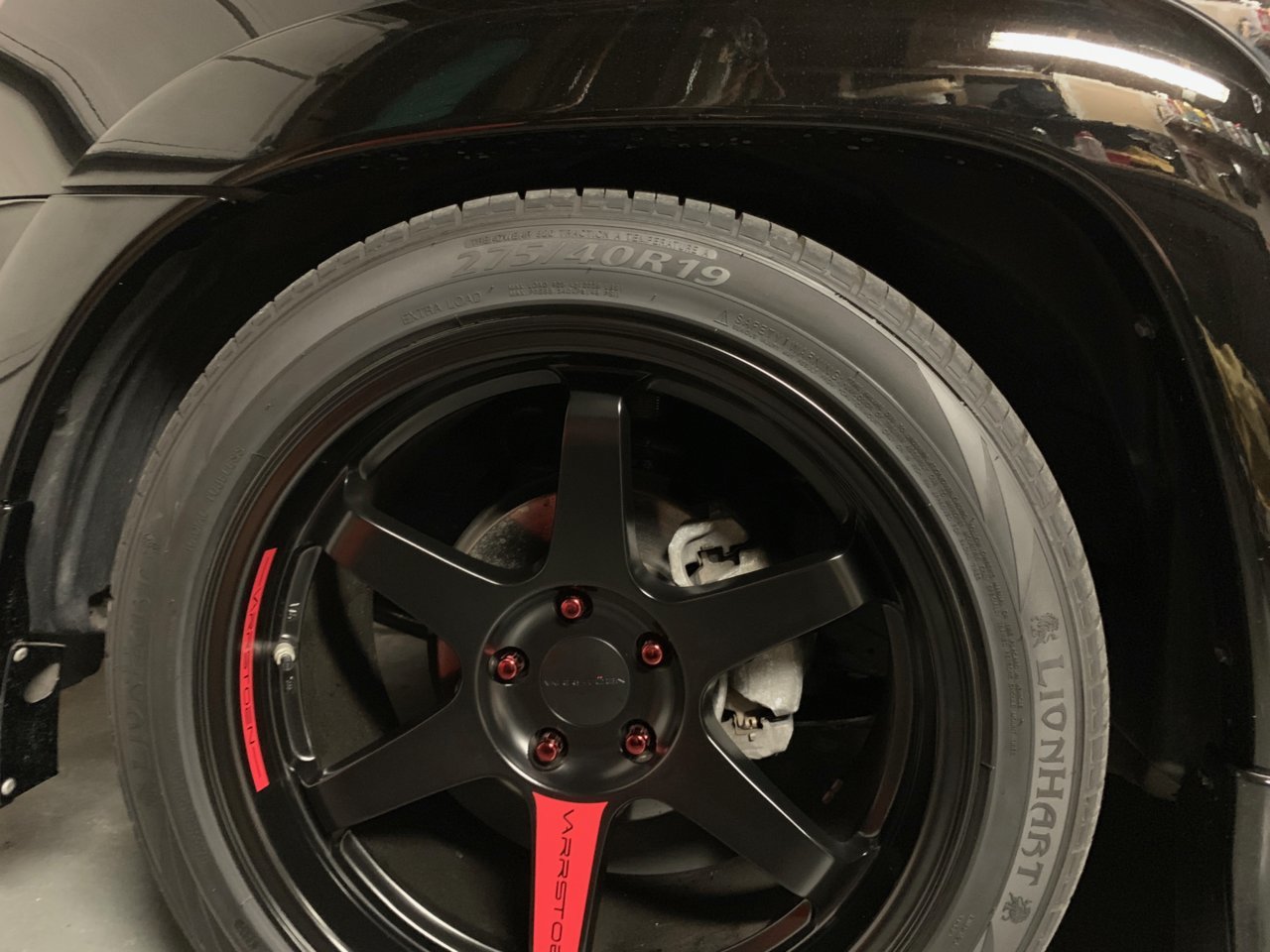

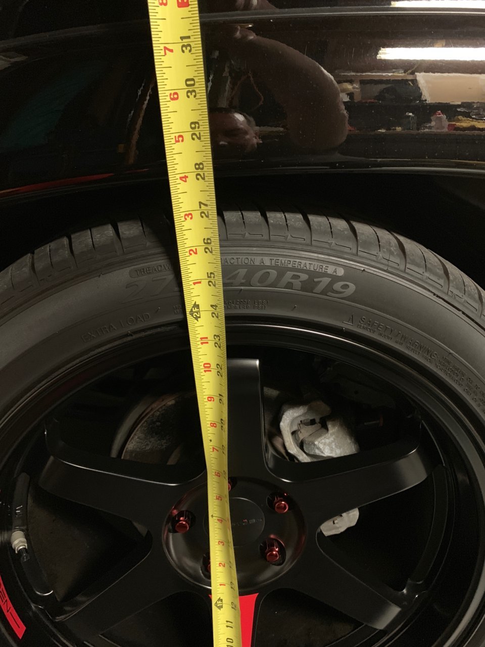

    Pics of the coilover and wheel at ride height.

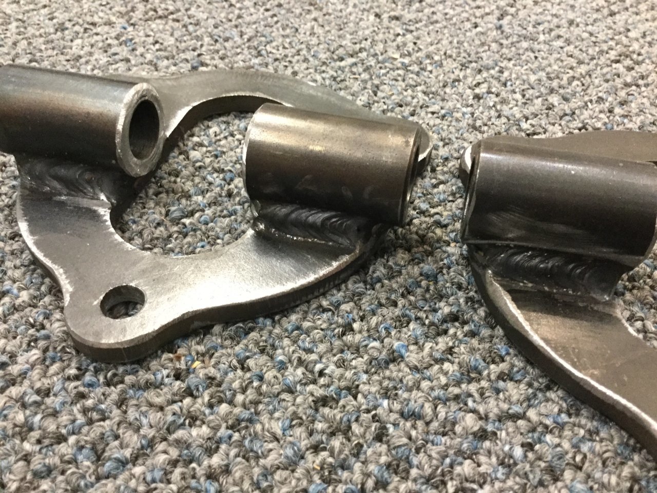

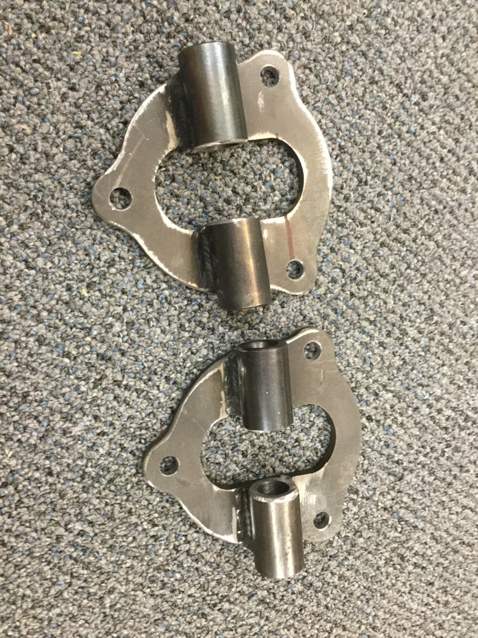

    Let see some photos of the upper mounts, would like to see how he built them.
    Also I got some viking replacement front shocks coming in also, this should be a direct replacement for current QA1's.

    Sweet‼️
    I think the last time you told me you only got about 2" of sag with the 550# springs.
    I haven't had time to pickup the front mounts at the Powder Coaters but, they are just like XII less the machining for the 3 nuts and bolts. He also machine out the large thru bolt to 5/8" so I can now use SS hardware just got to make sure I use anti-seize so they don't weld together. Don't want rust when I pull the wheels off to clean the undercarriage for show and shines after the URD super charger is installed.
