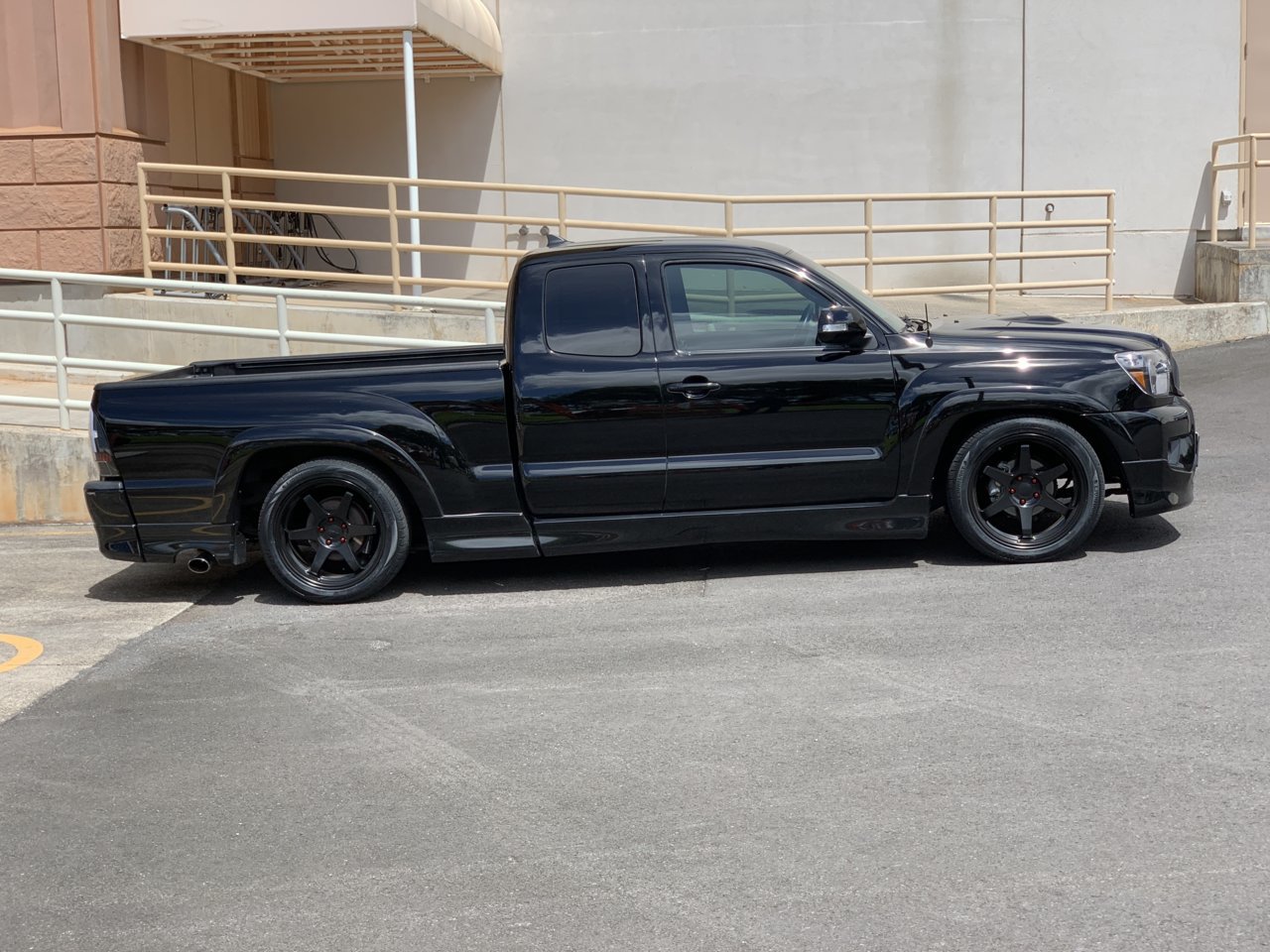

    This is the only one I got.

    Hard to say how low drop pic what setup
  3. Oct 19, 2018 at 6:04 PM
    #83
    arcenik
    arcenik [OP] TRD
    Aug 12, 2017
    #226644
    853
    Jon
    2015 X-Runner
    About 2.5" front and 2.25" rear
    Front
    DJM upper and lower arms
    Slick and dirty upper coilover top plate
    QA1 coilovers
    Eibach 12" 550 PPI springs
    Rear
    2.25" drop blocks
    Viking double adjustable shocks
    air lift helper bags
