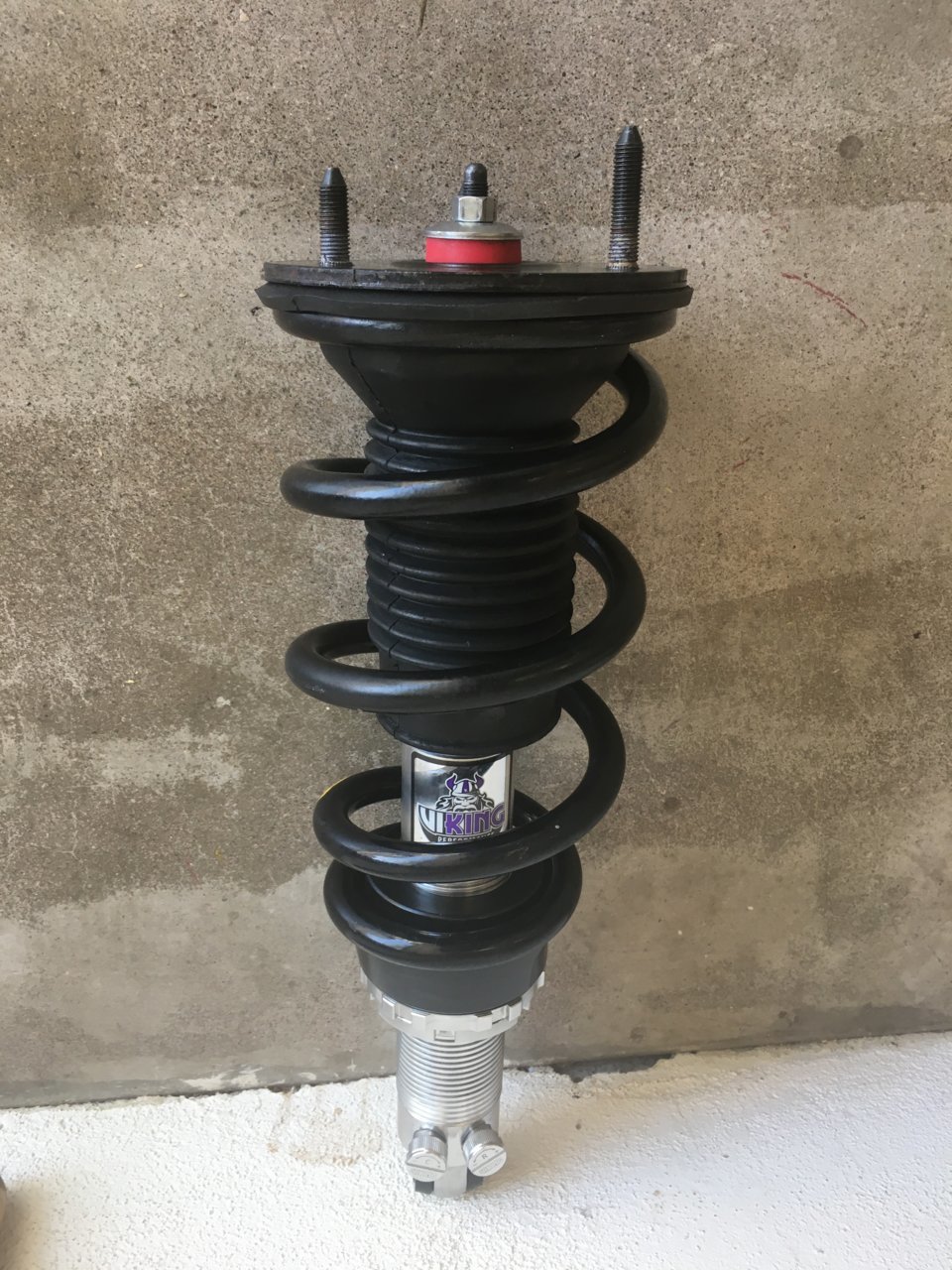

    Still running the front viking setup. I switched to ridetech rear shocks. Im looking into getting ridetech 3 way adjustable front coilovers. The mono tube rear shocks although single adjustable ride better than the vikings.

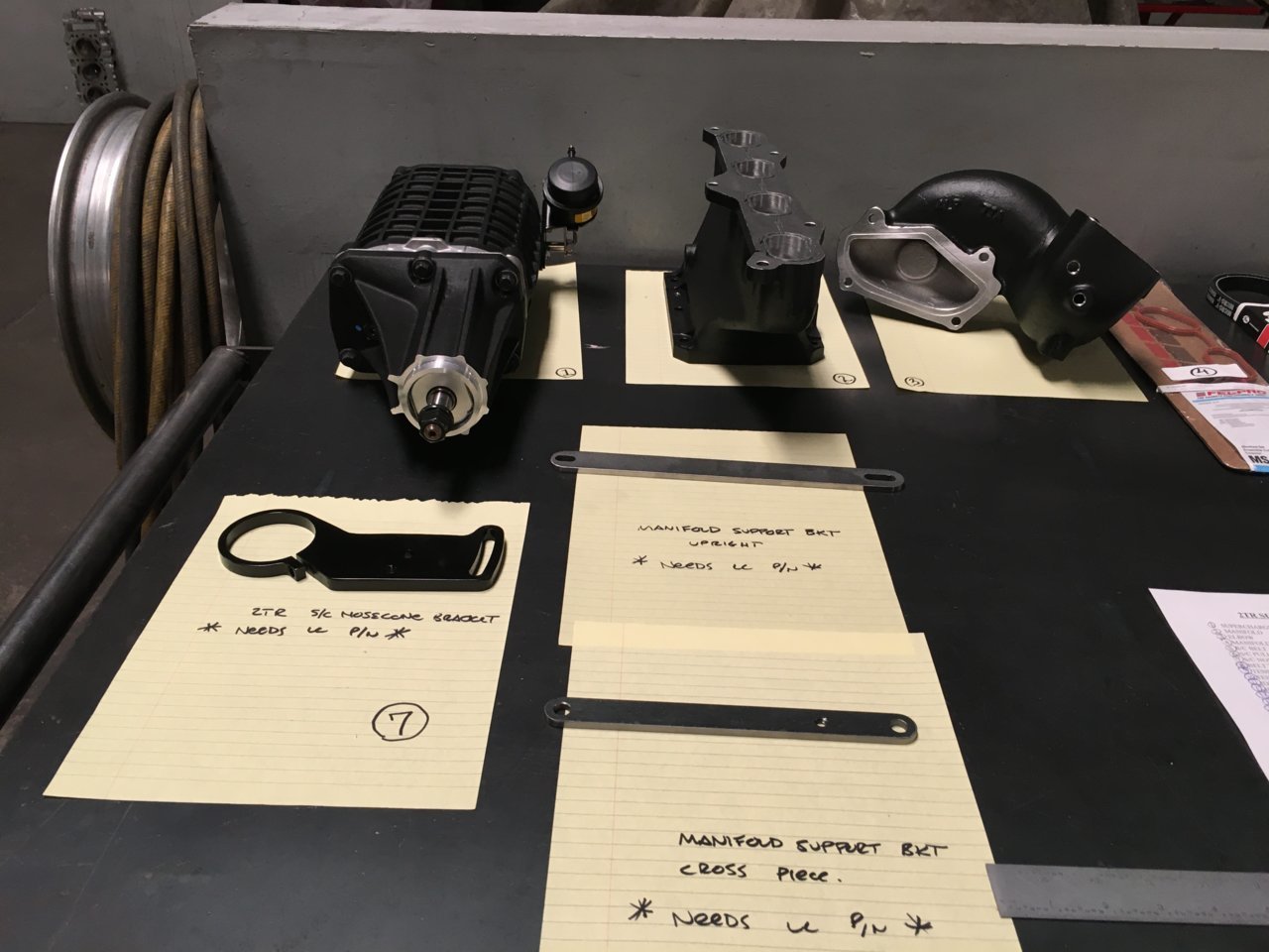

    These chunks of aluminum have been installed and now it’s up to the tuner. He’s trying to get it up to 9 lbs on crappy 91.

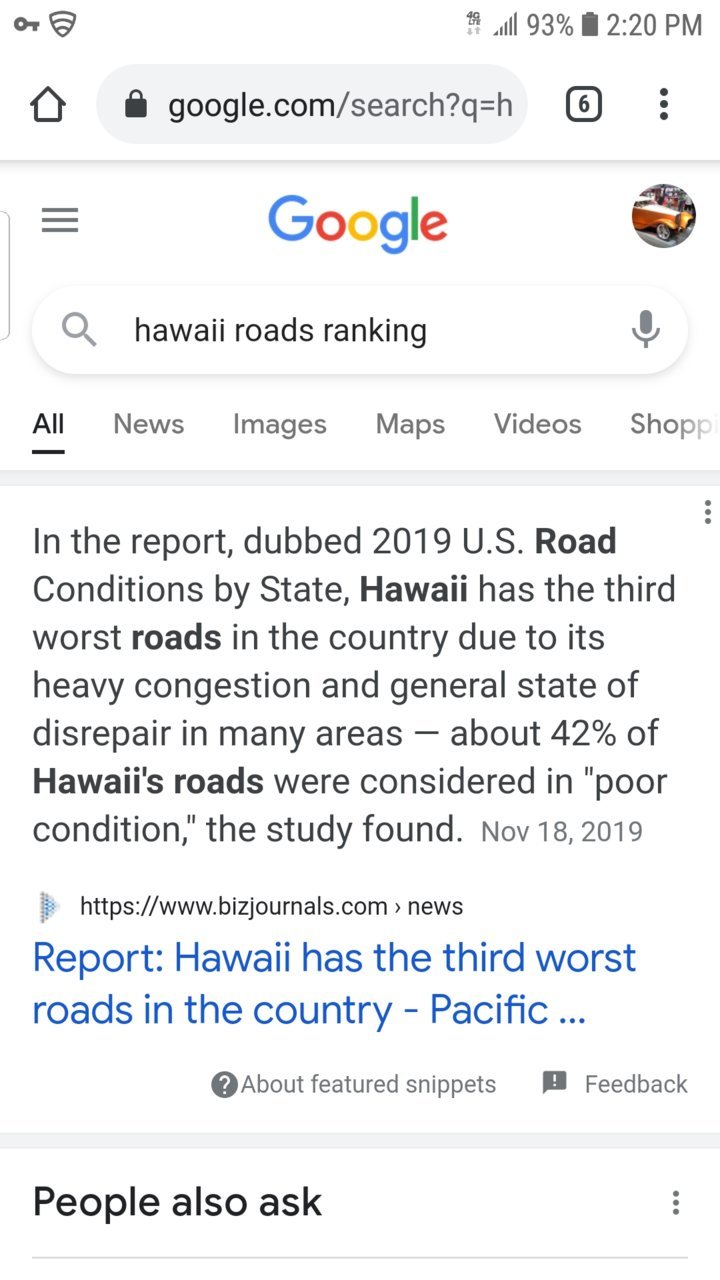

    Hawaii roads sweet hell no

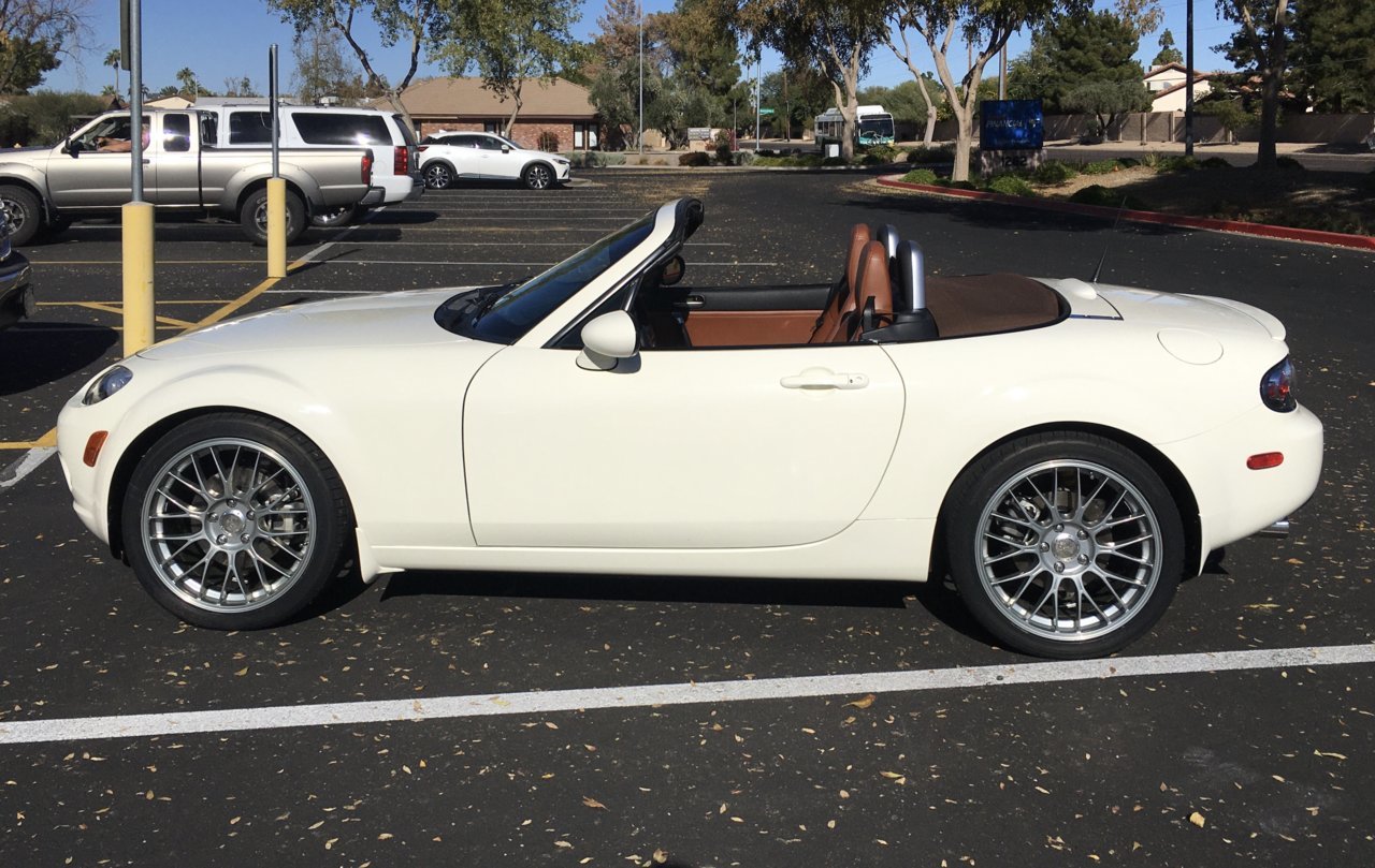

    Sorry but there’s no way with 2” of suspension travel you are going to get an Ok ride on the street. Well at least as far as I’m concerned. My 07 Mazda MX-5 had upgraded suspension with upgraded springs, double adjustable Koni’s (Koni’s are approx $150 each then labor to convert the shock to double adjustable was approx $350 each) then add Mazda RX-8 R3 factory swaybar’s with fresh 235 UTQG of 200 rubber on 8” wide wheels. It could almost pull 1.2 G’s on the skid pad & road like a Cadillac compared to the Tacoma. The day I sold her to help pay for my Tacoma project.

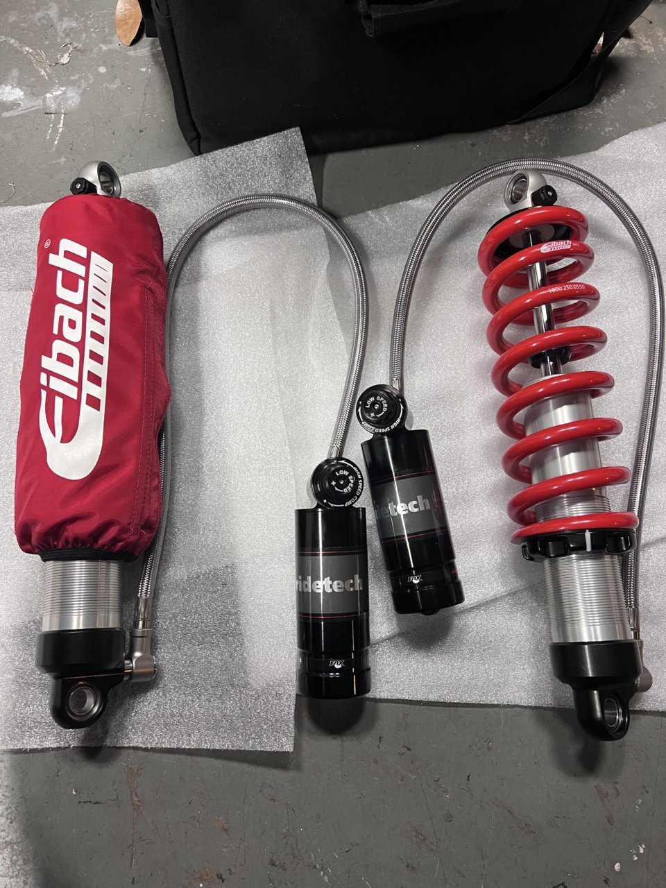

    Finally picked up some triple adjustables for the front.
    These should bolt up to my slick and dirty top plates.
    Just need to find time to install.
