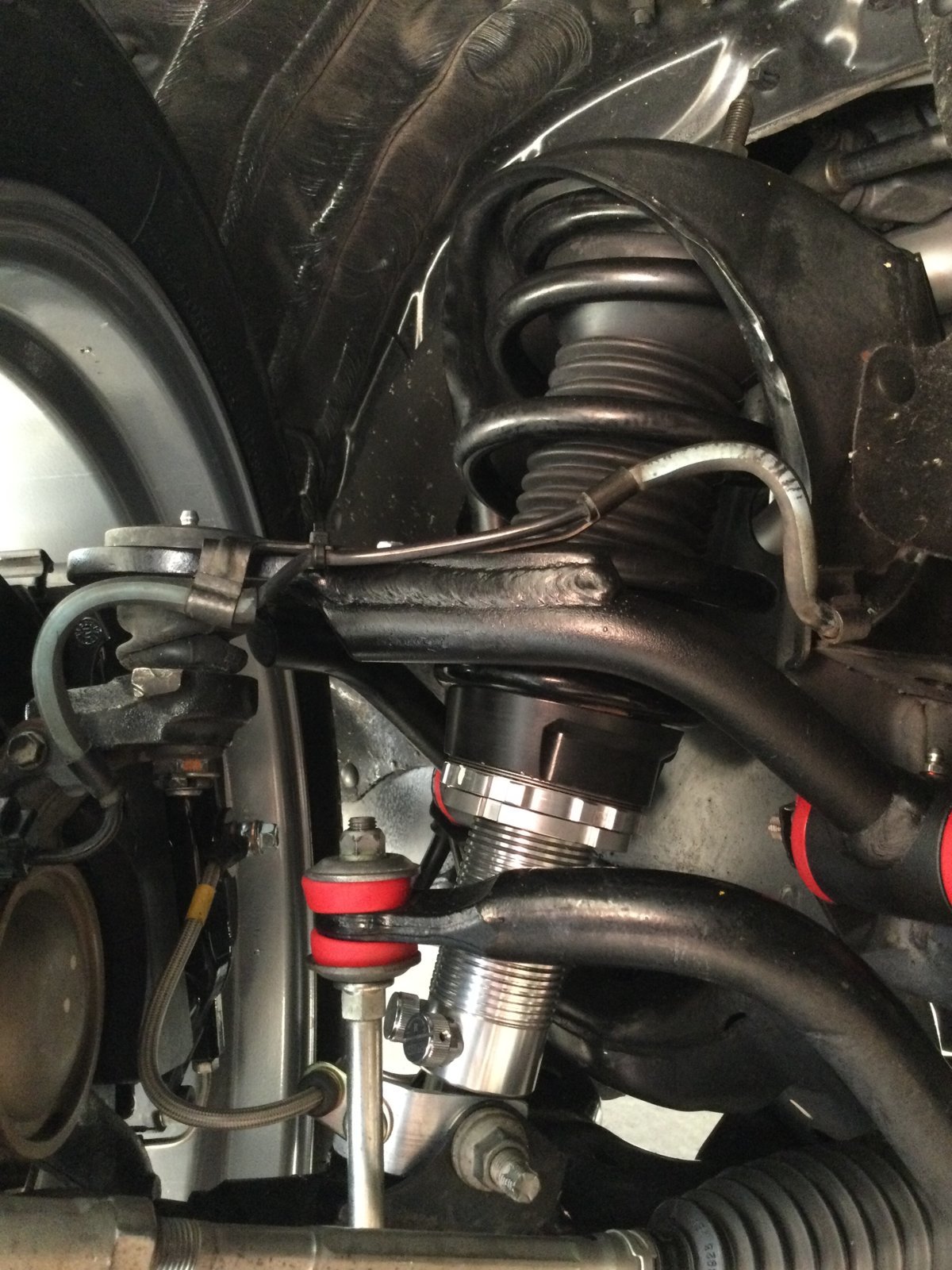

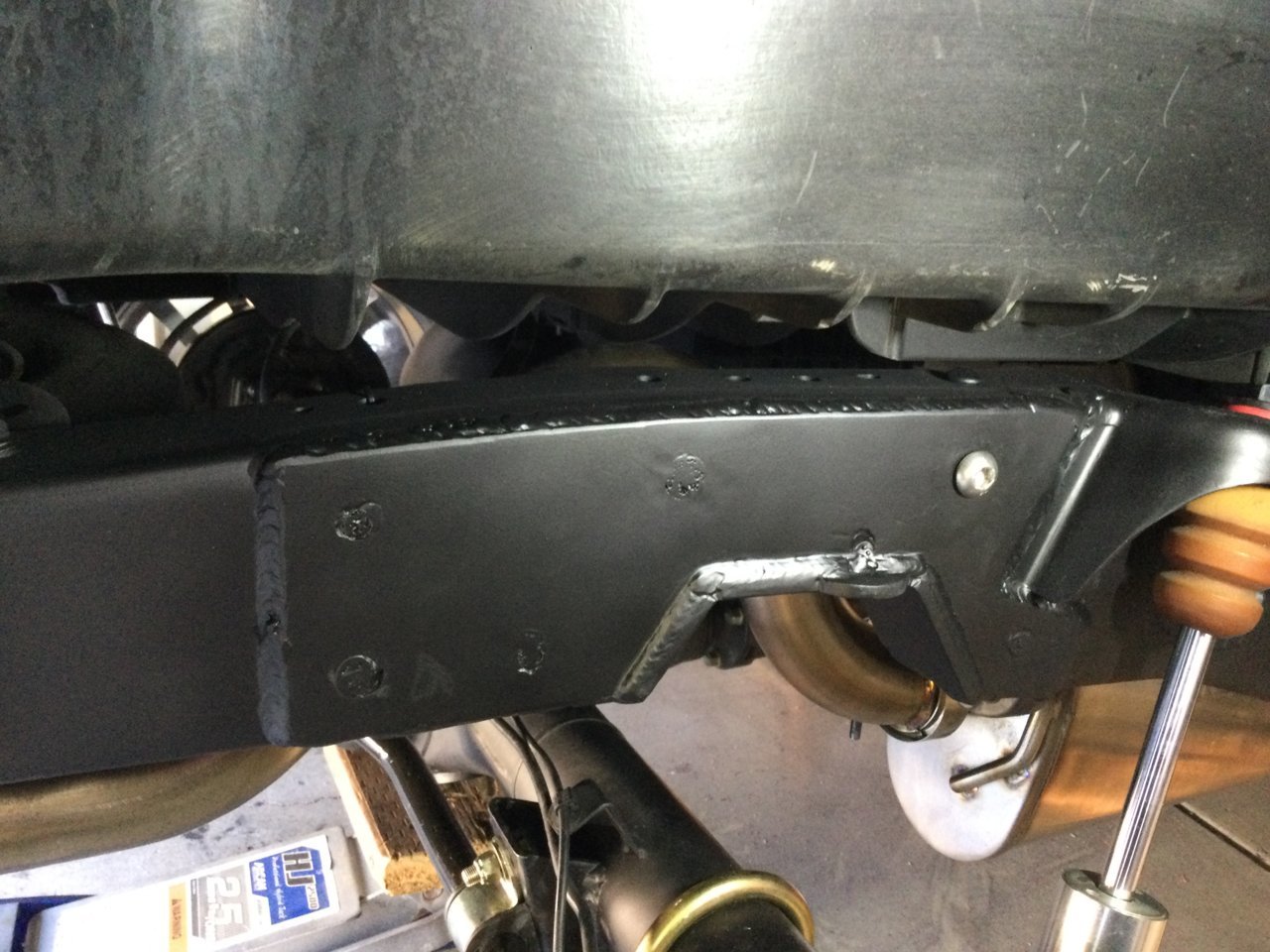

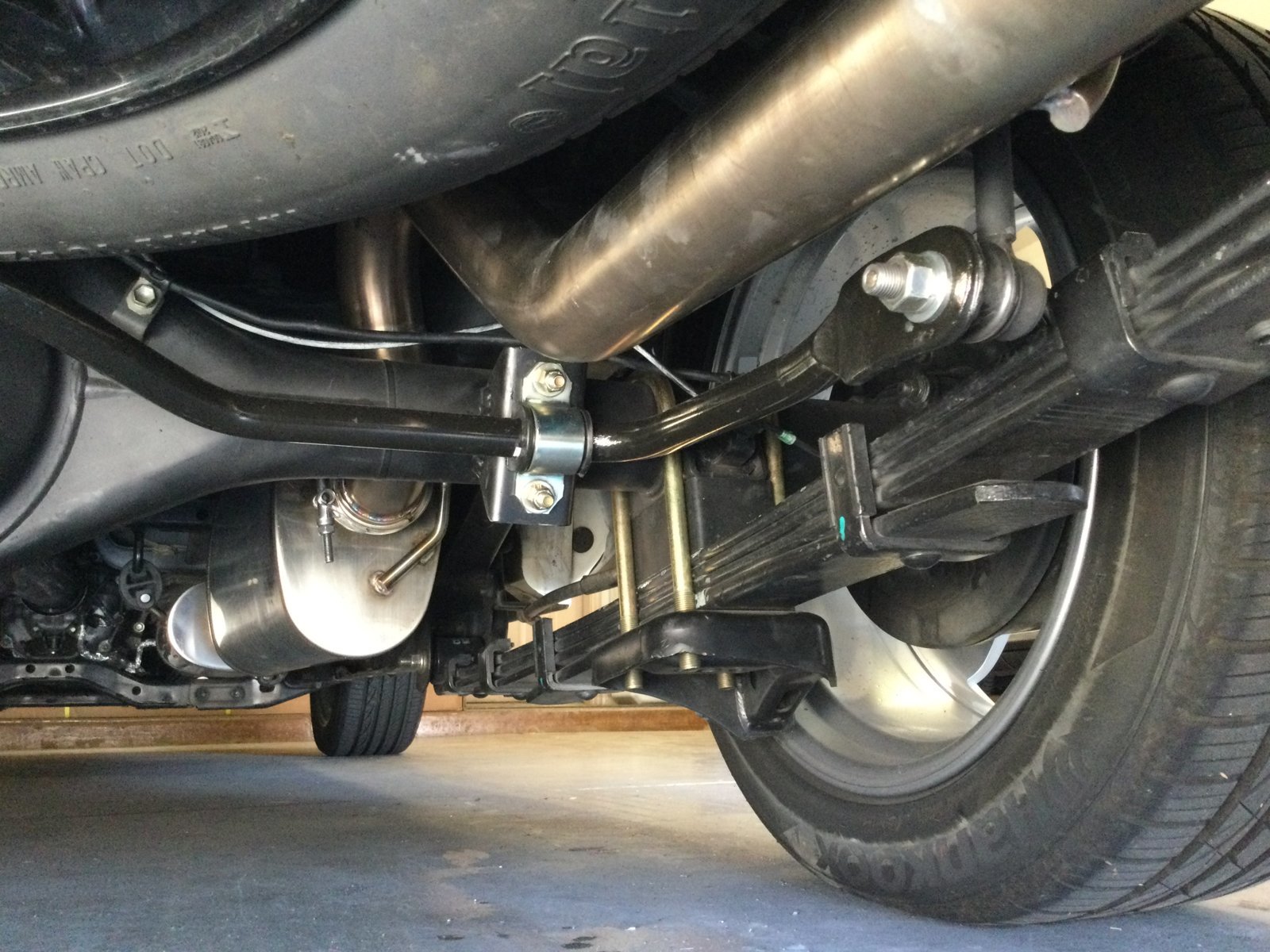

    Finally got the rear finished…

    so I'm not sure if I just missed the info or not, but will the qa1 coilovers without the djm control arms just leave it around stock height?
  9. Dec 26, 2023 at 1:49 PM
    #169
    hayrider2.0
    hayrider2.0 Over the hill and going down fast!
    Jun 30, 2023
    #427944
    440
    Hey You
    2 Centimeters from Hell 200 Miles from Water
    05 & 07 White Reg. Cabs w/ sticks
    05 Magnuson 07 LS Swapped
    You can drop approximately 1.5” without the arms. Any lower the alignment can’t stay in specs. Plus this will vary from truck to truck. Toyota is not making watches but body on frame truck. In other words some can about 1 1/4” and some state they can get 2” but I personally think they are Bull Shitting Or can’t read a tape measure!!

    I highly recommend the upper control arms and having DJM press in the ball joints!!
    Why? Sadly there Quality control is not the best! I took a pair I purchased to a Toyota specialist to have ball joints pressed in and the shop went through two ball joints trying to press them in. The technician showed me the hole was not completely round‼️
    I purchased Moog ball joints from Amazon and had Amazon deliver to DJM. Kathy is very nice to work with just ask her nicely! I’m dropped about 2 1/4” and I’m just about in the middle of the concentric adjustment washer. I could go lower but I’m running a 235/50-19” tire on the front and if I bottom out the front suspension it will knock out the front fender well liner even with the bump stop set. I got caught up in the middle of a bunch of Tractor Trailer trucks going across NM in high winds and being trapped in I didn’t see a pothole that ripped the steering wheel from both my hands. This almost completely ripped out the fender liner and I can’t believe it didn’t bend the wheel or blow out the tire. Truthfully I believe it only ripped out the plastic clips! I’m very glad I’m running a 28.25” tall front tire. The rears are 28.65” tall with a 3.73 rear gear w/ the Magnuson supercharger. With the LS Swap w/ 3x the torque & double the HP I went back to the 3.31 gear, a TrueTrec w/ the Tremec TKX trans.

    How did the notch workout. Did it help eliminate the bottoming out? What size blocks are you running?
    I did the 4x4 leaf's like you suggested and wow what a difference. I am currently on 4x4 leafs and 1"1/2 block and low pro bump stops.
    I occasionally bottom out from time to time. I would like to notch the truck and lower the rear another inch. But I am so hesitate on cutting the frame.

    No problem!
    The notch makes for an absolutely beautiful ride. 6 lug springs and 2” blocks.
    HIGHLY RECOMMEND welding in the DJM notch and it’s worth every penny to hire a professional welder! There are many here on the site!! Just ask in your local area For Sale or Trade section or the BS section.

    I'm running a very similar setup, and I can concur with hayrider. The notch is a must if you want to go lower. Absolutely have it welded in, the bolts alone aren't sufficient for the stresses the frame deals with.

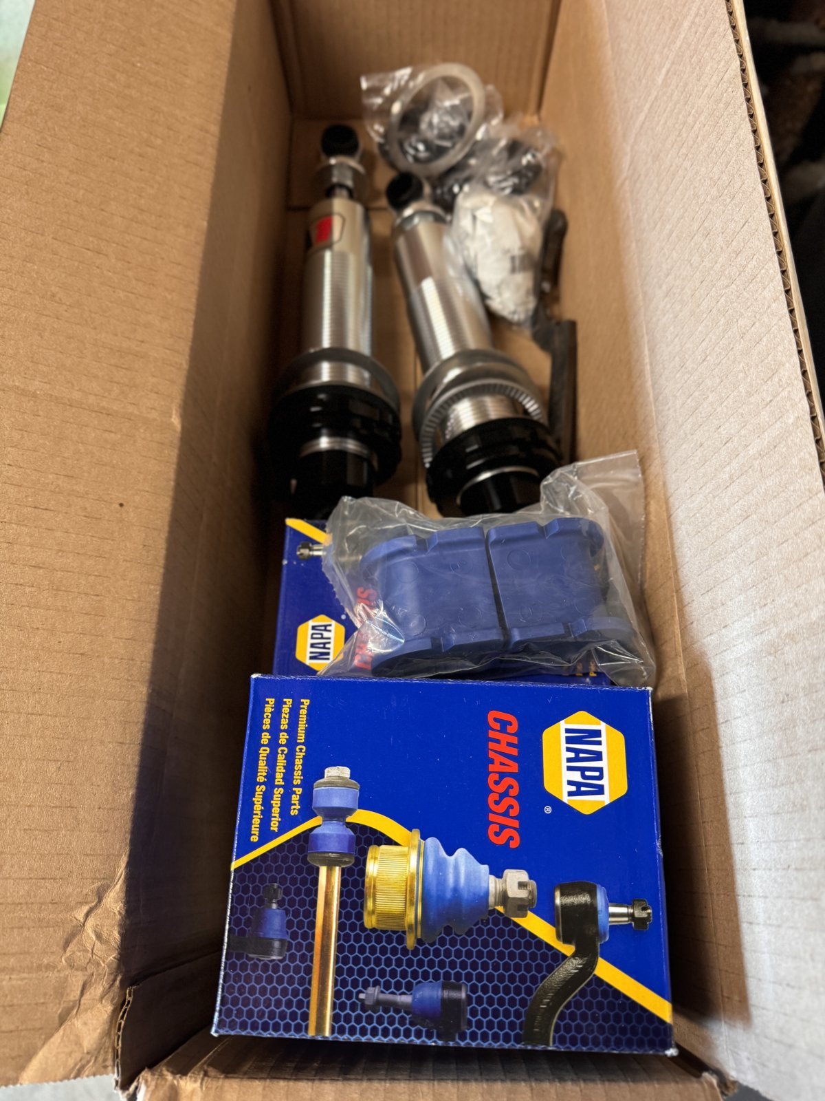

    Gelo
    Getting to refresh my front end djm drop.
    waiting on Eibach springs then going to figure out ball joint install.
    got 8 years 140,000 on my first set up. Blew a coilover, ball joints making noise now and most boots torn

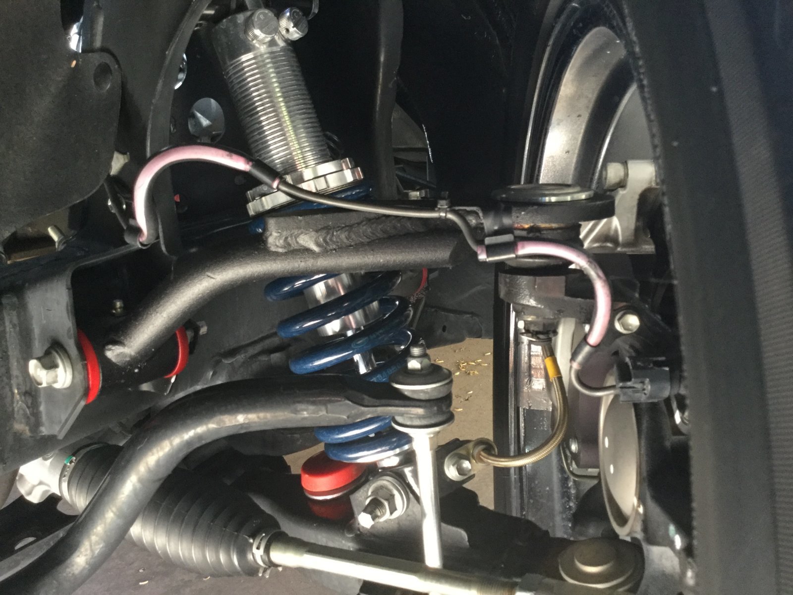

    When I first installed / truck . 2015 IMG_5425.jpg IMG_0787.jpg IMG_5977.jpg

    What spring rate are you looking for? I have 3 or 4 sets of 2.5” x 12” new springs all under 500#.
    I have a set of 550# Hypertech coil-over springs. I’ve been saving for @BananaMan when he decides to change out his half frozen and over sprung coil-overs. Come on BananaMan with a set of proper spring rate coil-overs and a X-runner rear sway we can get that reg. cab 5 lug to rip the Auto Cross course, with the fat meats you’re are running for rubber. :boink:
    What BananaMan needs below.
    The springs below are 10” springs, the shocks called for 10” or 12”

    im going 550lb again. I could reuse my other springs but bought some new ones.

    Some of the BEST coil-over springs are the two below. And 550# is pretty firm in an Access cab with a 2TR. I had 525# and I think the OE springs on the Tundra Racing coil bind (increased spring rate) adapters ride far superior! Plus I was thinking adding the 6 lug leaf springs (stiffer than the 5 lug springs) w/ the X-runner rear sway would make the regular cab over steer but it’s pretty neutral w/ just a touch of understeer.

    mine were great . Don’t think 25lb would be much difference . Keeping what has worked for me.
    now going to redo the entire process I did 8 years ago plus some extra parts . It’s needed
