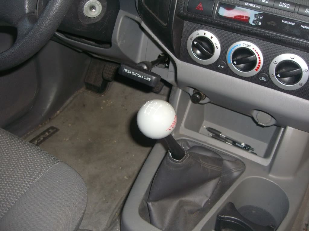

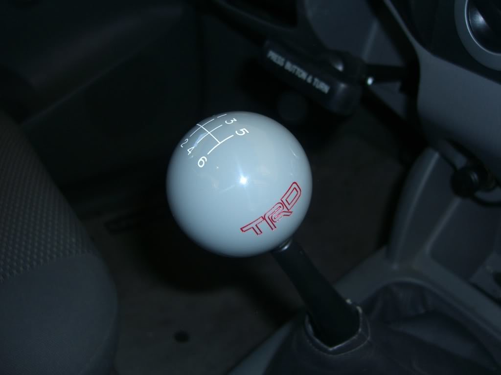

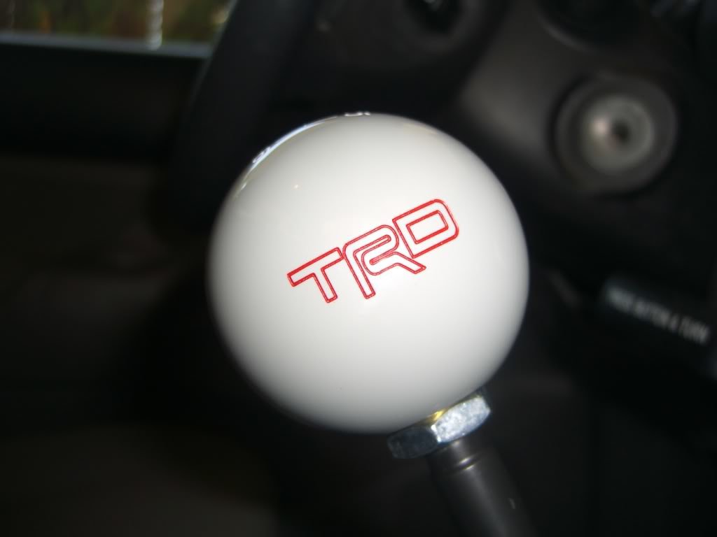

    My Taco got a X-mas present! My girl got me TRD grey ball shift knob. The knob has 6 speed pattern for V6 Taco/FJ, she couldn't find 5 speed TRD knob for my Taco. The knob fits perfect and I am very happy with it, the knob feels really good in my hand!
    Here are some pictures of it;

    Did you notice any horsepower gains or increased fuel mileage with the TRD shift knob? Looks nice:cool:

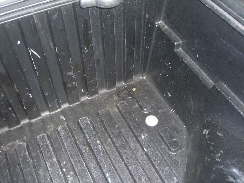

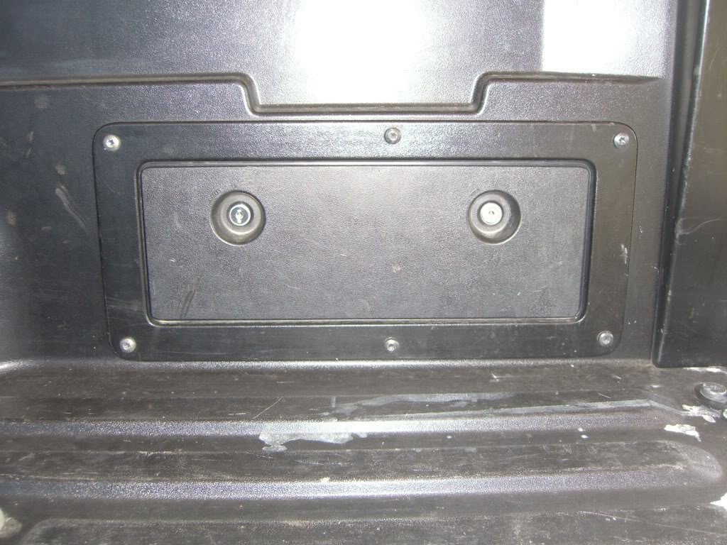

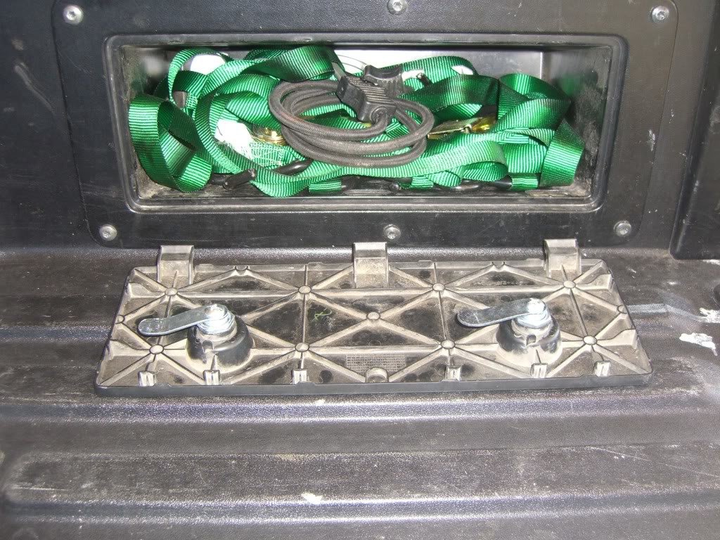

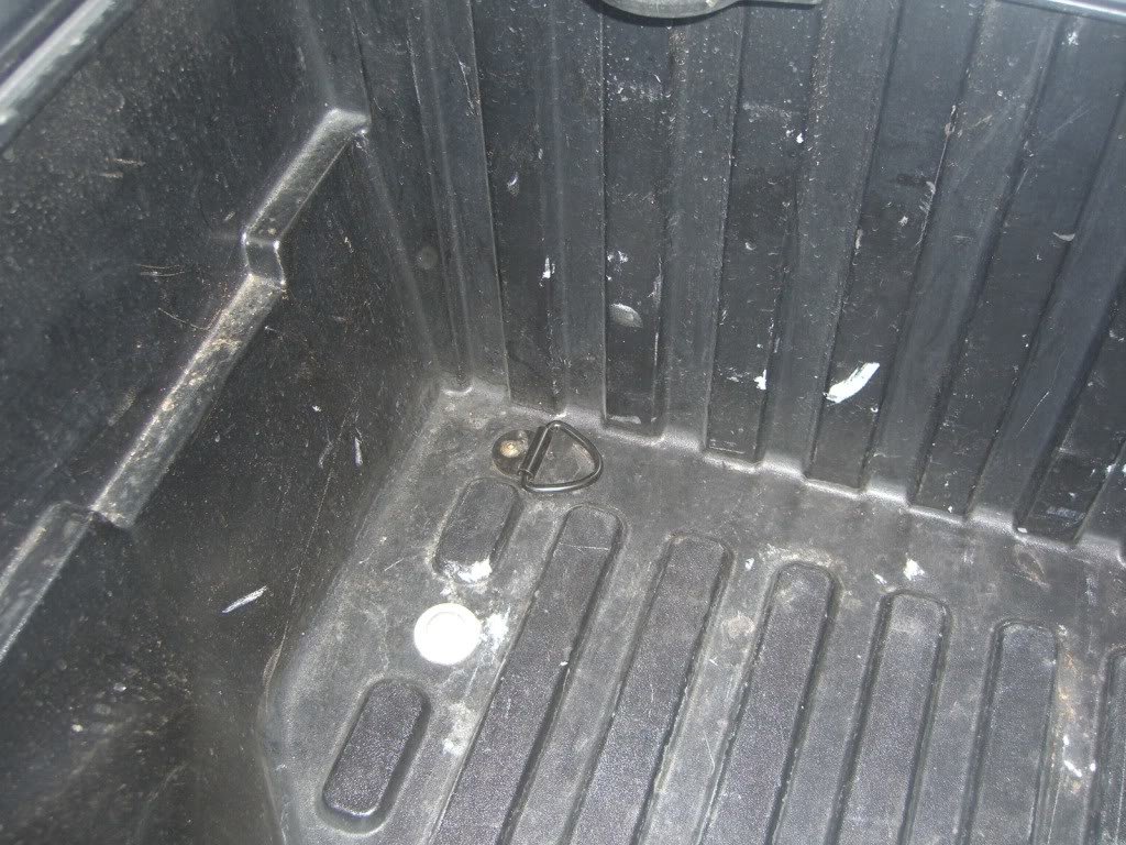

    Added few more budget mods.
    D-rings;
    Lockable bed storage compartment. Both locks are keyed on the same key. Adds some level of protection for my ratcheting tie downs.

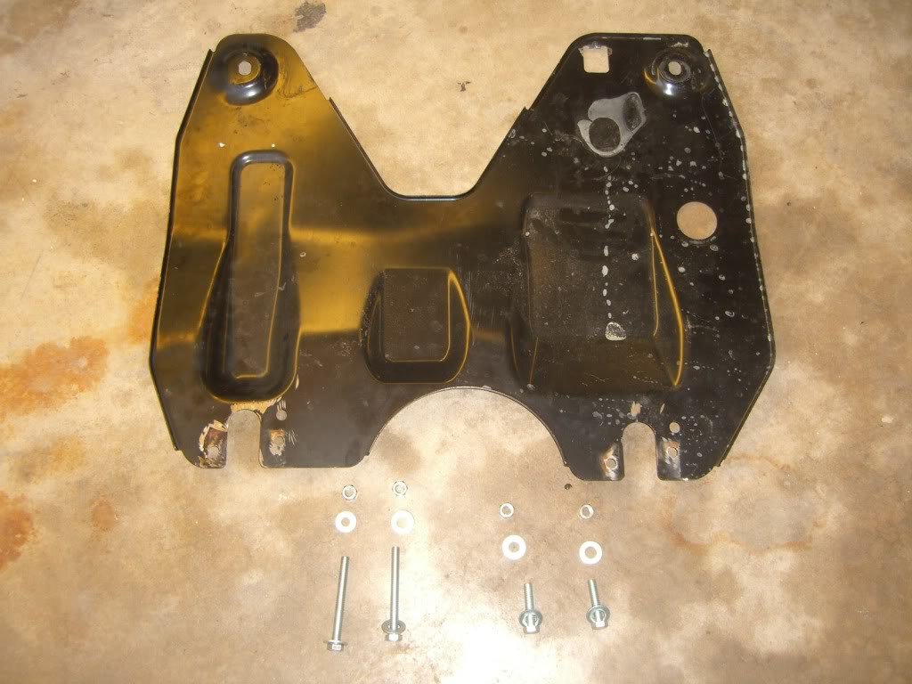

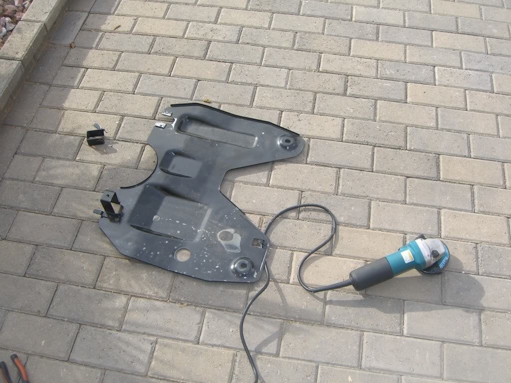

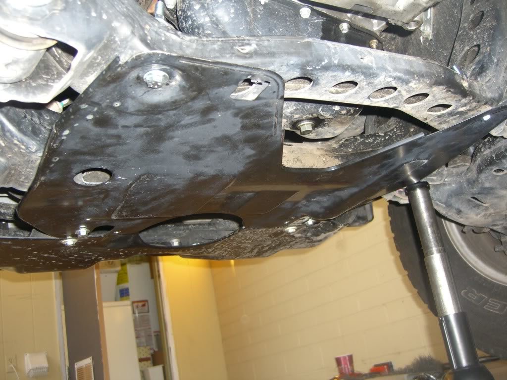

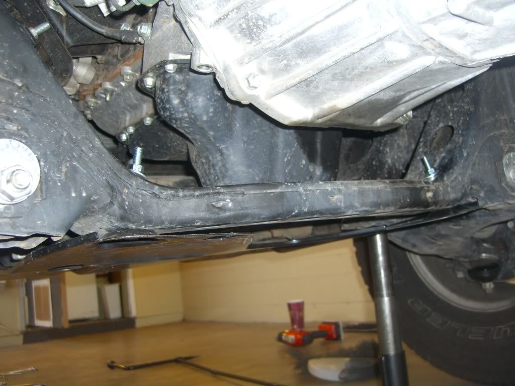

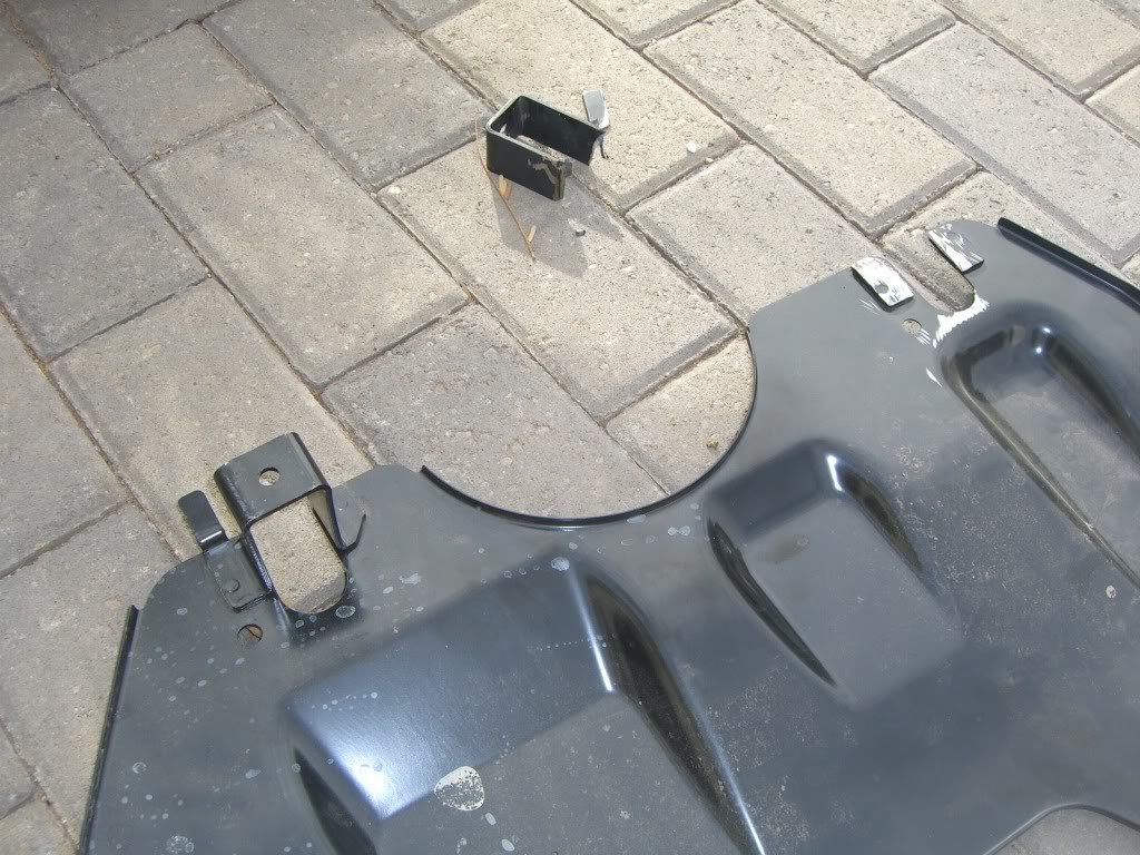

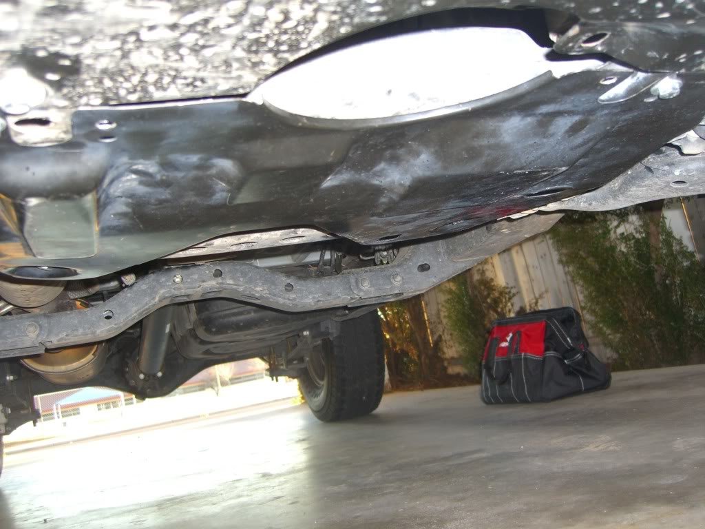

    Finally finished installing the OEM skid plate. Now this is not so easy job. First off the front mounts on the skid have to be ground off/drilled out;
    Skid ready to go on, pictured with mounting hardware 8.8grade HEX bolts from ACE Hardware, same as i used for the Front OEM skid.
    Skid is ON!
    Rear mounts. I used the stock location on the skid and drilled the holes in an angle...
    Now this is not an awesome thick steel aftermarket skid plate, but those cost in neighborhood of $200. I have gotten both skids on for less than $40 in drill bits and bolts. Both skids have been donated by Steve (OH-MAN here on TW). For that cost you can't beat it, these skids in the end should protect better than nothing. The bad part is that the engine skid will have to be removed every time I am doing an oil filter change since it covers the oil filter... However the engine skid can be removed in less than two minutes with 13mm wrench and 13mm ratchet...
