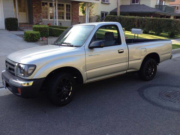

    This is actually the for sale ad. Not quite my taste in styling, and Id have never chosen this stuff on my own, but it is growing on me. Want to throw 2-3" drop blocks in the back and toss a tonneau cover on. Tint is already done.

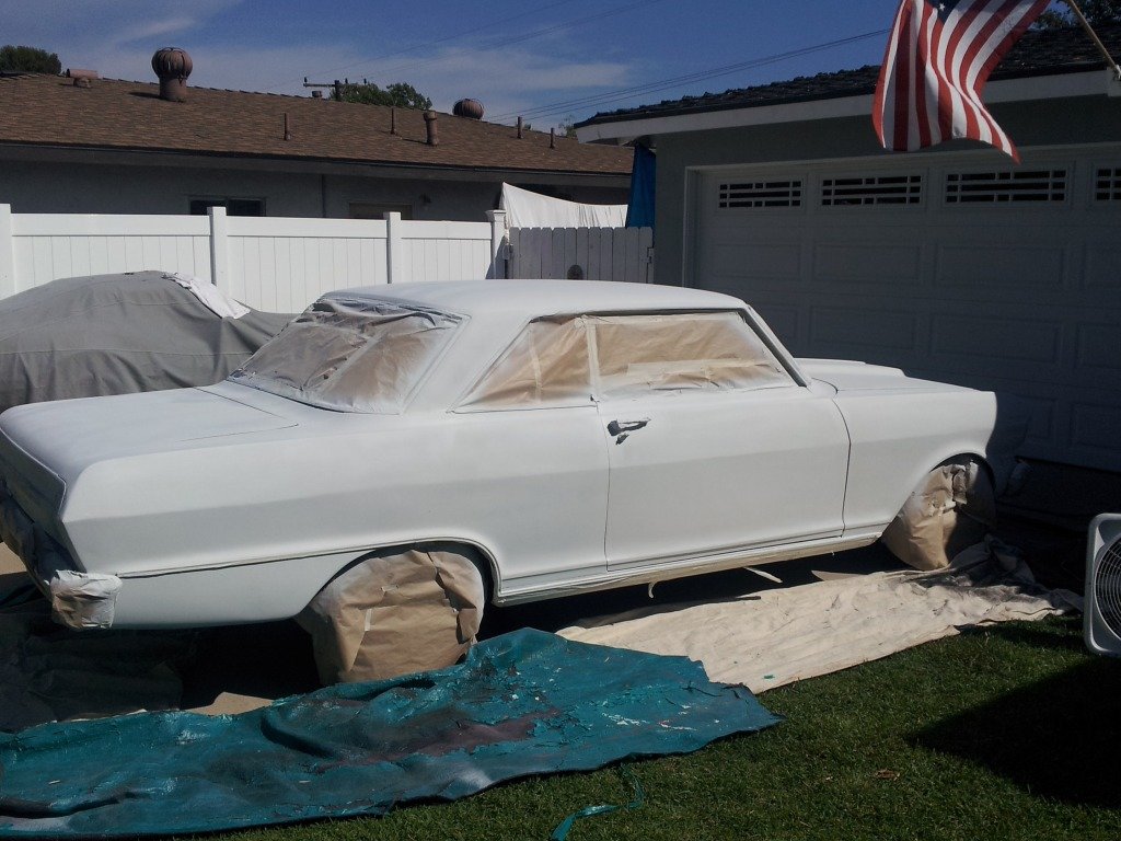

    I really like that! Donno if anybodys still following this one but Ive been preoccupied with my Nova for the last few months:D
    Anyway yea still no tach but this looks like just about the best place probably to put it. Thanks grove, have you done it yet? I think thisll be the next thing I do to the taco.
    Heres my lil deuce at the reckneck bodyshop as our neighbor called it lol.
