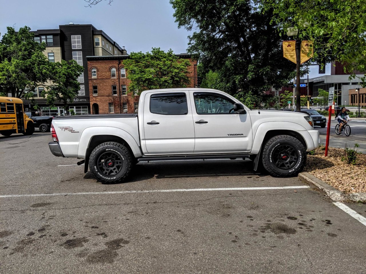

    Quick update: Thanks again. Loving the new kicks!
    Mike714, DCTiller and Regnar[QUOTED] like this.

    Looks clean! Love the white letters
