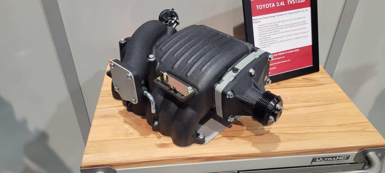

    Just going through older posts for a potential new build. Thinking about rebuilding an older 4runner with forged internals and the newer TVS1320 supercharger when it comes out later this year.

    What in the almighty is THAT! Where/when did they show that? Im surprised magnuson is giving us a new supercharger for the 5vz!?

    They showed about 3 or 4 new superchargers for Toyota trucks at SEMA this year!
    Supposedly the mold for the MP62 wore down too much to continue to use, so they redesigned it to a TVS!

    TVS should be able to help with the heat soak issues and with meth push more boost. But we shall see

    Does the MP62 come with an intercooler?

    No intercooler on the old unit or the new TVS design. The advantage to the TVS is it can spin at a much lower speed. The lower speed should help with temps
    (intercooled on the photo there was admitted to be an oppsy)

    AH! Too bad I was assuming the new one did

    Looks like the pulley will be easier to swap on the new one

    Darn, the intercooler was what I thought was so amazing. Will be interesting to see what these will do out in the real world though never the less.
